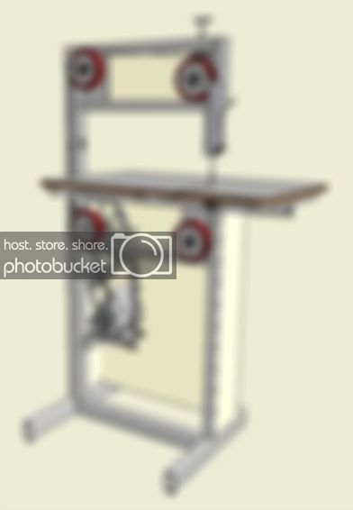

WAY Too Clean to be a bandsaw! :biggrin:
