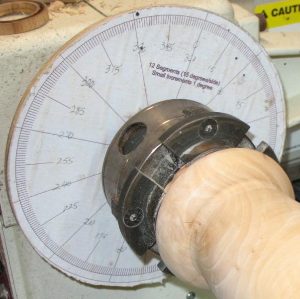

I have indexing system on my Jet lathe, could not remember how to determine degrees, so took 5 minutes to glue and cut wheel shown in photograph. Would have taken same amount of time to go in house and check owner's manual.
Yes, had to read owner's manual to put it all together. Homemade wheel and existing index system easier to use now. No, do not use indexing on many projects.

I use the Smith Art free templates for segment and stave guides and to make an index wheel. Thought folks might like free program for cutting cogs in a wheel too. Got the idea of making a index wheel with cogged teeth watching this video. Using Smith Art templates or Wandel's software templates pretty easy op. Either style template saves time because don't have mark out drill or saw cuts outs.
http://www.youtube.com/watch?v=oNuhr3htNWs&feature=related
http://www.smithart.us/download.htm
I know tapping out the center might not work on every lathe although not impossible to do. The spindle taps available from Packard Woodworks and other vendors work in wood and plastic. Spindle taps for metal much more expensive.
Still have to make a base to lock wheel in place.
