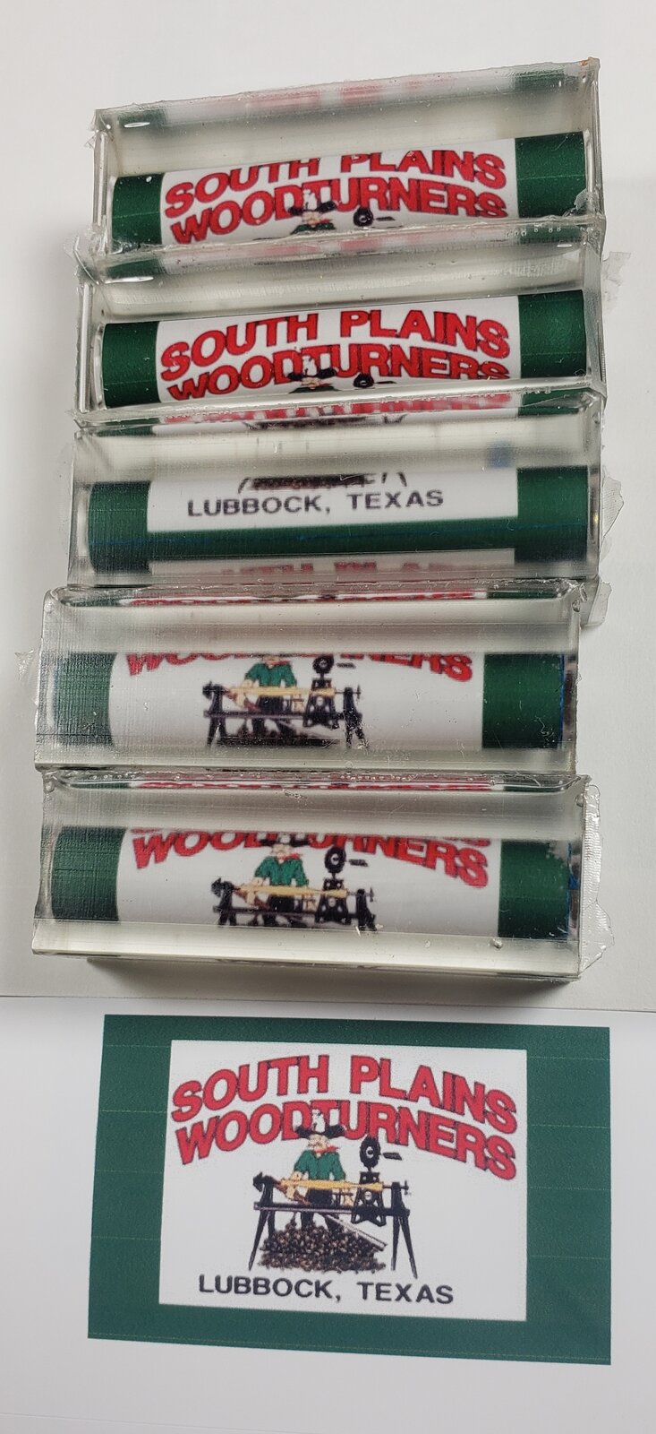

I'm a casual label caster. Looking to sometimes speed up the curing time sometimes . Toaster ovens don't maintain a close enough temp to 150. Does anyone know if this would work? The rotator obviously could be removed. The "laboratory ovens" I've seen are way more than what I need. And too big and expensive.

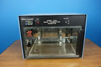

What I want is something other than a full blown lab oven that will keep a reasonably accurate 150 degree temp for 16 hours safely.
Is anyone familiar with a "Hybridization oven" to know that it will do this ?

Almost all of my castings are TBL pens, sent to LEOs as a result of a news article or Facebook posting on department pages that I follow.
Sometimes for a job well done, especially in the current climate.
Unfortunately sometimes for bad things that happen all too frequently.
I just learned of an officer that was hospitalized as the result of a suicide attempt.
I don't have any TBL blanks ready to go. Usually I do.
I would have liked to have cast it today, turn it tomorrow, get it in the mail on the following day.

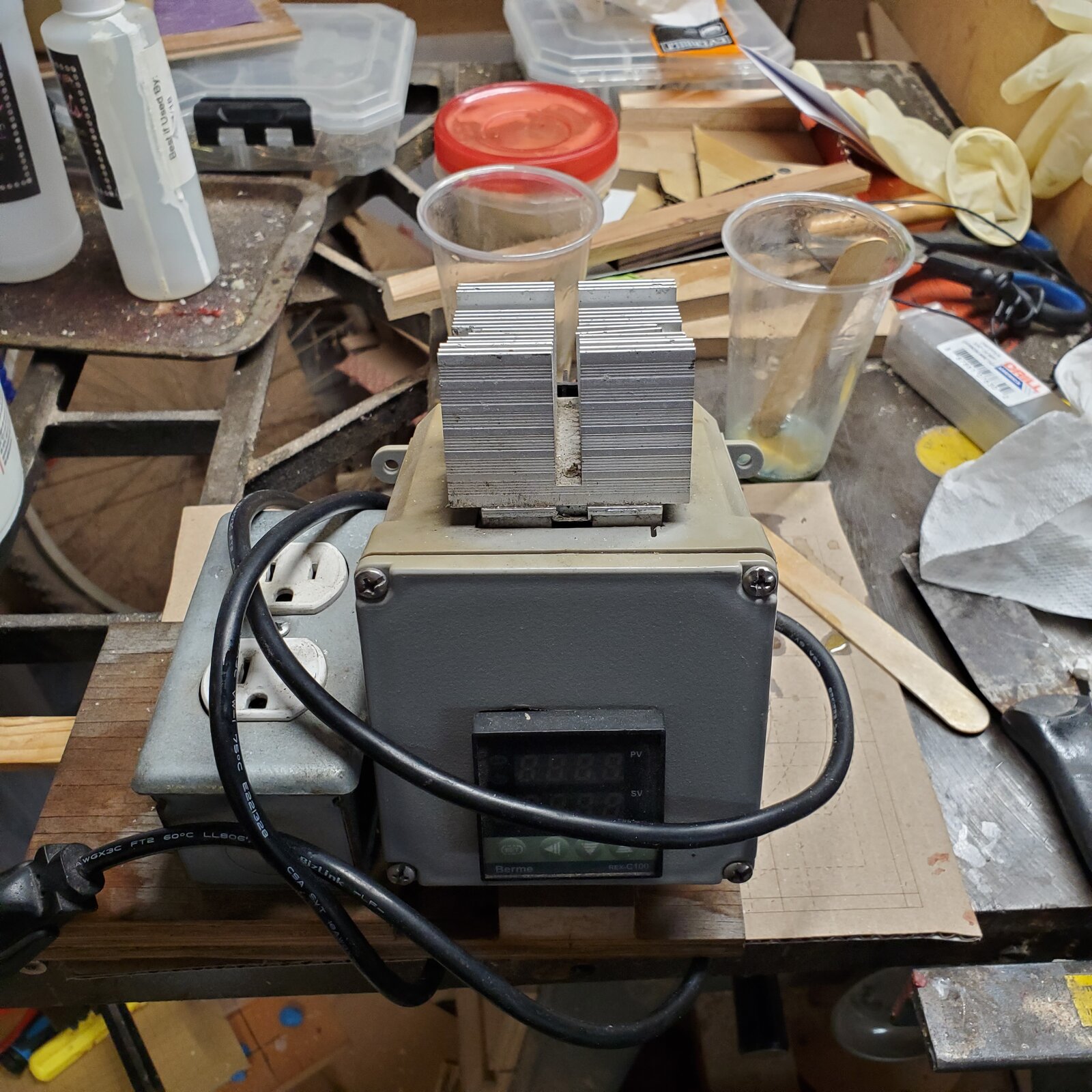

Thats what I use but not to speed curing. I first made this to control my bbq smoker(controlling a small fan) and then my toaster oven to cure stabilizing juice. Heat sink really isn't needed but I also was going to try sou vie(sp?) Cooking and it would be heating up a large slow cooker.
I set the temp on the toaster oven just a little higher then set temp just in case.
