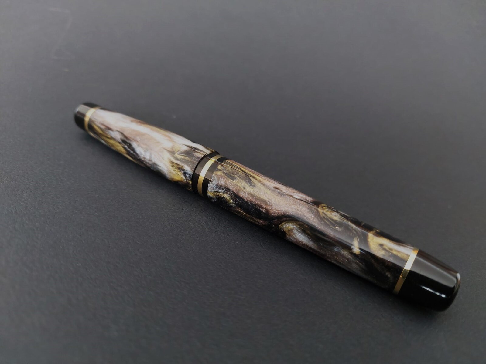

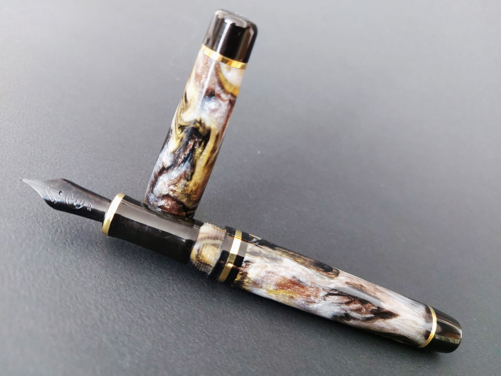

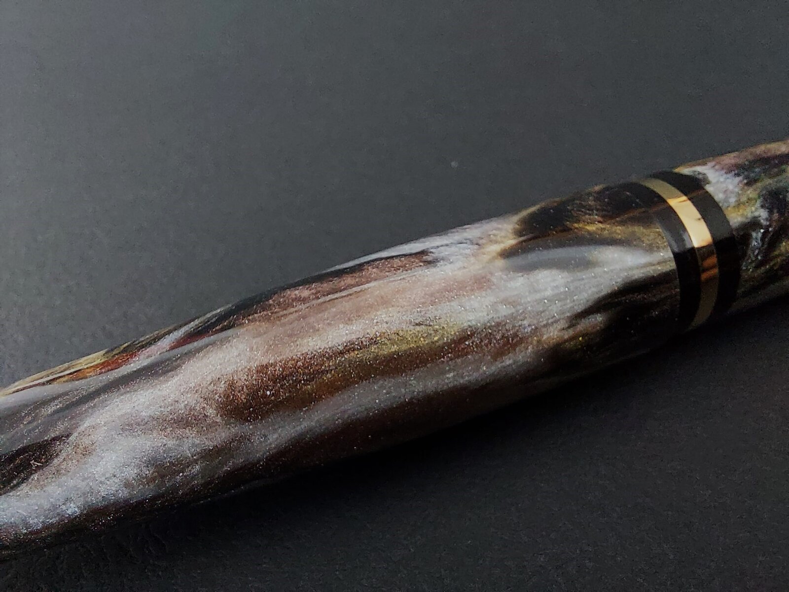

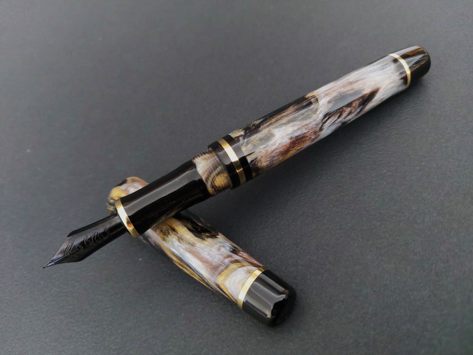

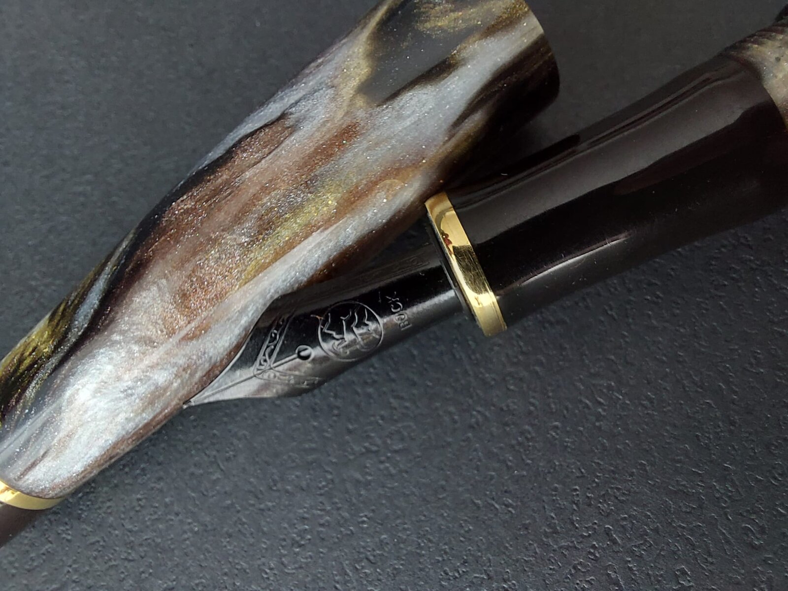

My latest one, called Cosmos. At least, that's what I see looking at the amazing waves of colors and reflections of the acrylic I used for making it. The finials and the sections are made of black ebonite. The nib is a black EF Bock #6.

Beautifully made, the blank accentuates the kit well.
You have to pat yourself on the back being able to fool a kitless pen maker into believing you made a kit pen. 👏😉
Can't wait to see your next masterpiece.
Thank you, you're too kind! Well, the next one is started already, I'll let others to assess what the result would be!
I do apologize, I think I got confused with another one I was looking at previously. My sincere apologies. I still say the blank works so with the accents. Beautiful pen.
No need for apologies, I just wanted to clarify this, otherwise people will jump on me asking for that "kit" source! :))))))))))))

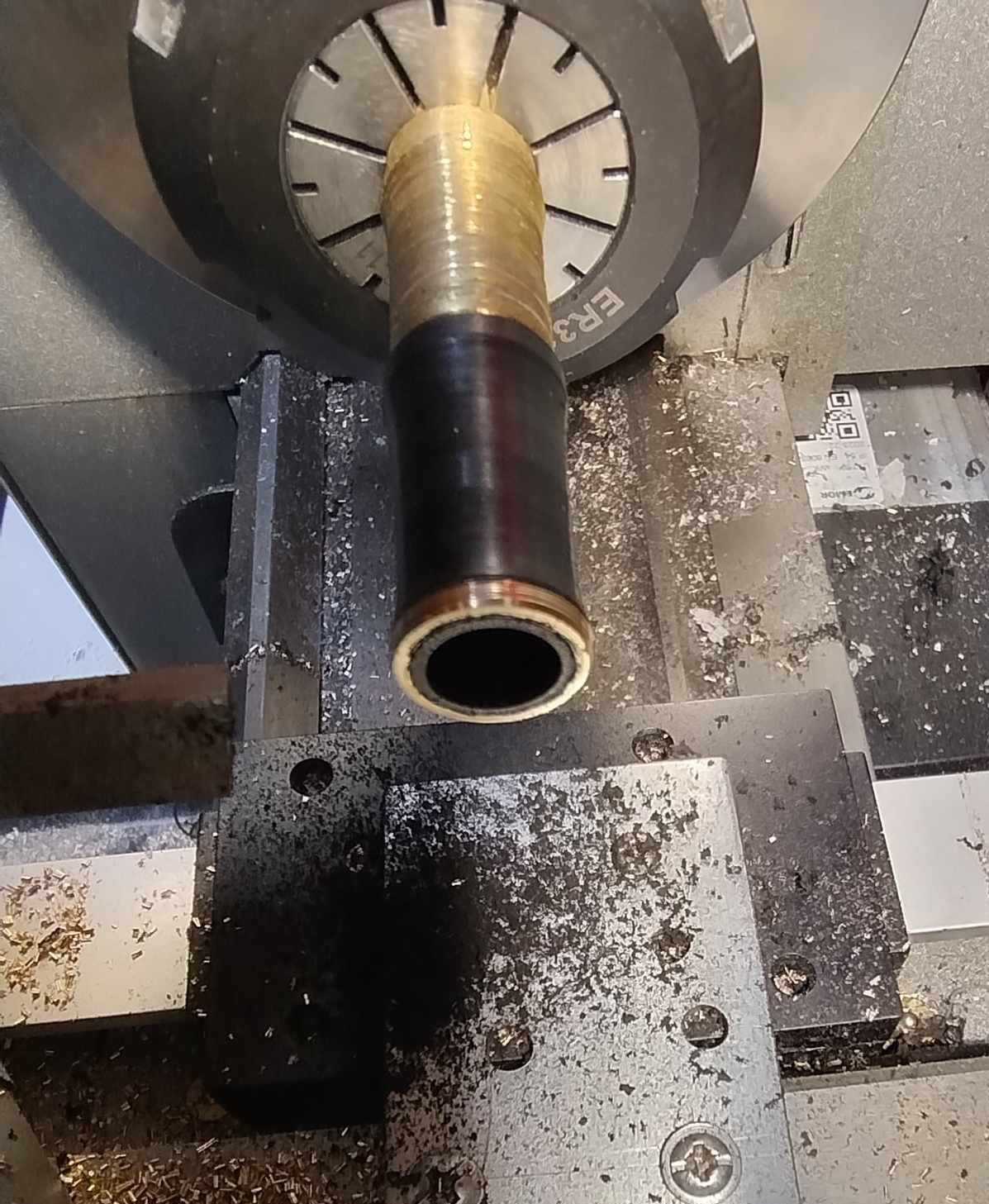

Very nice - I really like the look! I am curious how you attached the gold/brass ring on the section? Accent rings are perfect!
Thank you! For the section I made a tenon at the nib end, I made the corespondent brass ring (just 0.1-0.2mm larger in ID, to accommodate the necessary resin to glue it) and I glued them together with some gentle longitudinal press, left for 24 hrs and completed the finishing for the whole assembly.
Nice work. You did a nice job with both craftsmanship and design. I like the accents at the end of the cap and the metal ring at the end of the section. Neat touches!
If it's possible, can you post a picture of the nib end of the section without the nib? I do metal accents, but not at that end. It looks a little challenging.
Hi, thanks for your appreciation! That's the only pic I saved from that stage of manufacturing, the section and the band were not finished yet.
