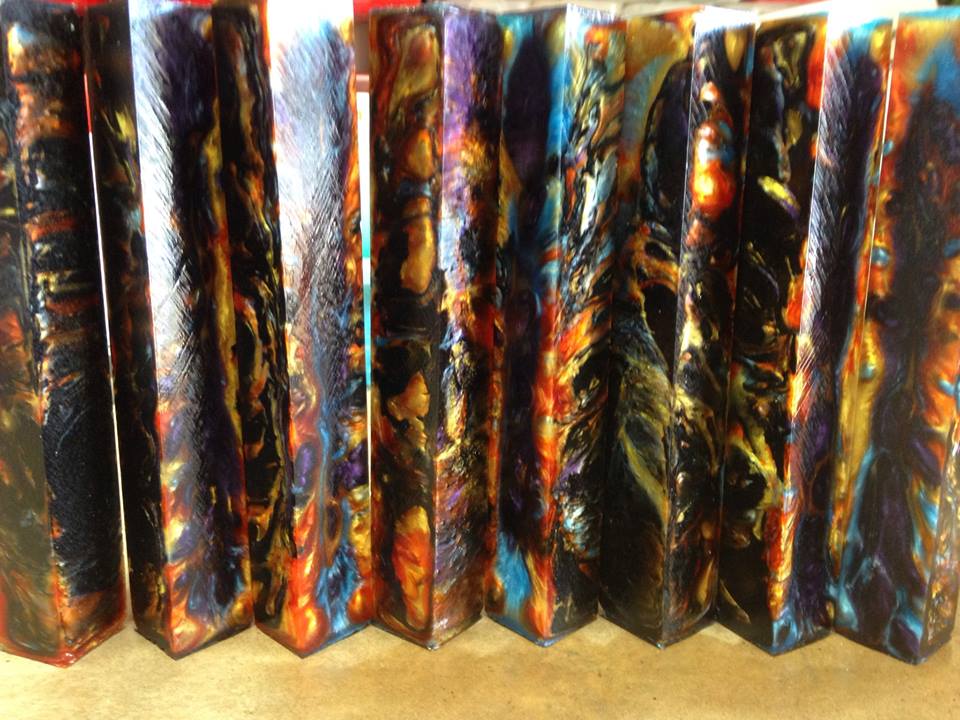

5 color pour make up this awesome looking cosmic pen blank.

VERY nice! Still a total newbie to this...how do you cast the different colors, do you pour them all at one time then cure it? Or do in stages?

Those are spectacular. You could have told me that they were intricately dyed and stabilized burl and I'd have believed you.

These are all alumilite and I cast 5 colors at the same time and pressurize them to 80 psi in a pressure pot to remove all the air bubbles.
