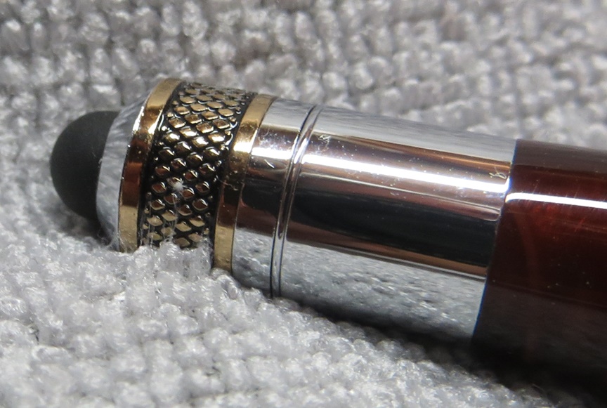

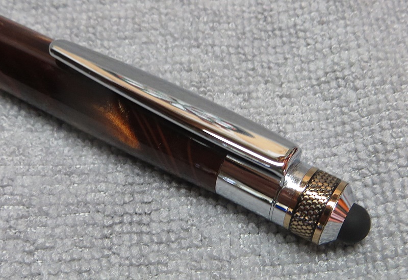

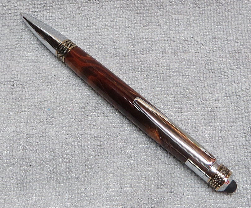

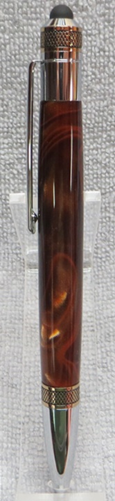

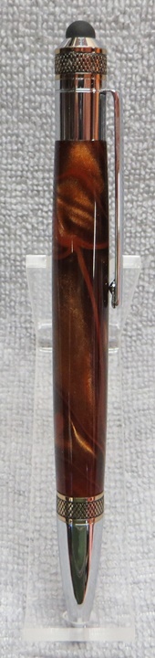

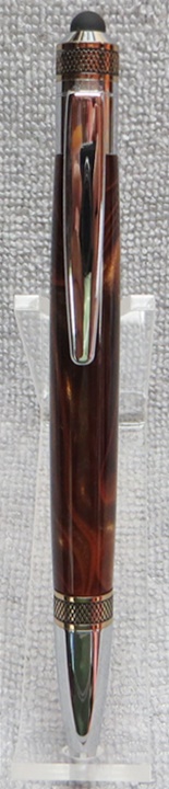

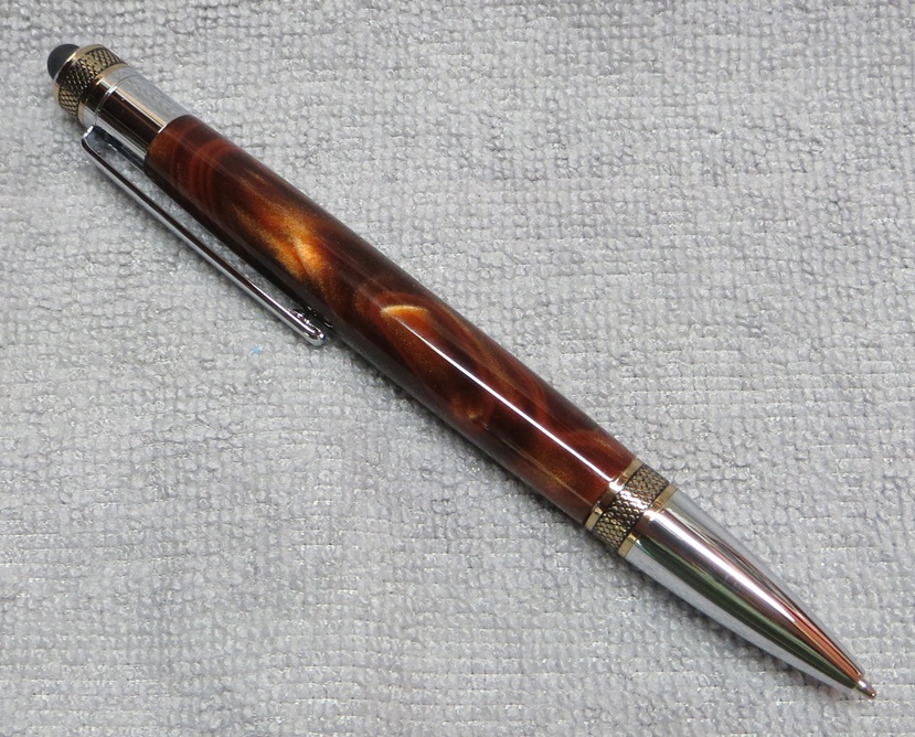

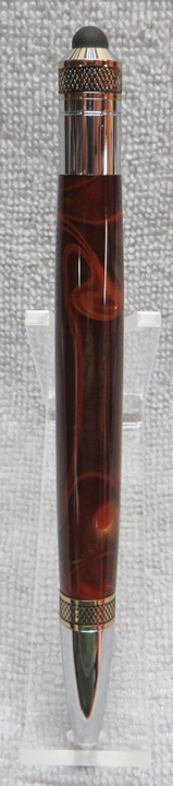

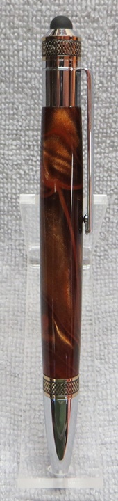

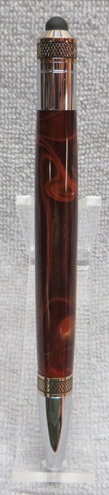

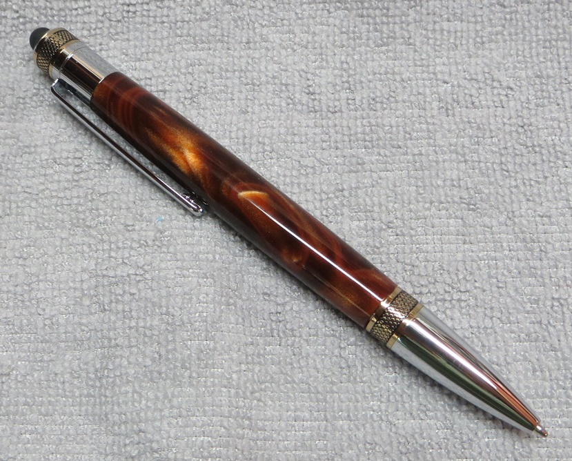

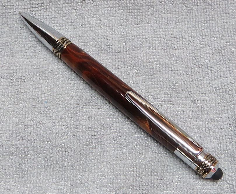

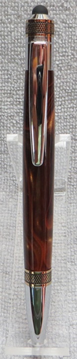

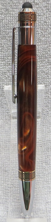

Here is a new kit from PSI, called the Cortona. This one is chrome and gold, and has a stylus on the finial. The blank is from Exotic Blanks, and is called Fiery Brown Embers. Nice blank. Not too sure about the kit, you'll see why. I thought Cortona was an odd name for a pen kit, so I Googled it. It's a town in Italy.

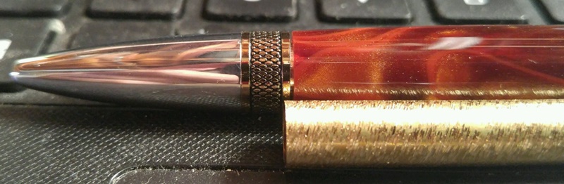

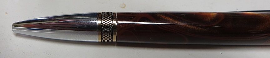

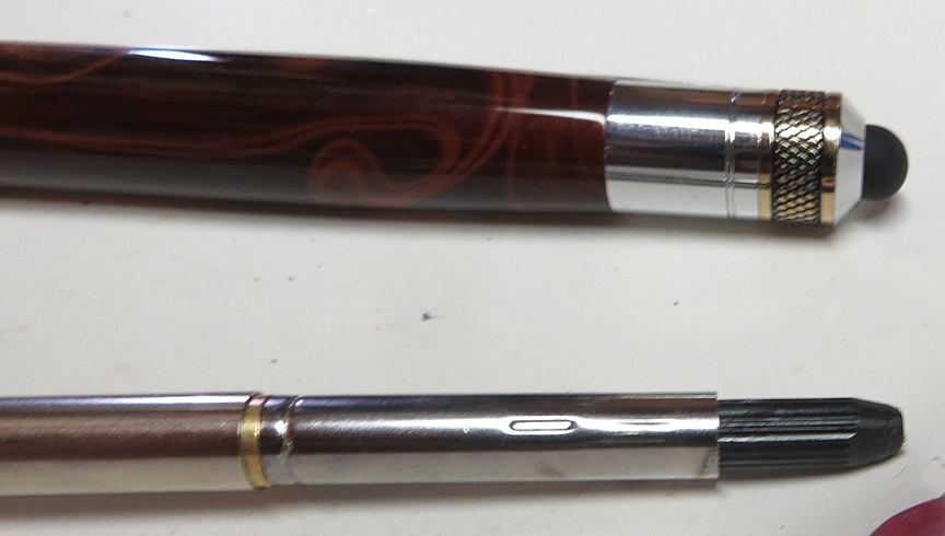

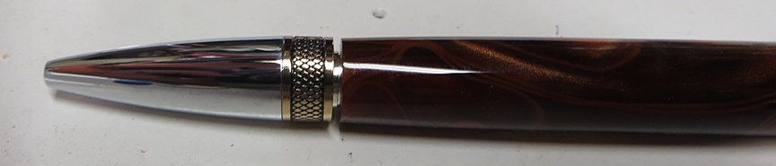

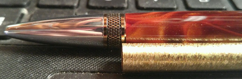

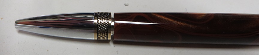

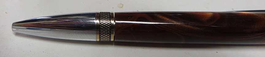

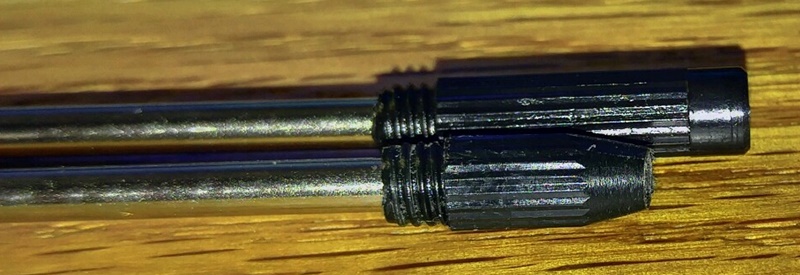

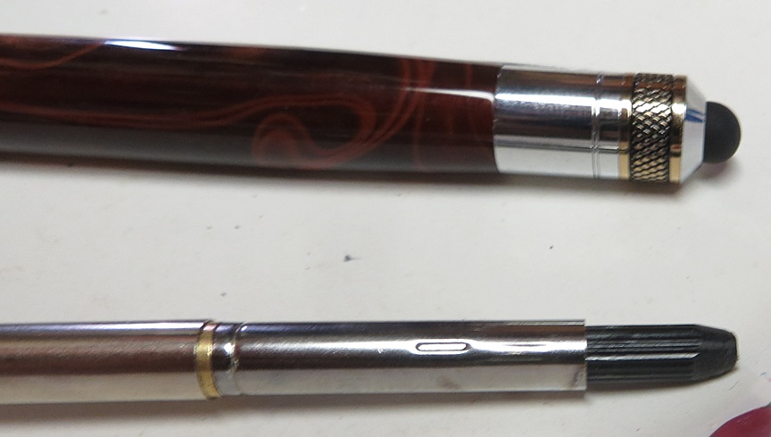

When I assembled it, there was a bad gap between the body and tip. I thought I may have over trimmed it, so I ground down the end of the refill. There is still a small gap, but not as bad. As you can see by comparing it to a tube from another Cortona kit, I didn't over trim it by that much. I had to grind off more of the refill than the difference between the tube and body. So I'm not sure what's going on. I'll pay more attention to the second kit I make.

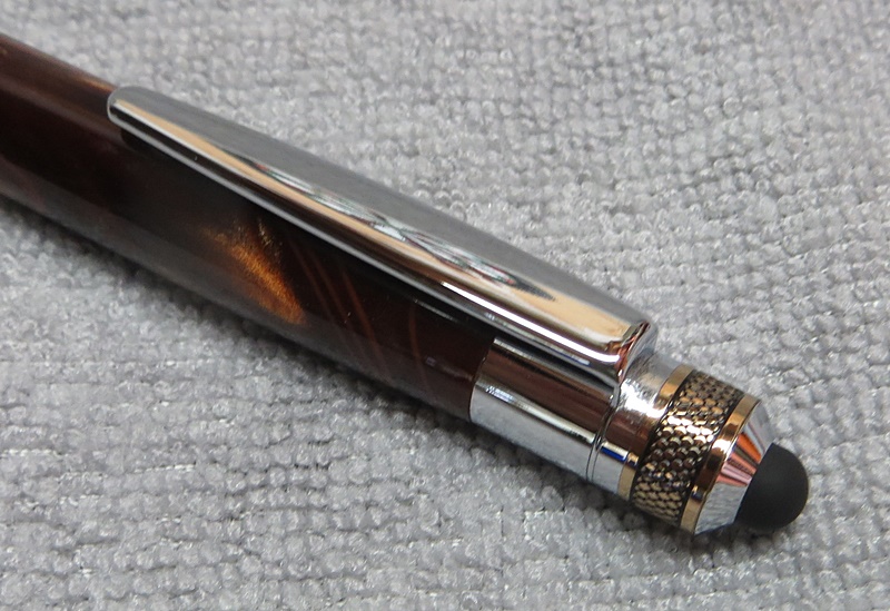

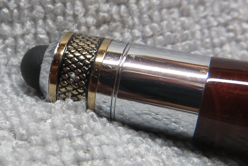

Another thing I noticed is the knurl is kind of "sharp". Catches on material, not very smooth.

FYI, the problem with this pen was my fault. I trimmed it too far. See my successful Cortona here:
This is a long shot, but do you think the brass tube may have slide forward during assembly? As I said, a long shot.
Feb 25, 2010
1,800
webberville, mi

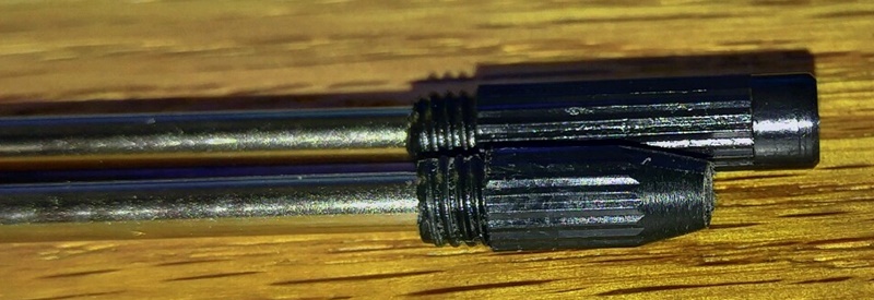

Jim & Tony - I got several of the Cortona's as a trial and I had the same experience as Jim. Seems there are some pen kits out there that are quite touchy when it comes to barrel trimming. Others not so much. I see the Cortona in the first group. But with a "properly" trimmed barrel, it seems the refill will not project from the tip as far as most refills do. I also noticed that the barrel will at times seem too long. Had to grind a bit on the metal sheath that the Cross refill fits in to get the parts to mate up.
I'm hoping this is just something that I need to get used to or is an early production run issue as I really like the finished pen. Not as "beefy" as other pens but not a slimline either plus it has a real good feel in the hand and good balance. I did a couple shows the last 2 Saturdays and sold out of the Cortonas I had made.
carlmorrell
May 14, 2013
691
Cary, NC
I just made my first Cortona. When I went to assemble I had the same fit issue. I measured my blank, and it was right at the 2.99 (3"). So I put it in a press, and heard a snap, as it pressed correctly into place. I think there must be a clearance (fit) issue.
Feb 25, 2010
1,800
webberville, mi
I've done several more and I'm thinking PART of the issues mentioned MAY be the refill that is supplied with this kit. I noticed the back side of the refill of this Cross-style refill is a press fit plastic part. I can extend the metal refill tube and CA it to resolve the short projection problem when the refill is extended but then the body gap issue that's mentioned above comes up. Grinding the metal housing solves that but how can I sell a pen with those problems? So I tried a true Cross refill and - voila! - issues disappear. Only worked on one pen but I'm sure gonna try more.....
Stay tuned....
