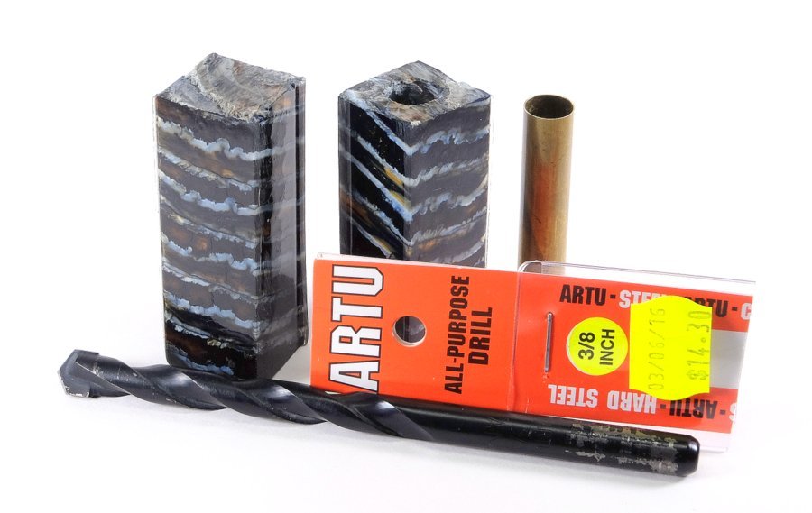

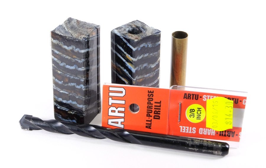

Try ARTU special purpose drills ARTU USA has a 1800 number on Google ,I have been using them for twenty plus years, just drilled a fossil blank,they make drilling concrete a pleasure. They sell individual drills and metric and imperial sets in small increments.
