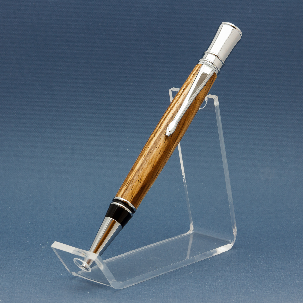

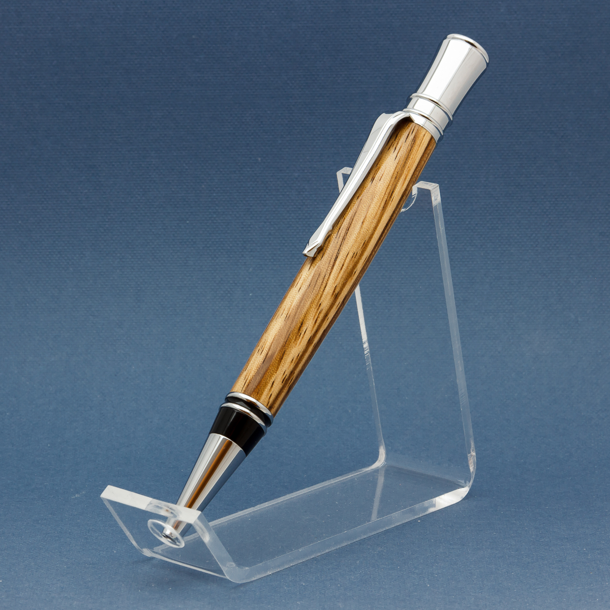

Fresh off the lathe this morning, chrome plating & Zerbawood finished with 5 coats of Shellawax.

@wmillman
Nice work on P.E.I. . ! ! !
That Zebrawood is almost as nice as BOW ! !
The Corporate ballpoint is a lot like the Executive (which costs a tiny bit more).
Is the Corporate a double twist ?
How long does it take to do the 5 coats of Shellawax ? . . . including the wait time between coats .

Thanks
Not much difference really, same tube size and bushings I think, and it has a little different clip, not sure on the twist if it's the same, the Executive has more plating options.
No it's just single.
You can put them on one right after each other, no more than 15min I don't think, after I apply a coat I turn the lathe up to about 1500 RPM and really burnish that coat in, let it spin for another min to let it cool a bit then turn lathe speed down to 350 and repeat.
