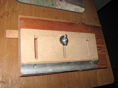

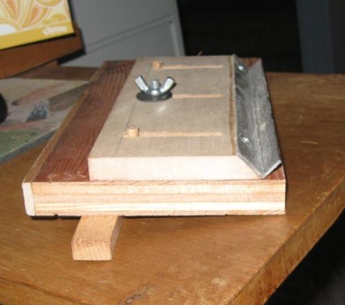

Here are a couple pictures of one I made. It works pretty good. I have only used it a few times.

Why waste time cutting the corners off? That's what the lathe is for. If it's just to cut down on the possibilities of chipping or a catch when starting, I just use a belt sander to take the edges off.
What Monty said is a lot faster. I have one of those jigs somewhere, wasted the money on it a couple of years ago.

Why? If you cut the corners off, then you will make it much tougher to find the center for drilling. One miscut corner and your perception is off. You buzz them off with the rest of the blank on the lathe anyway. Sounds like a government project idea.

Well, not here to argue with you, but I think I would mark the center of the blank before cutting... but I agree this kind of jig isn't necessary. I can't remember why I made it to begin with. For some reason it seemed necessary at the time.
