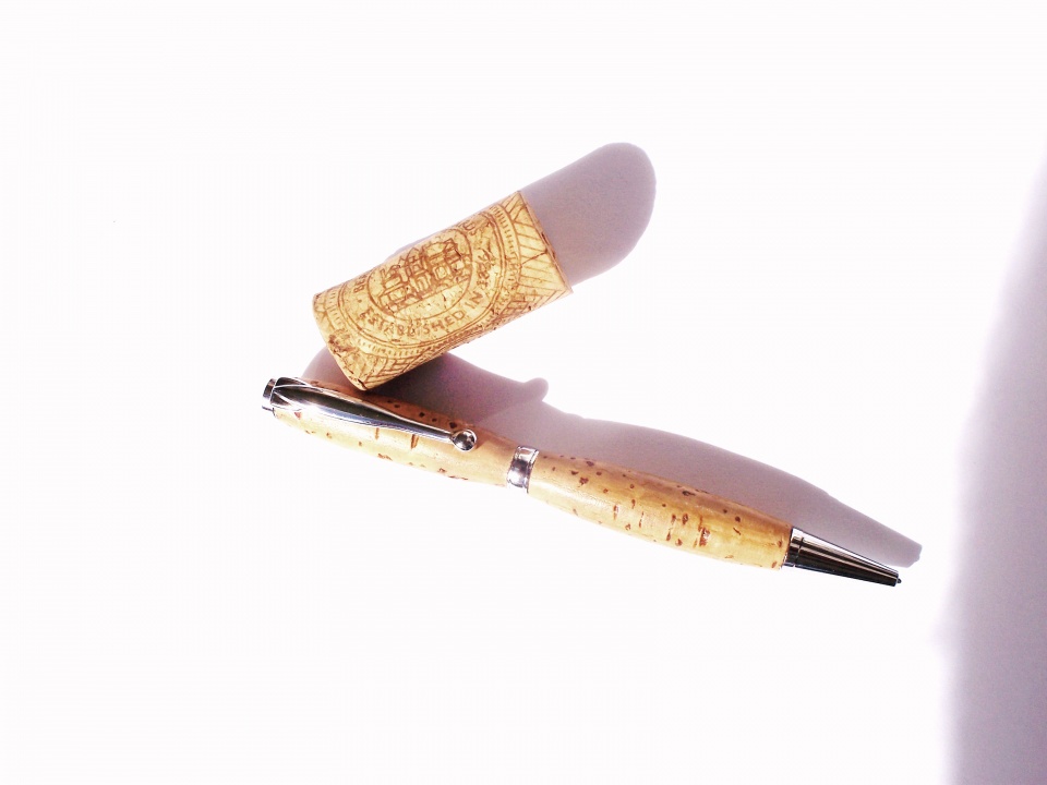

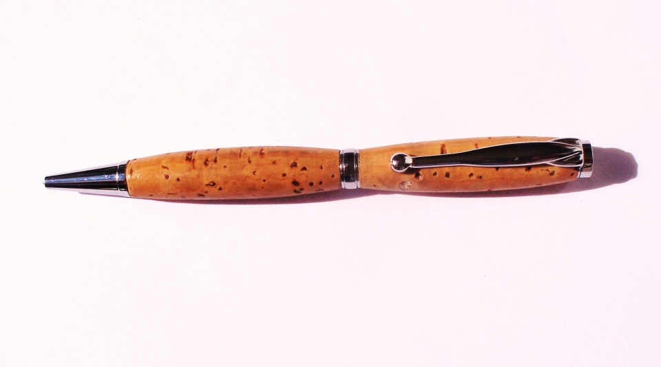

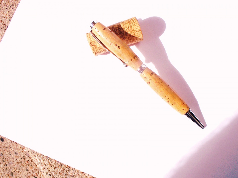

It took 4 blanks to make it but I did it. Two of them blew out while turning.
After turning, a little spray lacquer and a little paste wax.
Feels great and writes nice.
C&C welcomed
Pictures were taken by a Kodak digital camera in sunlight. This is pratice for the upcomming bash.

Cool stuff Wayne !!:biggrin: I hope you had the pleasure of the wine..:)
Are the finished blanks still spongy or are they hard from the finish?

Thanks Skip. You can not use CA as a finish on them, they get hard and fall apart. I put on 6 light spray coats and sanded inbetween the last two with 1500. Then the paste wax gave it the shine I wanted. The blanks still feel soft to me.
Michael, I don't think you can go to thin with this material. It really falls apart if it gets to thin. But this isn't a "fatline" as I understand them.
Maybe the next pen I will have the wine the night before.......lol
