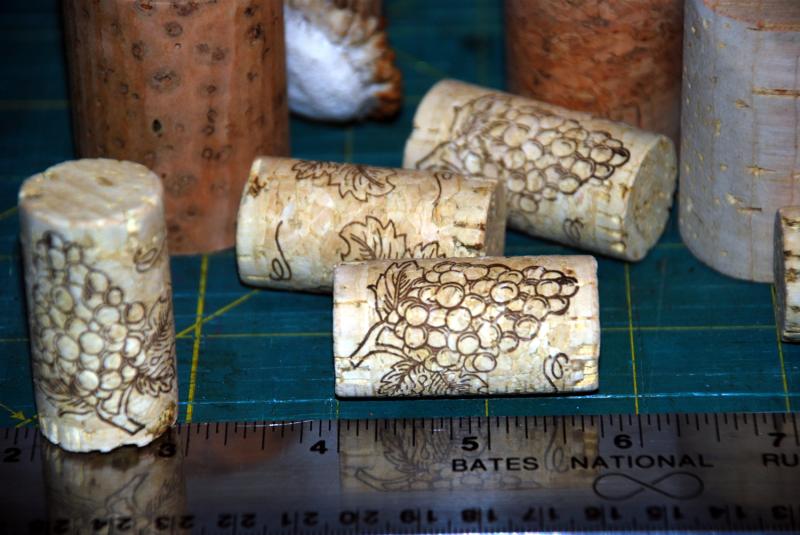

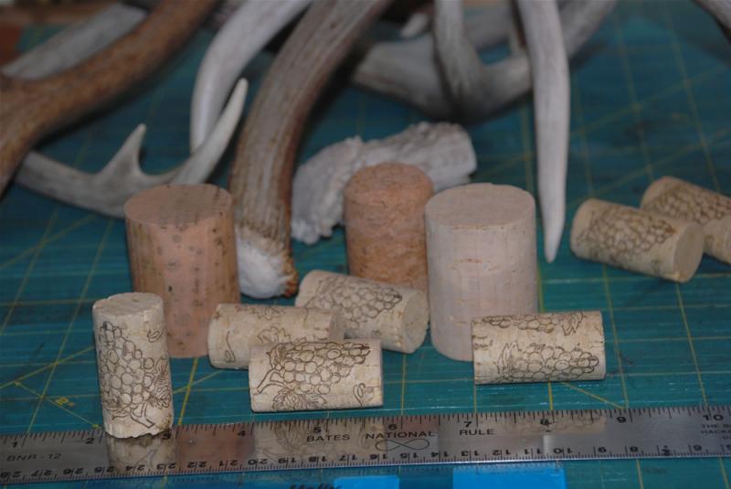

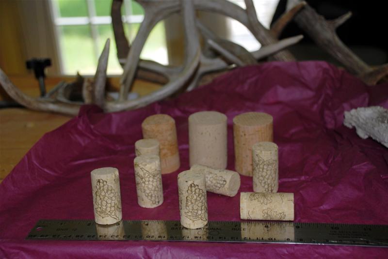

I am trying to attract business from a Vineyard. I told them that a pen could be made of their cork with their signature on it. They sent me some sample, clean cork. The cork is 15/16 inches wide and 2" long, even though the pictures show a generic cork 1-3/4 inches long.
I need to wrap this cork around a tube belonging to a Big Ben Cigar upper barrel.
The first issue of cutting a hole is solved.
The second issue is how do I know how much to cut away to fit a cigar tube?
The third issue how do I bend the cork without breaking it?
In finishing it, would you put it into an Alumilite blank OR finish it similar to a pine cone with BLO/CA?
Sylvanite
Jul 18, 2006
3,115
Hillsborough, North Carolina, USA.
I wish I had an easy answer for you, but I don't. Cork swells and shrinks quite a bit with moisture content. That's what makes it good for its purpose. The liquid in the bottle keeps the cork swollen to form a good seal. Cork is also quite elastic. The corking process involves soaking the corks, compressing them, and then forcing them into the bottle neck (where they swell and seal).
Because cork is elastic when wet, and because it swells and shrinks with humidity, if you wrap a tube, the joint may open when the cork dries out.
Soaking (in water) will soften the cork, but you wind up with shrinkage problems as above.
Have you considered drilling and turning a cork instead of wrapping it around a tube? Cork can be laser-engraved, so you could reproduce their trademark after turning.
