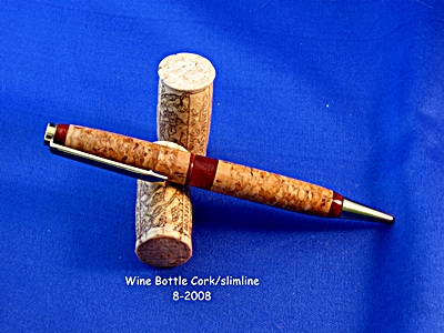

I've made several pens using wine bottle corks. At first I started soaking them with CA as I turned them, turn add a little, more CA. Them I found out they turned better not soaking them in CA as I want. The cork fell out in bigger curds when they were stuck together with CA. I got to where I only applied the CA when I was almost to the desired thickness. THEN someone on this forum wrote about using that sanding mesh, that they use to sand drywall putty with. It worked great.

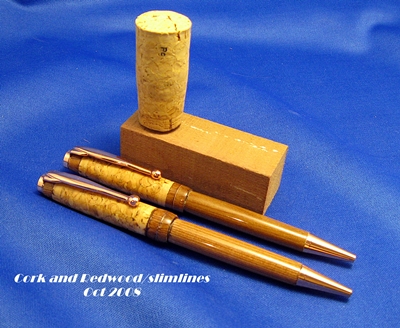

First picture is the first cork pen I made. The second are pens I made for my neighbors that own a winery. They are cork and wine barrel stave.
