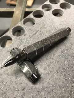

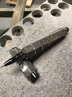

I just finished one the other day. I used aluminum and epoxied every thing together. Not sure if epoxy is the right adhesive, but seemed to work fine. Anyone have a better suggestion for bonding the Corian to aluminum to the brass tubes?
"Corian is a brand of solid surface material created by DuPont. Its primary use is as a countertop/benchtop surface, though it has many other applications. It is composed of acrylic polymer and alumina trihydrate (ATH), a material derived from bauxite ore. "
Not much there that I can see dulling a tool any worse than some woods we use.
Hey, Tim .... that's a good looking pen !!! . Good thing that I asked the question, eh .... now we got to see it !!! :)
Dunno how you get that perfectly twisted shape like you do !!! . It's really nice !!!
Thanks, that Corian finished nice. I sanded to 1200 grit and then buffed. Also, the aluminum "dust" does not discolor or contaminate the Corian. Now to make another one.

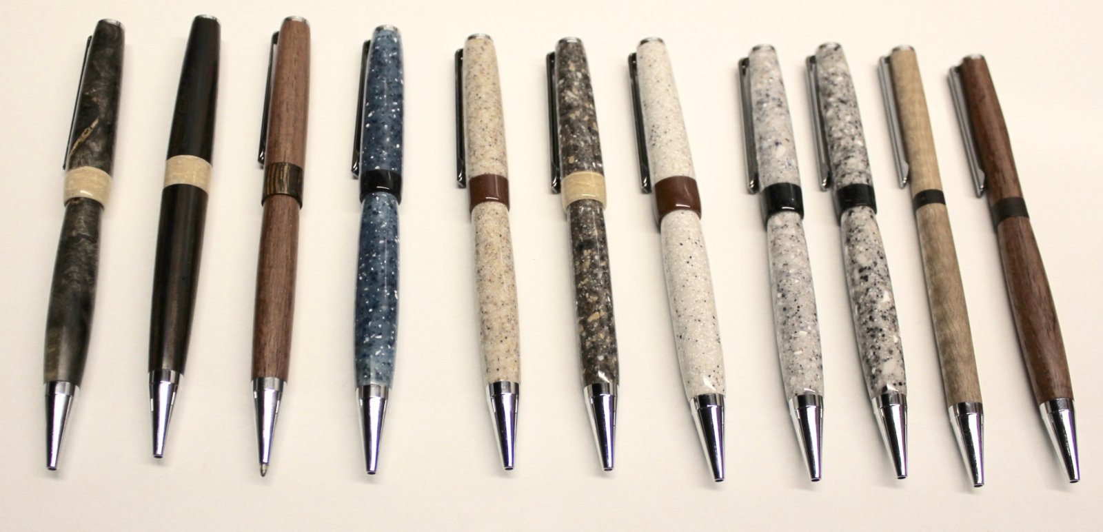

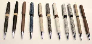

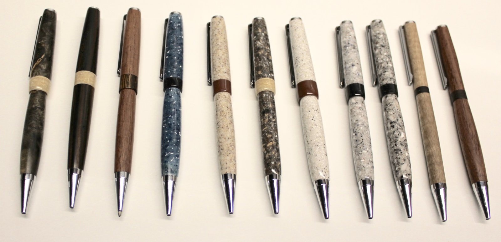

I have made 30-40 modified slims with corian and really like it. Cuts easily on table/band saw. Turnes easily and takes a great finish. The only downside is that it is not a really hard "composite", so it can scratch if enough pressure is applied.
For me: turn/dry sand to final dimensions. Wet sand abranet to 600; wet sand micromesh to 12,000; McGuires Plastic Polish. I don't usually buff/wax - I'm lazy. I usually make the modified slims and give them away to service folks.
