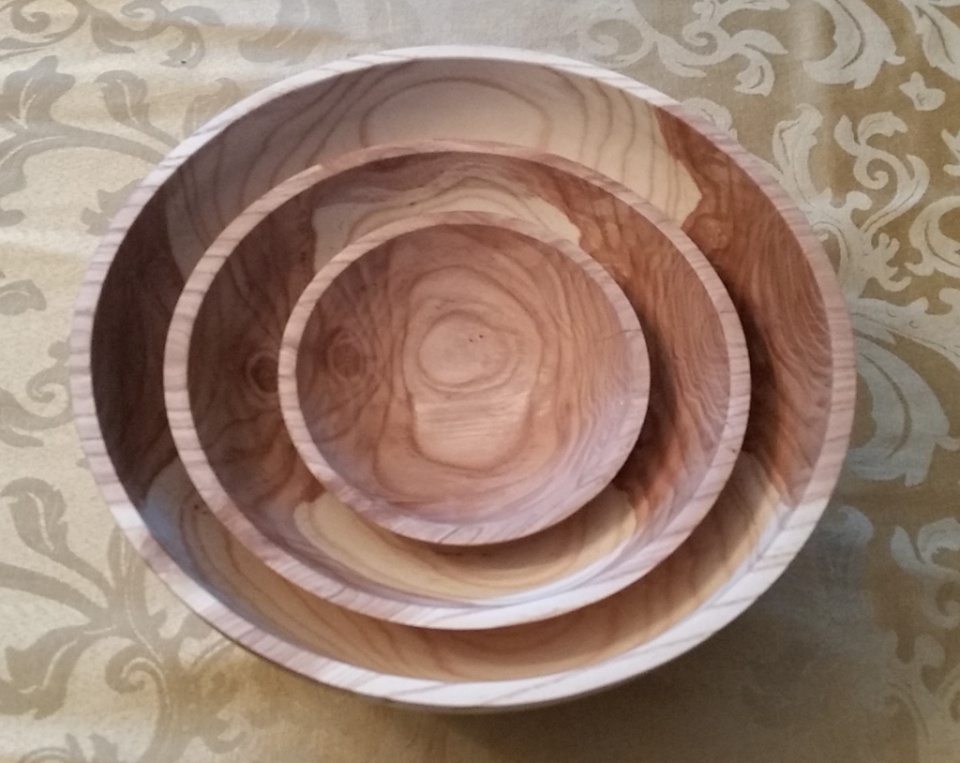

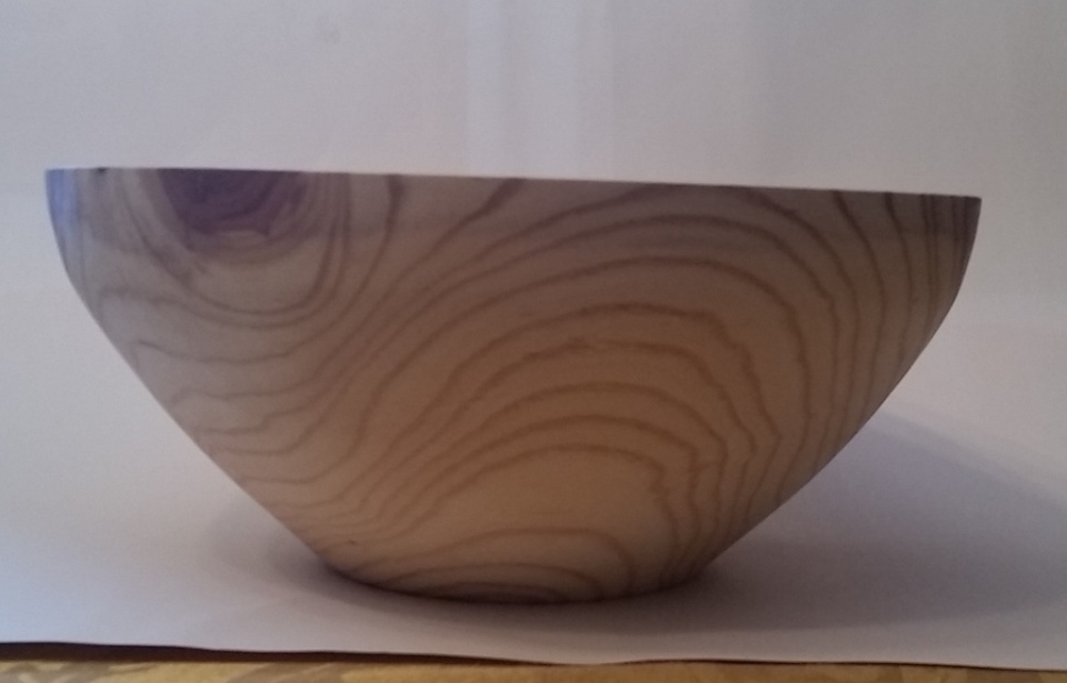

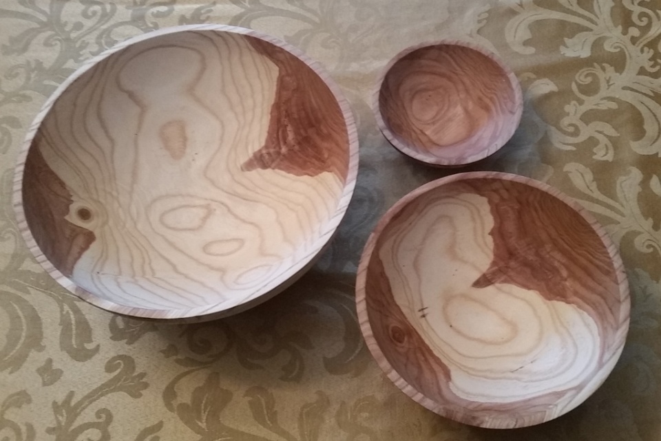

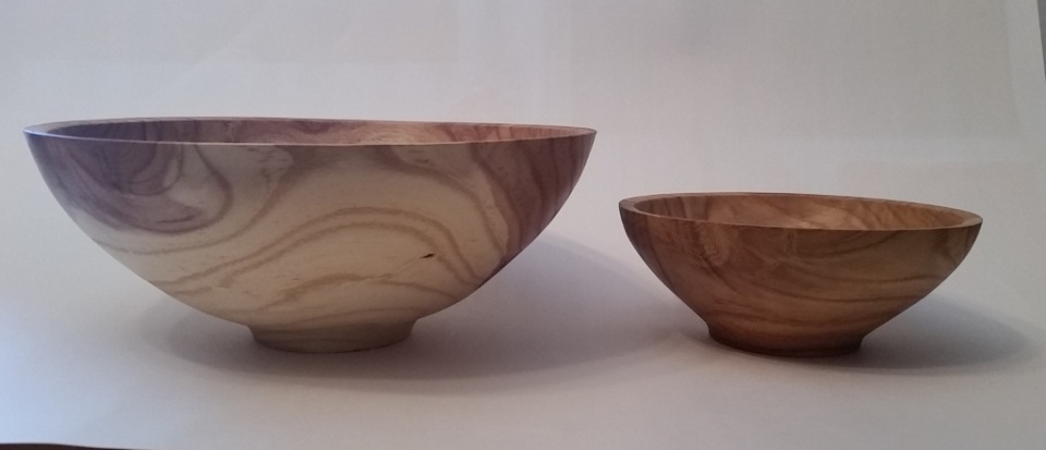

So I bought a McNaughton coring set over a year ago and didn't have the time to try it out (I was also a little reluctant to screw something up :eek:). Well last month at the local woodturning club meeting, one of the members showed us how to use this system.
I tried out my system on a couple of bowls last month and yesterday I finished my first three bowl set. These aren't perfect but I think they turned out really nice. The wood is Ash and the largest bowl is about 12" in diameter. Finish is a blend of beeswax and mineral oil.
C and C welcome!

Those look really great. How difficult is the coring system to use? Is this the progression of work:
-turn the outside contour,
-then the inside of the smallest bowl,
-core out the small bowl,
-turn the inside of the next bowl, and
etc. until you get to the largest bowl?
Once cored, how do you clean up the outside of the inner bowls? Do you use a jamb chuck?
Did you go from green timber to finished all at once, or was this done over 'some time'?
Coring is definitely on the 'short list', so tired of wasting all that material to shavings on the floor....BTW, nice piece of ash you have there!!!

The system was easier that I thought. The biggest things are to get the cutting edge on center and to be sure you know where it is when coring the blank. I know there is still a lot for me to learn about it but I think it went well for this set...
Here's what I did:
-Using a faceplate, I turn the outside of the large bowl
-Flip the blank 180 and core the larger inside bowl
-Finish the inside of the large bowl
-Re-mount the faceplate to the core and turn the outside (leaving a tenon)
-Flip the blank 180 and core the smaller bowl
-Finish the inside of this bowl
-Re-mount the faceplate to the remaining core and turn the outside (leaving a tenon)
-Finish the inside of the smallest bowl
Then I carefully remove the tenons and viola!

Scott,
I did this in a matter of a few hours. The wood was still somewhat green but definitely not dry. I like utility pieces so I don't mind a little curve to them when they are done. In fact, I turned the bowls on Wednesday and then removed the tenons yesterday and the larger bowl was already out of round by about an inch.
Not only did I get some extra bowls out of this, I think I saved some time by coring.
