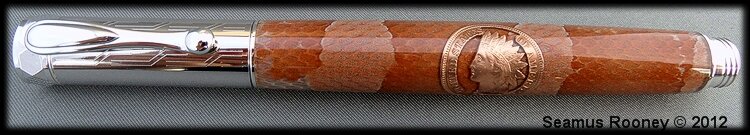

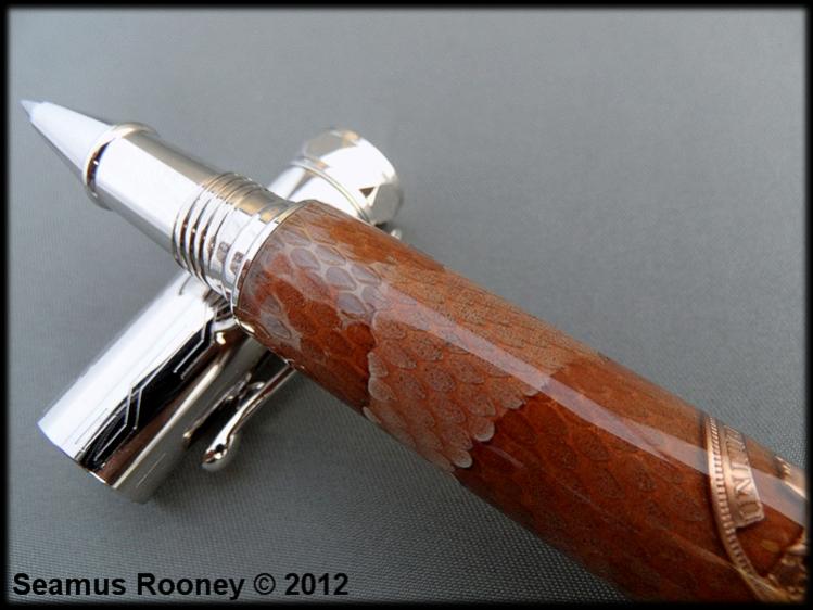

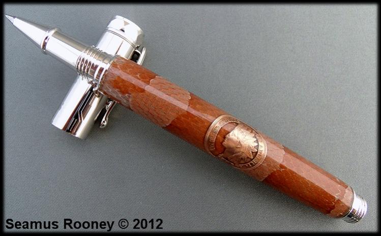

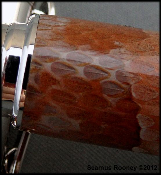

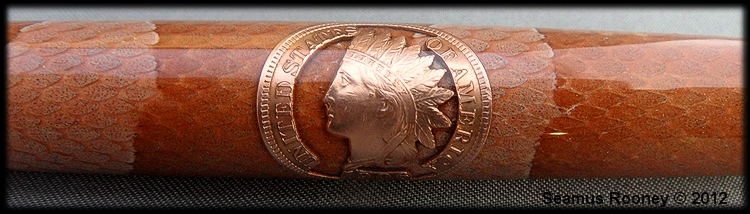

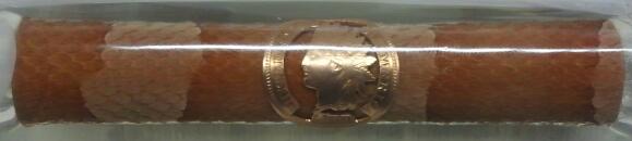

I started this thread a couple of weeks back and finally got around to completing the casting process/turning and assembling. Unfortunately, when i pressed the components into the tube(everything was squared up too), you can see by the photos that it appears a separation occurred :eek:between the skin and the resin. So the only thing i can think of that might have caused this is the plating on the components that were being pressed in, had too much plating on them. this is a first for me, usually the failures occur after you cast before you turn the blanks. Anyway, you get the overall idea of what i was trying to accomplish i hope. It was to combine the bronze penny with the copperhead snakeskin since they both have similar colors! Hope you all enjoy and as usual C & C Welcome!

A great idea and nice job. I have done a few rattlesnake skins and have the separation more times than not. Usually it happens before turning but has happened while assembling the pen. If you work it out, please let me know what you did. The separation has been very frustrating.
If one didn't know better...looks like modeling in the skin...something other than a plating, finish, casting or failure. I have a real problem with "failure" being used here!
Looks awesome Seamus! I have also had that separation doing snakeskins and other castings. Most often it occurs when I press the components in. I think, in my case anyway, it's just the pressure against it.
What i think i should have done was to take some 220-320 grit sandpaper to the section being pressed in, and lightly sand the plating off. But it is also possible that the resin was not 100% cured on the inside of the blank. It might have been slightly soft. I wont rule that out yet till i check into it more thoroughly.

Thanks Jennifer! My thinking here is that the resin may have been just slightly tacky right above the skin(like maybe it wasnt fully hardened.) I dont really know, but if this were the case then it would make sense because as i pressed in the component, if it were slightly larger from too much plating then it would cause expansion of the tube, which would then press into the resin . this is really difficult to describe without having an example to show in person.

You could try to knock the component off and put a small bead of resin round the end of the blank and quickly put it in the pressure pot and see if you can push the resin in under higher than normal pressure.
From the outside, and I'll be the first to admit that I'm somewhat out of my depth here
but the common problem is the skin moving around creating voids.
Just a couple of thoughts, When the skin is put on the tube would curing it in a vacuum
give it a tighter bond?
Or,cool the tube with the skin on it down in a fridge before pouring so pouring and pressure will allow the blank to expand into the resin?
That such a beautiful pen had a mishap like this is criminal,not to mention the work and planning that went into it.
As the pen is has failed ( only by your standards for me it would be a home run )
I'd drill a pin hole in the void area and use a hypodermic loaded with warm PR
and try to fill the void without taking the pen apart and risking more issues.
One of the inherent problems when working with certain material, esp when you start pressing the items on the tube diameter will EXPAND. I have been told that the 'flexible' CA would be better suited for these projects and the other aspect is the tube to hole gap.
What a cool pen/ny, sorry that it didn't work.:frown:
I got some good advice, now I use a Dremmel-like tool to reduce the inside of the brass tube for a slide-on fit and epoxy or Locktite the parts together.
Such are the hazards of press fit parts. The pen is awesome. A really great concept. It's still a beautiful piece of art. Nice pen Seamus.
Man I hate that. But you can still use the penny right?
And I'm sure you've already thought of this, but next time you could remove some of the plating from the fitting, or from the inside of the brass tube so the parts would just slip together. The just glue the parts to the tube so there is no expansion. Not that I would have thought about this before it happened. I know I didn't when I made the pen from your quarter blank.
A pin reamer of the appropriate size and a tiny drop of loctite is a good thing.
Used pin reamers are available from old machinists, flea-bay and pawn shops. They are tapered at the rate of 1/4 inch per foot and are a in a numbered series of sizes.
The advantage is to gently tighten with a slight even taper. Works better than the reloading reamers because the taper is longer.

Anyone tried wicking some ultra thin CA in the end to see if it will hide?

I did try this method but to no avail. Its all good, I will say this is the first time i have ever used this kit as opposed to the real Gran Torino from Arizona Silhouette. Looks like i will chalk this up to a great learning experience! Again, this is how we learn and grow right?!
