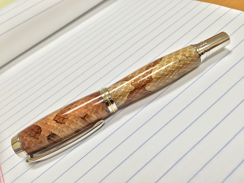

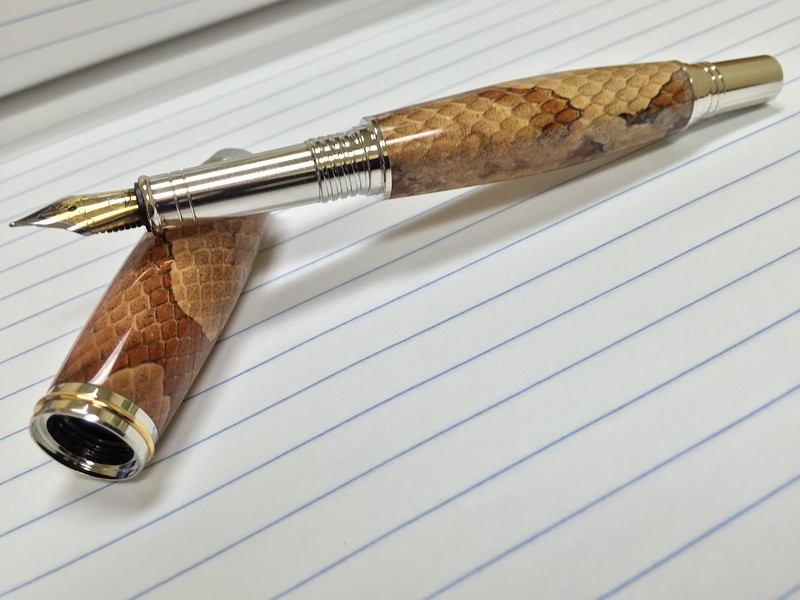

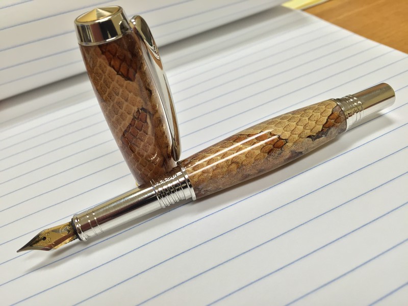

I was finally able to get my hands on a copperhead snake blank. This fountain pen is the result. The pen hardware is a Jr. Gent II in rhodium with a Heritance fine nib. Micro-Mesh to 12,000 and then Hut's Ultra Gloss. It's currently inked with Noodler's Black. Sorry for the funky angle in the shots (especially the third one), I was trying to fit the whole pen in frame on my cell phone.
The really sad thing... the pen slipped from my hand last night and landed on a hard floor. :mad::mad::mad: For my clumsiness, I now have a fracture in the body towards the posting end of the pen. I can't feel it with my fingernail, so we'll just have to see what happens with it. Fortunately I took these pics beforehand.
