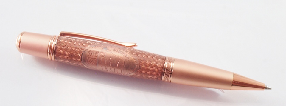

Another souvenir penny and copper braid on a Sierra Vista.
Very nice. Where would I find a lesson on how you made it. The blank that is.
Thanks.
I purchased a roll of braided copper cable sleeve, slipped it over the tubes, coated with med CA (2 coats), used a dapping block to bend my penny, CAed the penny on the braid, cast in PR, turned and polished. You need a kit with extra meat since the sleeve and penny need a thick wall for adequate coverage.
