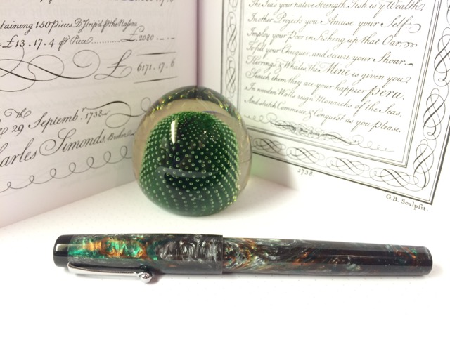

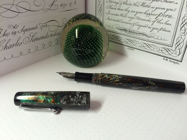

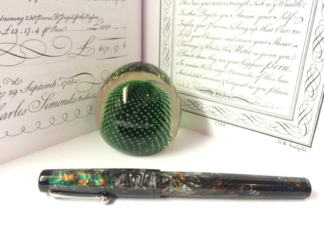

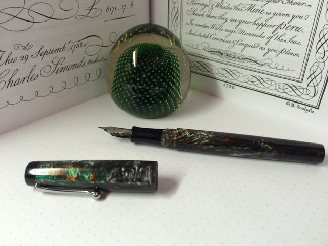

Another pen just finished is this one. Exotic Blanks - Lava Explosion 'Copper Mountain'. This pen material arrived as a substitute for another material that was out of stock. I had only two pieces to work with so needed to get it about right first time :wink:
The section and cap finial are turned from black Ebonite. The nib is a polished steel nib from Bock. Filling mechanism is cartridge/converter.
