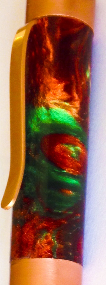

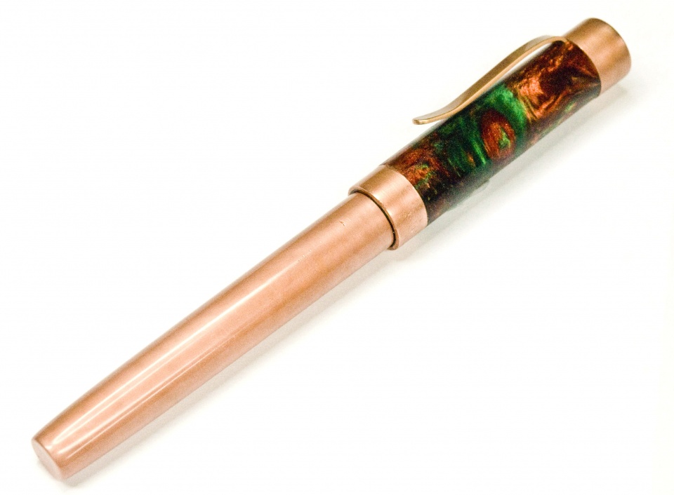

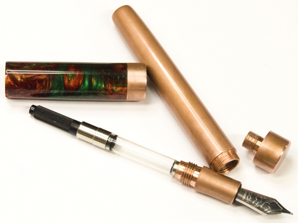

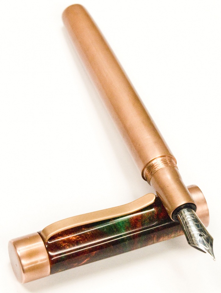

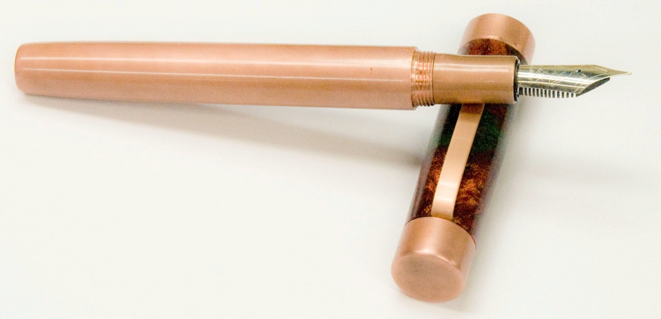

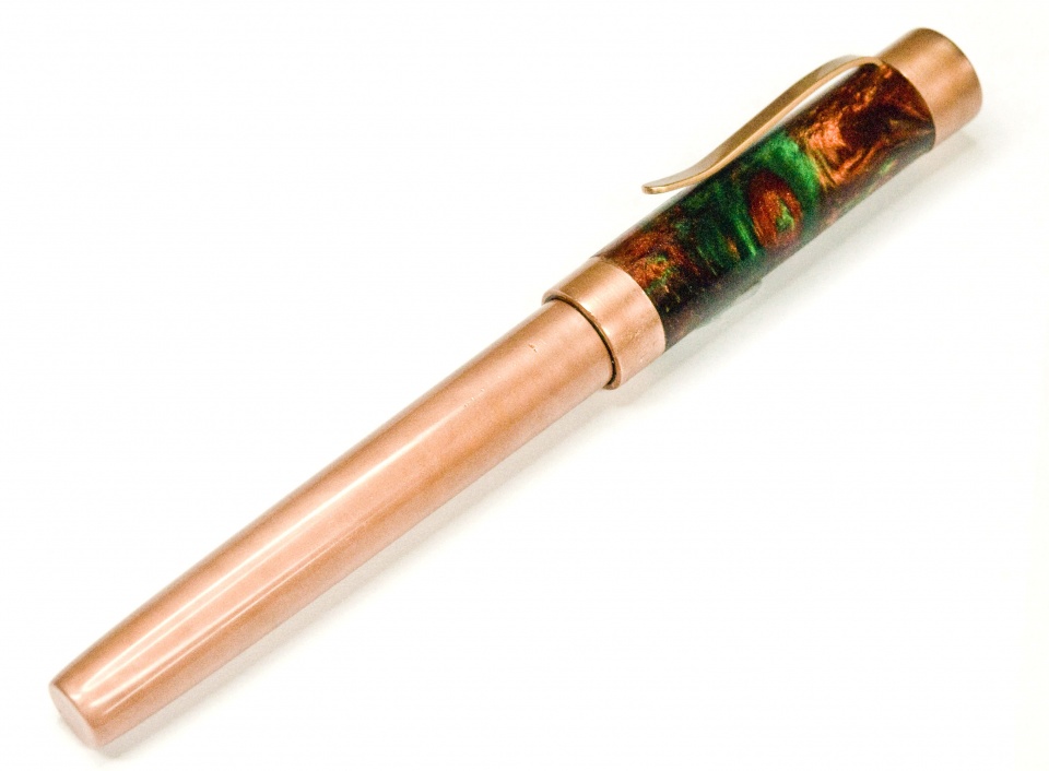

Finished it this morning. Made out of a copper rod and a piece of Eugene's (ElMostro) Lava Lamp collection. Thought I would post it before heading to work. Hope you all have a good day. Thanks for looking. Doc:smile:

Doc, as always your work continues to amaze and inspire us to be better and better, thank you for sharing.
__________________________________________
Everyday I'm vertical is a great day
That is just a fantastic pen. I've been wanting to try turning some copper. I guess I'll have to order some & give this a try. Any tips on how you did the clip?
:good: Good looking pen. :good:
On my computer the pen looks like it has a clear coat of some kind on the copper. Did you put one on to keep it from tarnishing or greening the users finger?
Pete
I think it is AWESOME.. but then again I am an electrician in my paying job. :) Where did you find the copper rod? I want to make something out of copper sections for my Dad, my mentor for Christmas and having issues finding much in the way of copper
You're on a roll with the metal pens Doc! Nice color combo, I wouldn't have thought about it, but it works great. Was the copper gummy to turn?
Mike
Absolutely beautiful.
I really like the contrast between the copper and the resin blank.
Did you make the clip out of copper, or use the one from out of a copper cigar kit ?
Thank you all for the kind comments and encouragement! Doc:smile:
Bob, the clip is from a satin cigar kit
Pete
Pete, I use 3 coats of VHT metal lacquer from Caswell Plating. Very durable.
Mike
Yep!...Gummy...gummed out the flutes on the drill....had to uncurl them from the bit...
Clip from a satin copper cigar kit
What do you use to keep the copper from tarnishing?
Leslie, I etched the copper and immediately follow that with 3 coats of VHT metal lacquer from Caswell Plating. Very durable finish. No tarnish
Mitch, not wanting to hijack, Doc's thread.
I believe that in the States, you can purchase Copper Lightning Earth rods, similar to what we use in Australia, to earth the wiring for our houses.
The regulations were changes some years ago from earthing on a water supply line to having to have a seperate copper rod driven into the ground and to have the earth connections attached to it.
From Memory, it is probably a little excessive in diameter to be used for pens, But worthy of an enquiry, for what it's worth.
Regards
Brian.
Outstanding Pen, Doc
Fantastic Copper Blank, and Superb Blank from Eugene.
Great Line, Proportions and Profile.
Excellent Fit and Finish, your attention to treatment of the Metal, is Terrific.
An Awesome Pen.
Brian.
Brian,
I am actually an electrician, and use ground rods on a regular basis. They are only copper clad with a steel core though. :)
Mitch,
I'm so sorry... I just noticed you asked for this... This is where I get my copper rod from. I included the order page as well as the guide to selecting from different types of copper rod/alloy.
Regards,
Doc:smile:
Order Copper 101 Round in Small Quantities at OnlineMetals.com
Guide to Buying Copper Online | Online Metals Guide to Selecting Metals for Your Project
