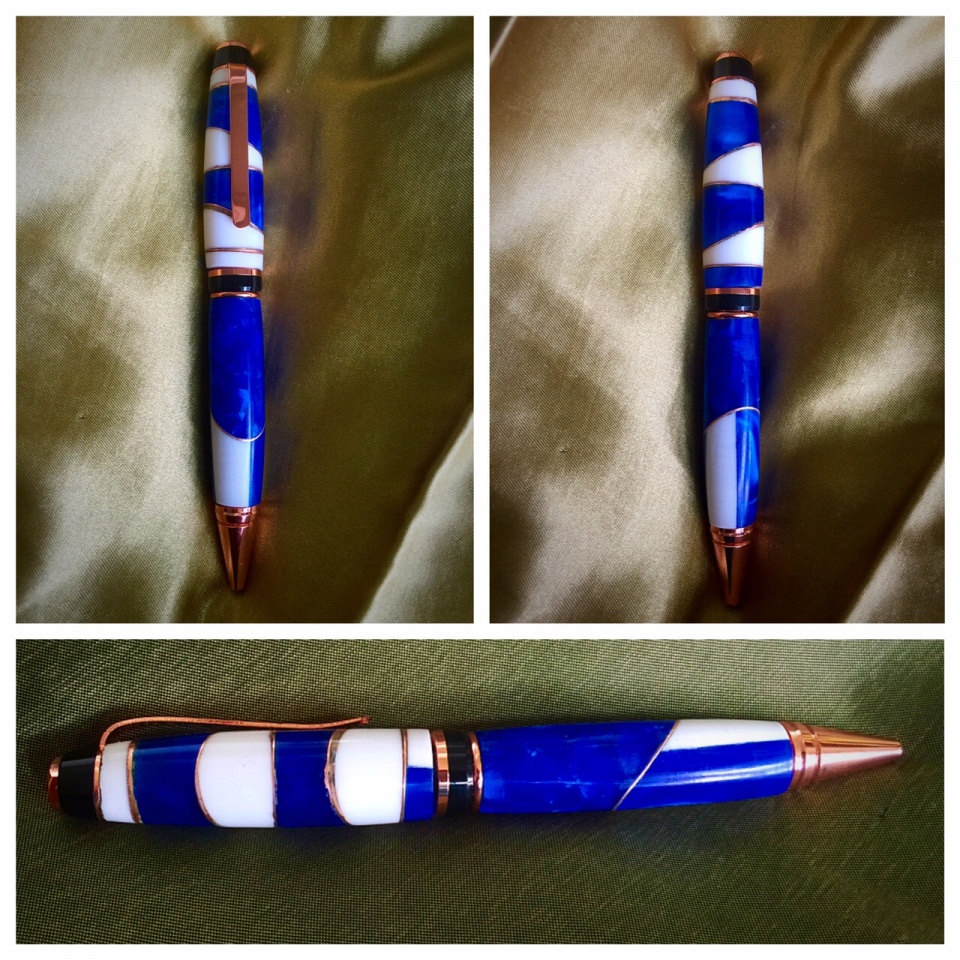

A finished product
Here is my first copper laced pen. Boy that copper is HARD! But I think it came out good!

Real nice , cause I have a soft side for copper ,what size (thickness ) was the sheets
