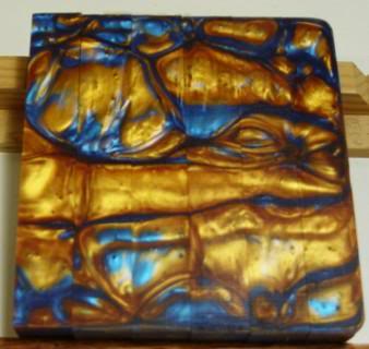

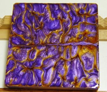

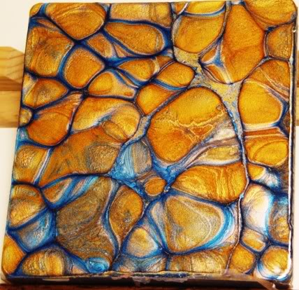

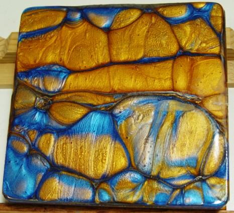

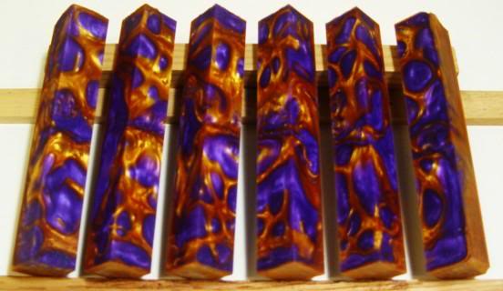

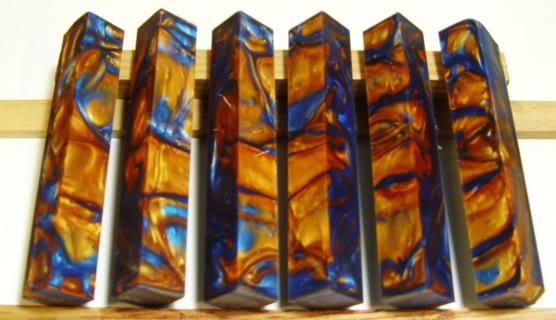

So I was getting ready to do a custom 100 oz cast when a bunch of things went wrong (I won't go into the details) and I ended up making some resin only slabs. Here are the results of my screw-up. If I could only remember now all the things I did wrong and the sequence so I can repeat them.
Whadayathink?

You've got a "recipe" for disaster, yet you will be able to sell these for a small fortune. Will make some awsome pen blanks and the like.:)
Buzzzz4
Dec 7, 2008
2,761
Grand Rapids, Mi
Looks like the Alumilit was poured at the thickened stage as if you were pouring taffy. I've had something similar, but it looks much cooler with those colors.
Yes and no; part of the resin was thickened and part of it was liquidy (is that a word?)

They look great, but I don't see where anything went wrong..all my blocks look like that.
Well,it did not work for what I was attempting to do but I agree they turned out interesting.
I wonder what they're like once you cut into them. I like the blue/gold ones myself, very cool colors.

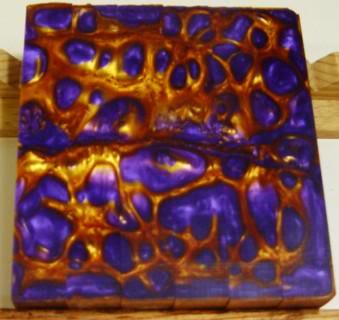

Here are the blocks sanded down and cut up.
This is the purple and gold block;
This is the cobalt blue & gold block;

Wow, those look really cool!
I don't know anything abuot casting ... but ... I wonder if you poured one color into the other color and there was a big temperature difference between them? So one flowed nice and the other was lumpy? This would explain why where the colors meet there is a darker area where they have mixed.

Yeah, that first block is as close to a "resin burl" as you are going to get. Looks like real burl!!They look spectacular!!!!I will also take one of each:biggrin:

Looking more at them, was the purple thicker or the bronze? It looks like an alien creation.
Yes and yes; for the purple and gold there were 4 mixes; 2 purple and 2 gold. Those mixes were 1 purple and gold of the fast setting alumilite and the other purple & gold of the slower setting alumilite.

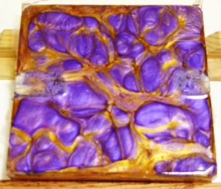

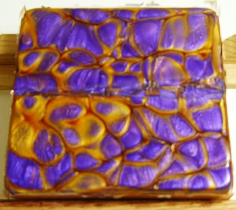

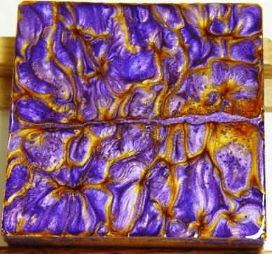

Oops, I did it again (I think)
The kid and smart A in me says "cool trick mister...but can ya do it again?"
The caster in me says "Holy _____ those are COOL!"
So I was wanting to see if I could replicate the earlier casts so I gave it a try. Here are two more blocks in raw form:
Close enough?

What happens if say, you cool one of the Alumilite mixes before the catalyst is mixed? Would that allow you do some some interesting things with a "warm" mix into the cool mix?

Yes, it will. If you use cold and warm mixes you acheive a similar effect as using the slow setting and fast setting resins but the "sweet moment" is a bit harder to predict (al least for me it was) and also the two colors end up with less separation.

So I'm kind of confused. Obiously you mix the 2 colors and let one thicken, but then do you pour the thicker one into the thinner one? Or the other way around? Basicly whitch one do you pour into the mold first? Thanks in advance.
ElMostro
Mar 17, 2007
1,940
San Antonio, TX.
You pour the hot one first then the cold one on top. The heat from the bottom resin makes it rise in the shape of large bubbles through the top cooler resin giving you the "LavaLamp" effect (ericjs came up with the name). The larger/deeper the pour the better since it gives the "bubble" more distance/time to travel through the cooler resin. The key is timing it right, pour too early and no effect...pour too late and no effect.
