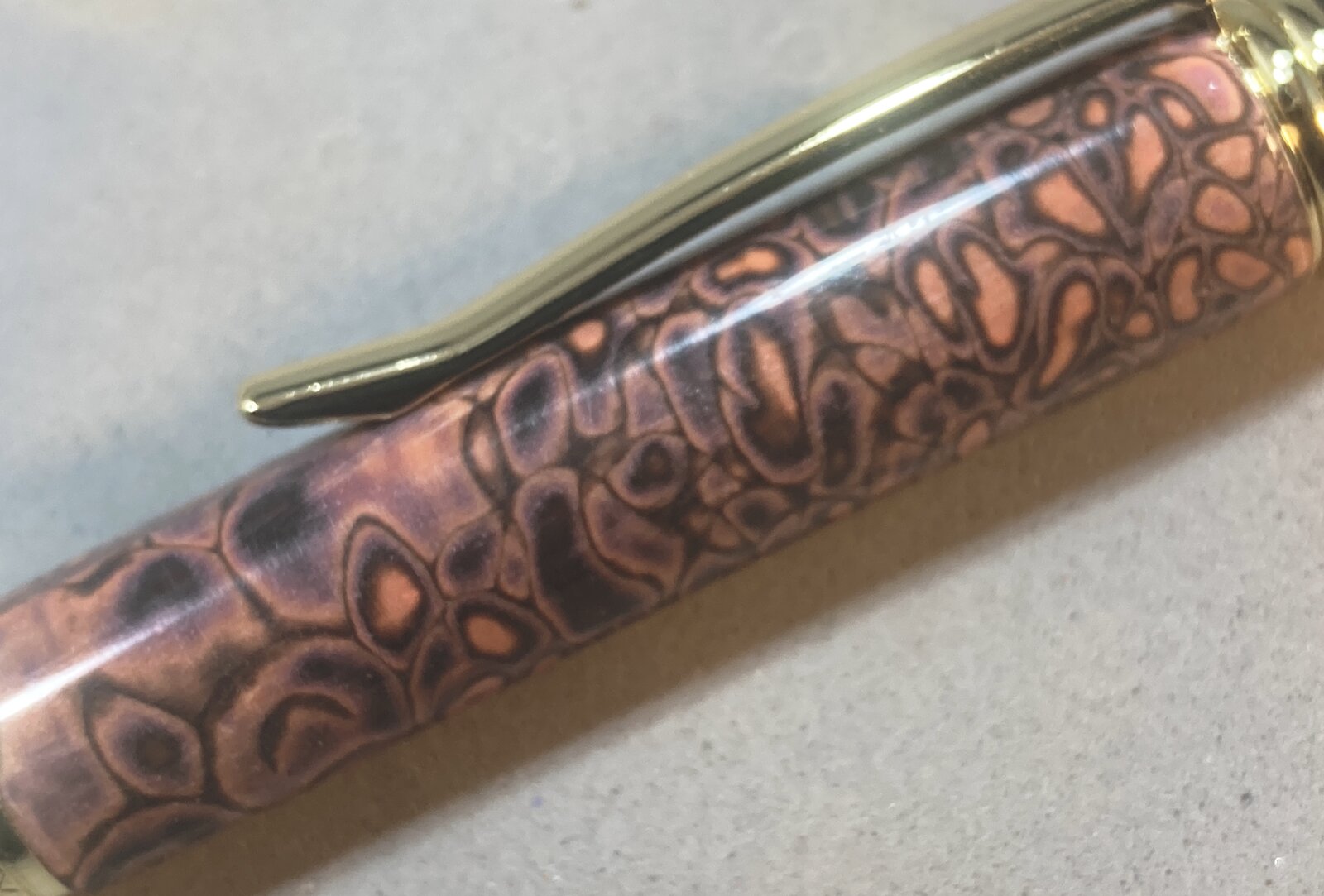

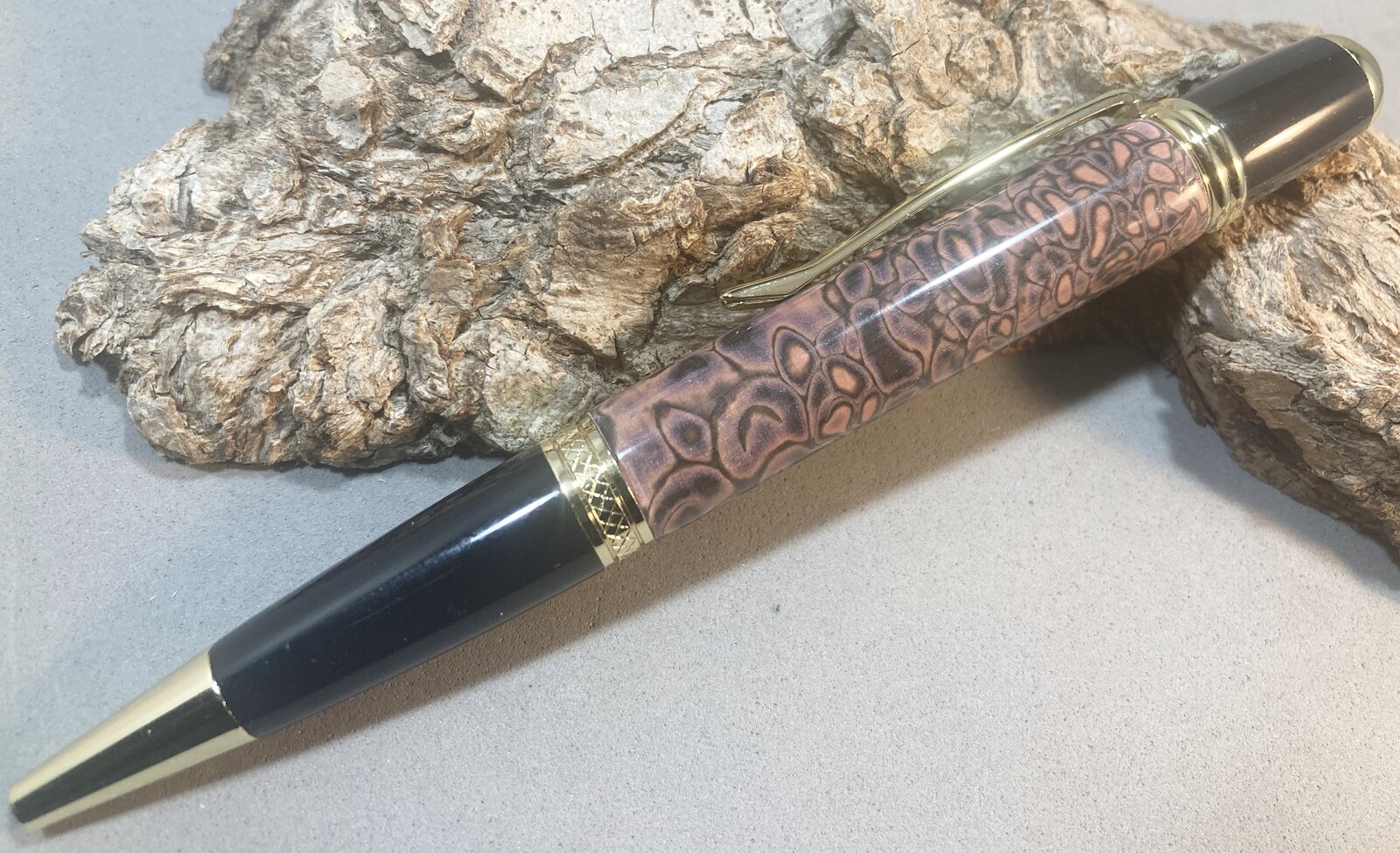

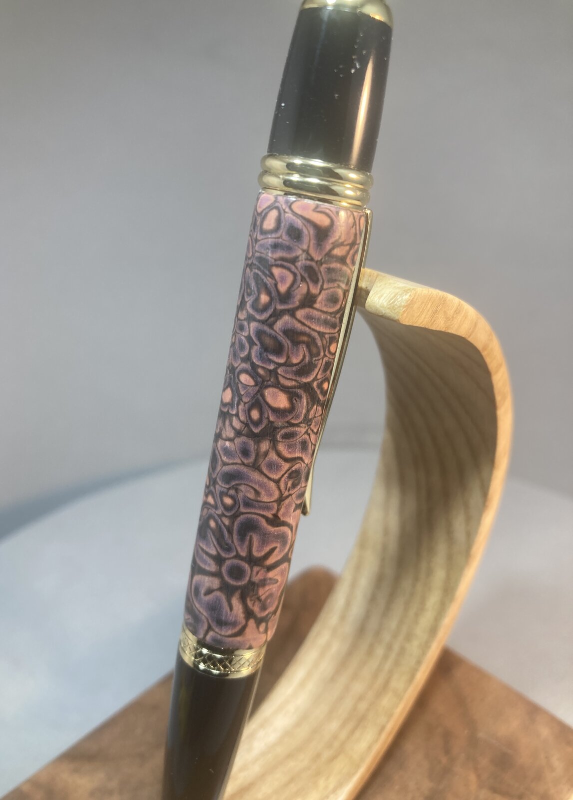

Well, this pen does not look like much, with muted colors and bad photography, but It was incredibly fun to make. I found a YouTube video on a technique called "Controlled Mokume Gane", and when I watched the video, my jaw literally dropped. It was SO COOL. I'll put the link at the bottom of this post for you to check out.
How on earth do people invent this stuff? But, the beauty of this technique is that although there is a learning curve, it's not too steep.
This pen is a bit of a mashup, because the cutting/embossing tool that I used (a floral cutting die) was not large enough to cover the little sheet of clay I made, so I pressed the die into the clay multiple times, which created a lot of overlap. I didn't really care, because I was really wanting to try out the technique of using a thin clay cutter to literally filet the clay sheet, removing parts of the top layer, exposing different colors in the layers below. That was amazing.
I went out today and bought some more vivid colors of clay, and a new embossing roller, so I hope to show a much better pen in a couple days.
I mentioned last week that the pen I made using pre-made canes did not really feel very "artistic" - but this pen has opened a new technique to me that is going to be a lot of fun to experiment with. Thanks for reading!
