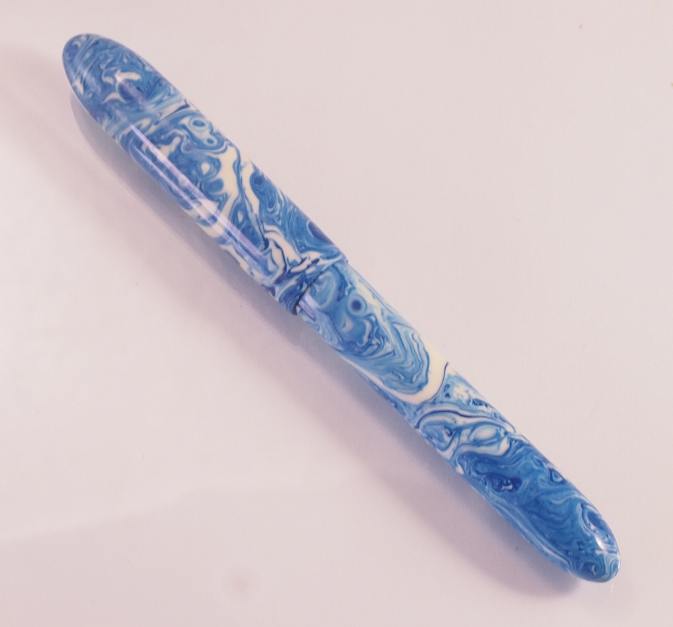

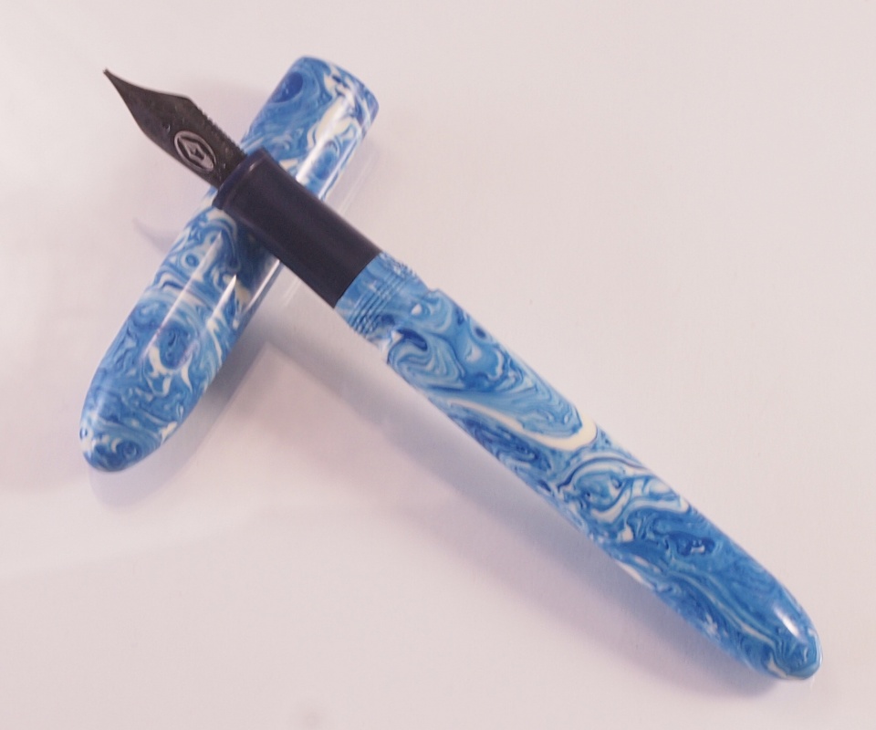

I would like some constructive feedback on the shape and proportions of this pen. Any suggestions for improvement would be greatly welcomed. I plan on adding a roll stopper later. Thanks
Very nice pen. The cap seems a little wide (in diam., and even wider at the top) and long in length - from the photo anyway. I do think it is definitely one to be very proud of.
Thanks Tony, the wall thickness is only about a 1/16" of an inch so I don't think I can make it any smaller in diameter plus the diameter is uniform up to the point where the taper begins. I think the photo may be causing you to think that the top is larger. I agree that the top seems too long but I cannot shorten it if I want to keep the tapered end. The solution may be to lengthen the bottom.
It maybe the picture but it does seem bulky. I am also not a fan of the round or pointed ends. I love it when people either square the ends with an accent piece or angle them somewhat. Gives the pen some flare. Yes the big companies make pens like that but I am not a fan of them either. Just an opinion . Nice material. :smile:
Cody, good for you for asking. Look for answers that echo any "little voice" that is urging your to question your choices. Acknowledge it and decide if you agree....and then just make em like you feel em. As a craftsman and artist, your best choices satisfy your own taste and style. There is ALWAYS someone out there that will agree and want to own your vision. Just as there will ALWAYS be voices to challenge your own. Your pen is impressive as presented, and is a clarion of your creative heart and soul.
I prefer the squared and angled looks as well. The tapered look seems very popular and I wanted to give it a try. The bulky appearance may be also be associated with the top being proportionately longer and the lower tube being on the slim side. The top is .577" in diameter and the bottom is .5" in diameter. I could make the lower end slightly thicker and longer and I think his would make the overall effect more proportional. I really cannot go any thinner or shorter with the top with the taper. Thanks for your comments.

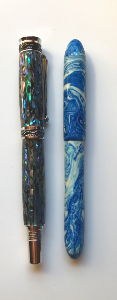

Here is a photo of the pen side by side with a Jr Majestic. The tops are almost identical in length. Diameters ar very close as well, the only difference is that my lower tube is slightly shorter.

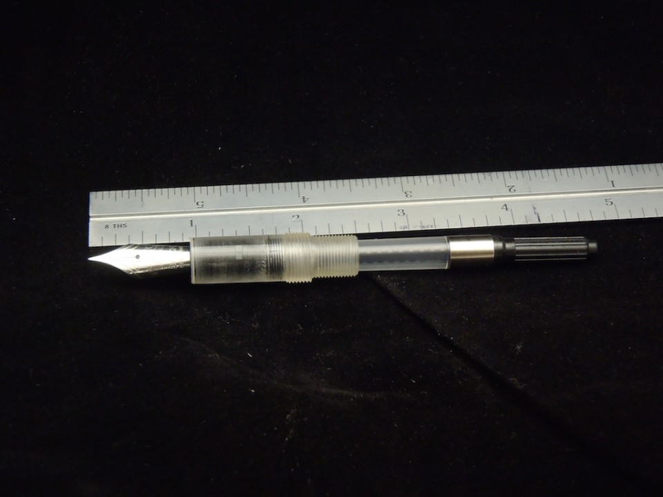

You could as an alternative to making the barrel longer is to make the section and cap shorter. Denis Soligen, can't remember his IAP name, made his pens with the cap threads on the section. That's what was done for a Collaboration pen our group did a few years ago. A picture of a proof of concept section I did to make sure I understood how to make it. It was for a Bock #6 feed.

I've made a couple of pens with the cap threads on the tip of the section (one pic attached). It can work, but there's a chance of the section unscrewing from the barrel with the cap still screwed onto the section :rolleyes:

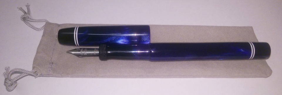

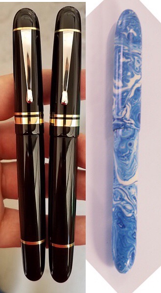

In addition to the above comments, I also favor some accent rings like what Jonathon Brooks and dunscuss included. As to the profile tapers, the ones displayed by dunscuss look very appealing.
However, for a "proof-of concept," your skills are growing in leaps and bounds!
With apologies to Jonathon, I downloaded his photo and spliced it side by side with my pen. While this photo highlights how far I have to go to be a high quality kitless pen maker, It supports my conclusion that increasing the diameter and length of the lower portion of my pen would help my proportions. Adding accent rings and a clip is on my list of things to do to advance my kitless skills. Thanks for the constructive feedback.
