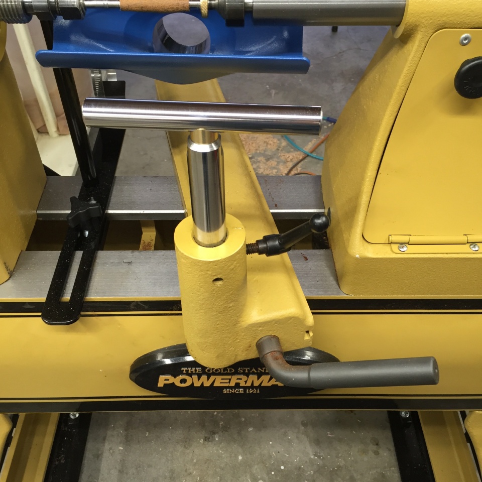

Prepping the Powermatic P2020...
I haven't been serious yet about turning on the new P2020, but have been prepping it to make it more 'user friendly' for me.

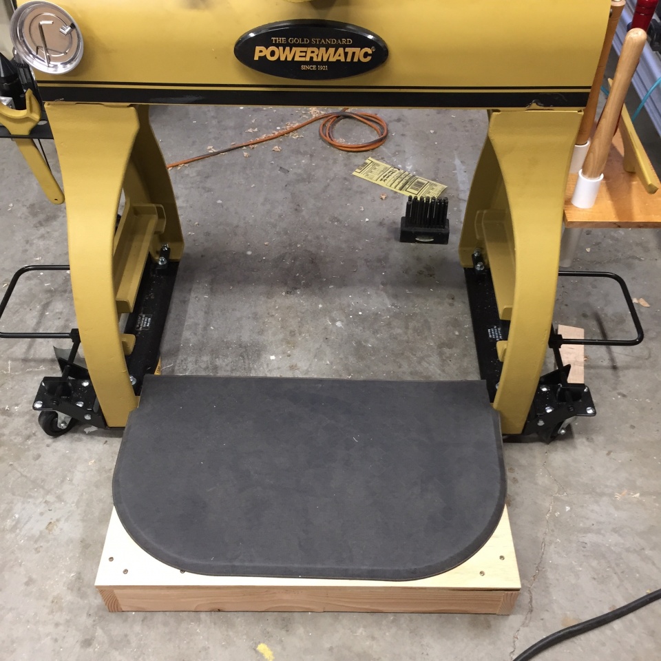

First off, I am 5'7" and the lathe stands a bit too tall for me. I understand the the ideal height is 'crook of the elbow' for the drive centers. Accordingly, I built a 'make Warren taller" box. As you can see in the picture below, it has a fatigue mat on top. I find that helps keep my feet happy when I turn.

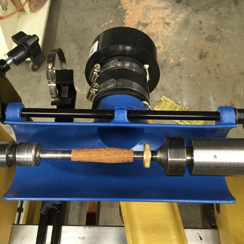

Second, the dust collection I had for my Jet 1015 would not work on the Powermatic for many reasons. After some research, I bought the Rockler Dust Right Lathe Collection system. I had to have the part that fits under the ways fabricated for the larger lathe, but it works quite well.
Third, I needed a smaller tool rest, and bought one from Rick Herrell. As you can see in the picture, it is a work of art! WOW!

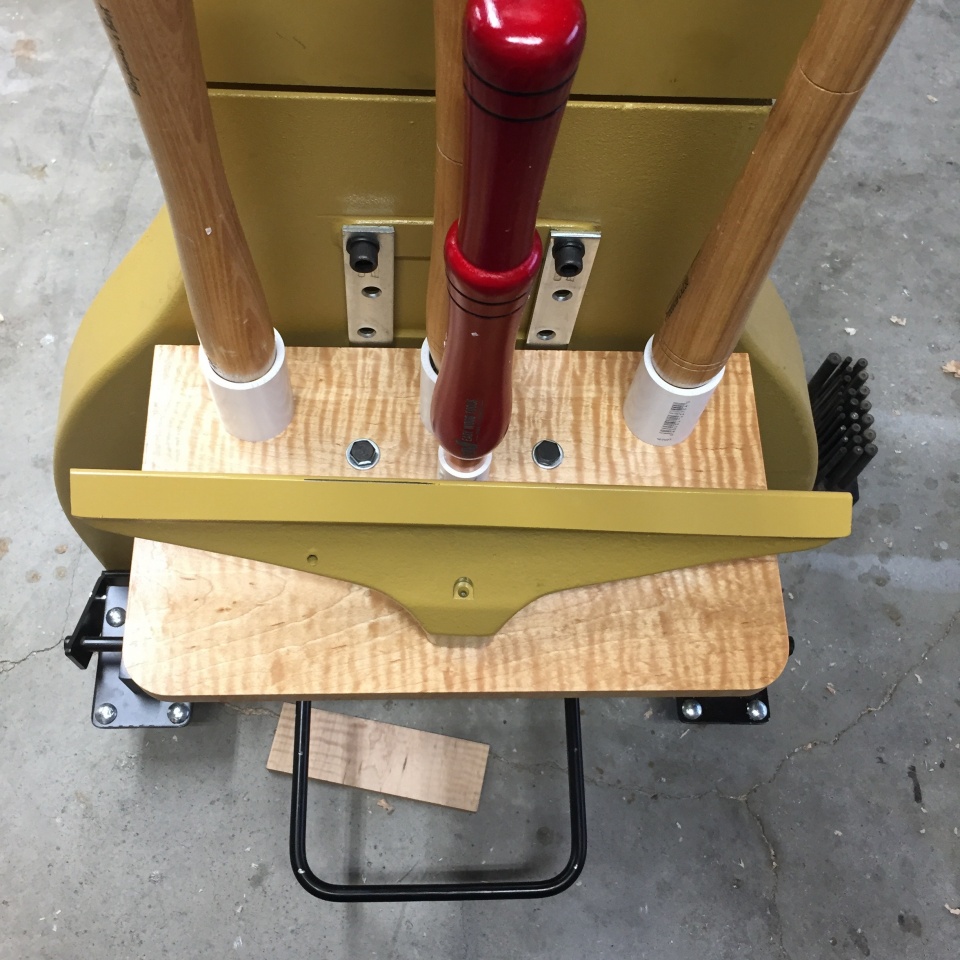

Fourth, I needed some additional external storage for odds and ends, so I came up with something I could add to the end of the lathe.
All I need to do now is work on more tool storage under the lathe. I thought I could get that done today, but I bit off more than I could chew in the time I had this afternoon.
