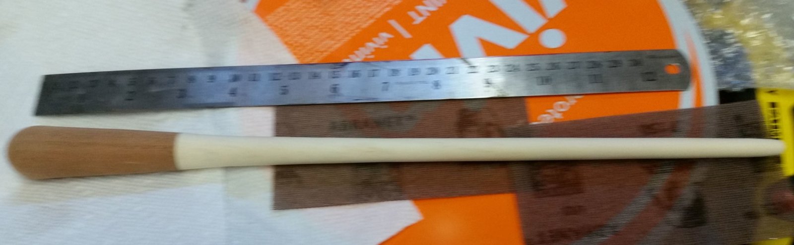

I've made 3 batons. I used holly for the baton itself and different wood on each baton for the handle. I used a 12"x1"x1" holly blank and half a pen blank for the handle. I turned a 1" tenon on the holly and drilled a hole on the handle to match it. Glued them together then let it dry overnight. The next day I turned them as one piece. The holly was nice and light weight. Attached picture with ruler shows dimensions.
