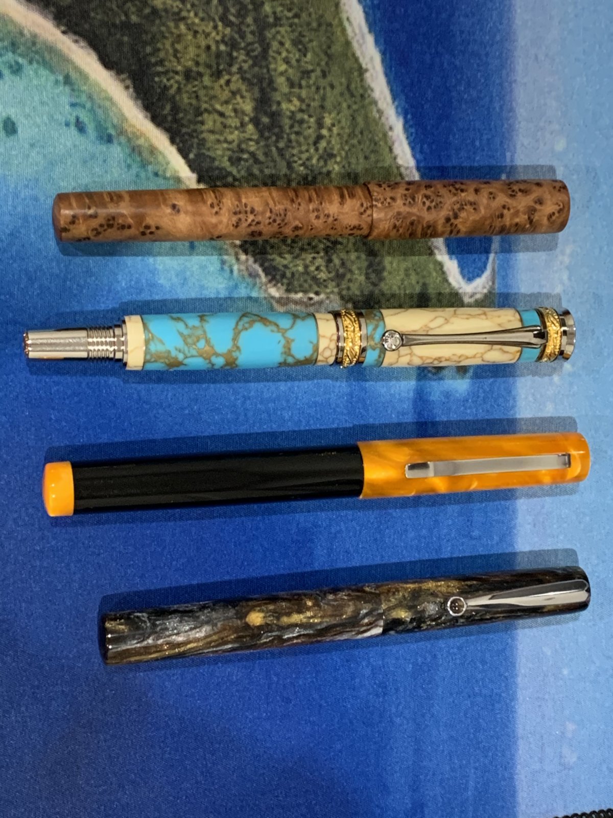

Photo of Jr Majestic compared to kitless pens made with M12 x 0.8 mm tap and die for body to cap.

like the burr one on the top and the orange and black one draws my eye in as well.
any more photos of those two please?

Danie - that is just what I was looking for! For the bottom pen, it looks like a Diamondcast blank, can you provide some more images or details on that? I like the style of the cap and body being the same diameter and would love to see more of the detail on how you did that.

It was shown in this post.

Danie - thanks for the link to the other thread. That looks amazing for your second kitless! It's also almost exactly the same style of pen I want to make, both RB and fountain. Definitely helpful to see the additional details on that.
