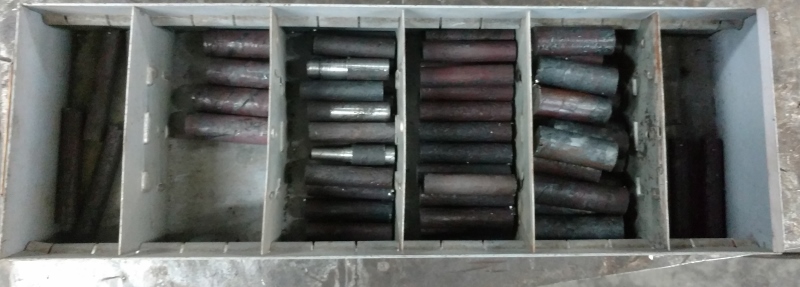

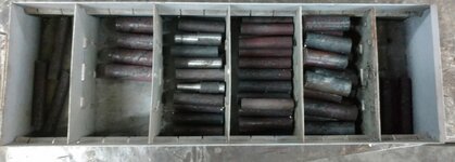

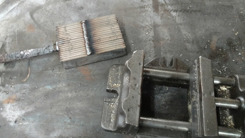

Hi all, I know its been a while but my 13" lathe is still down with a shattered thrust bearing and 0.030" wear on the journal. So i'm using a friends heavy 10" south bend to turn the blanks. However I still made my largest Damascus billet yet (a 40 layer, 15 lb hunk of steel) It measured 6"x1.5"x4". I forged it out to 0.750" dia. rods 24" long and made 3 of them. that equals 6' of pen blanks, and I had 4' of 9/16" left over from my last billet. so some may see just cut steel in the 2nd pic...I see 2) broadwel scepter fountain pens, 4 bolt action tec pens, 4 buffalo pencils, 8 breast cancer twist pens, 11 trim line pens, 8 slim line pens, and 1 led flash light. more up dates coming soon.

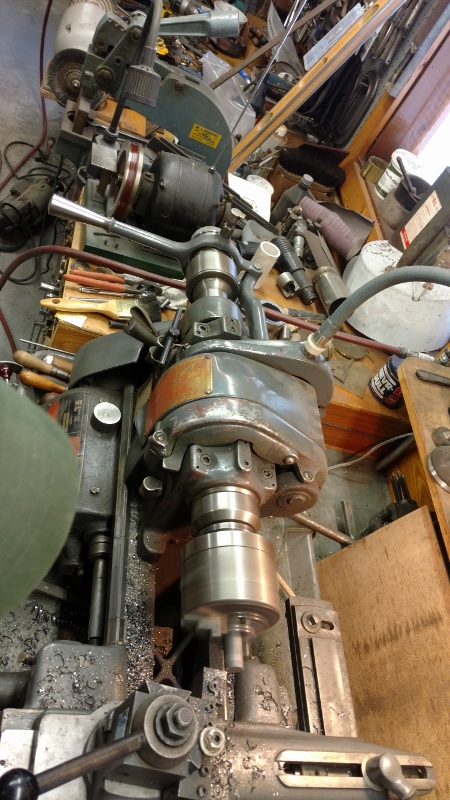

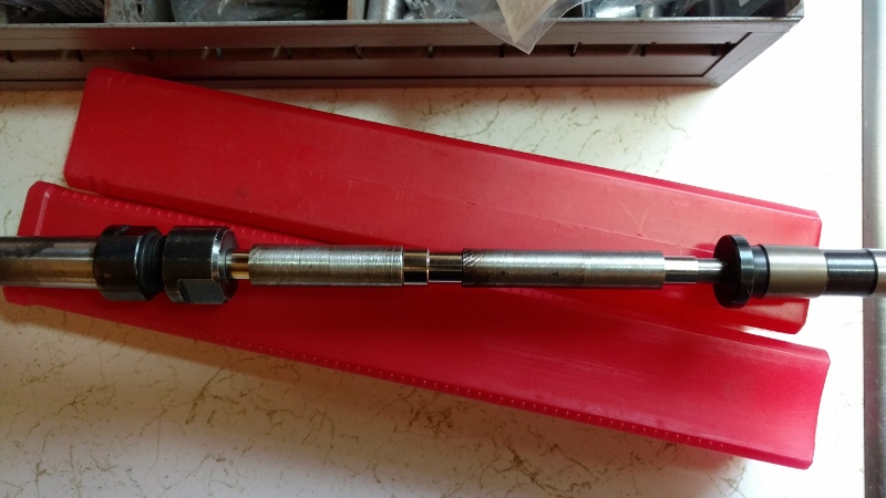

Ok, so I spent 5 hrs at my friends shop and used his heavy 10" I turned all the blanks for the breast cancer pens to the major diameter and bored the ctr for the brass tubes. Witch brings me to this point. even though the instructions say to use a 8mm drill there is too much play in the fit. I used a micrometer and the tube measured 0.302". that's 0.013" of sloppy fit. so I used a "N" bit then reamed the bore to 5/16 which provided a tighter fit. the same went for the 3/8" bore, I ended up using an "U" bit which gave me almost a press fit. Now the blanks go in the mandrel and I will take the last 10-20 thou with my files. THX for reading my posts Hope you find some use out of them. If anything you can laugh at my methods.
