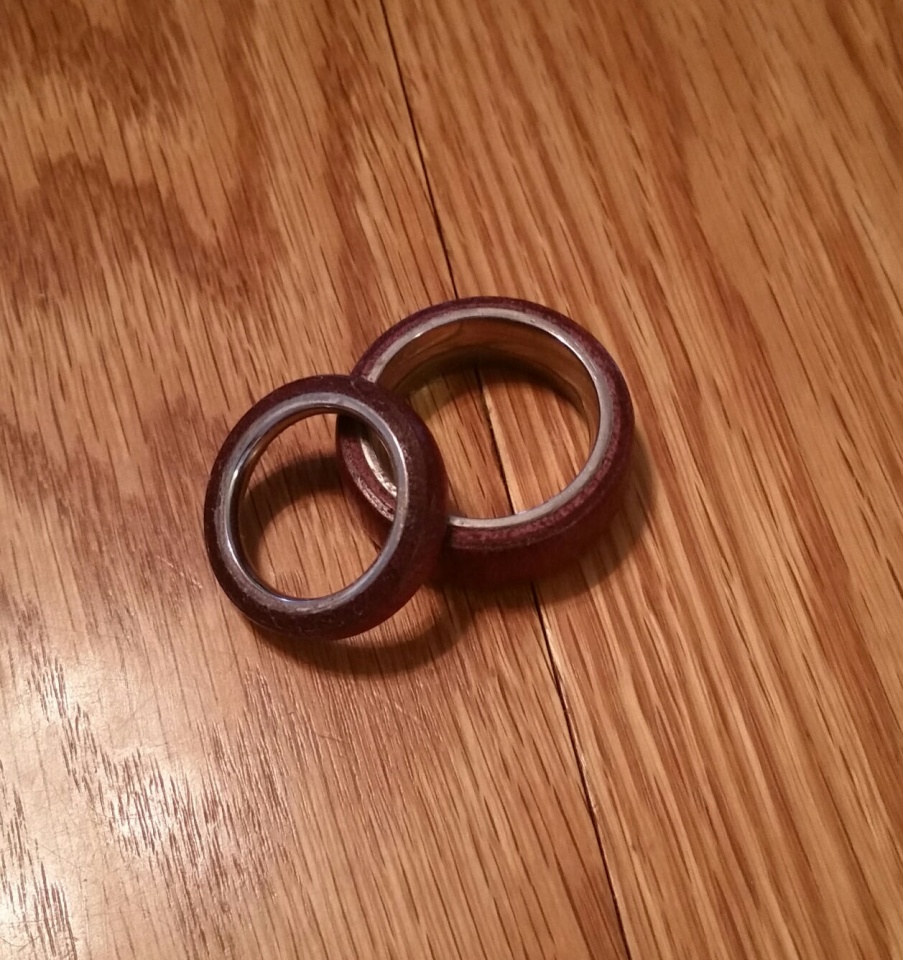

Here's a post I placed on the thread "Hollowing Rings" below:
I made the attached pair this weekend. In fact I made both of the twice. I drilled a series of Forstner bit holes in a waste board and tested the inserts for fit. I used the Forstner bit closest to the right size for each ring insert to bore the holes on the lathe after I turned the blank round. Then I took it off the lathe and used 80 grit sandpaper to get it to the final size I needed. I was using Purple Heart rather than one of the stabilized woods or synthetics. That's what the customer requested. One was a 10mm ring and the other a 3mm ring.
The first blank for the 3mm ring broke in half when I took it off the double sided tape. Let the glue dry for 48 hours then turned the rings. Turned the 10mm ring first. Had it almost down to size and was going to make one more tiny shaving pass when the blank shattered. Turned another one and glued it the insert and let it dry while I turned the 3mm ring. It turned easier than the 10mm ring for some reason. By the time the glue was dry, I was ready to turn the 10mm again. Customer was happy. Waiting to hear his wife's reaction. They are a surprise.

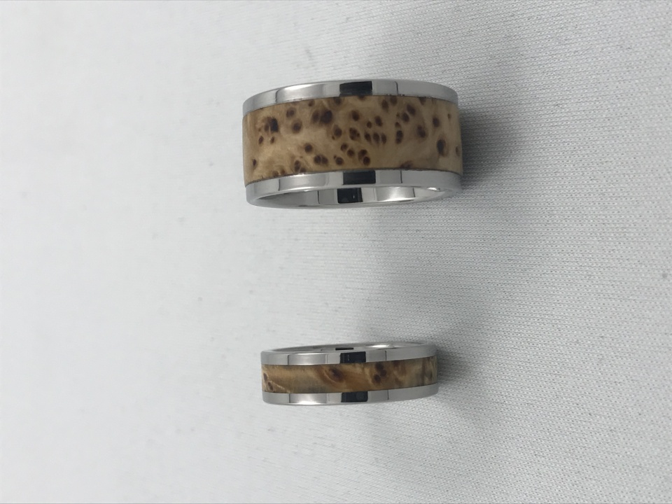

If you need tutorials I have some, I make the 2 piece cores also see my Facebook page @ringandmandrel
