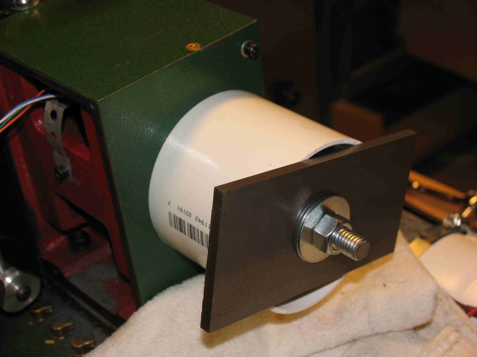

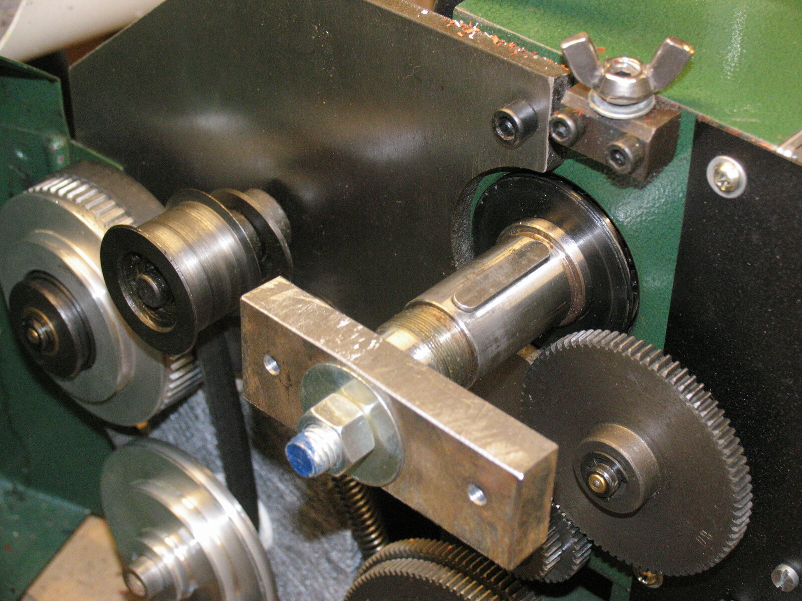

You can remove the spindle; I've done this on my metal lathe. These two photos show how I pulled the spindle out. The PVC is a coupling I used to "stand-off" the end where the spindle came out. But this is my metal lathe, so yours will be slightly different.
