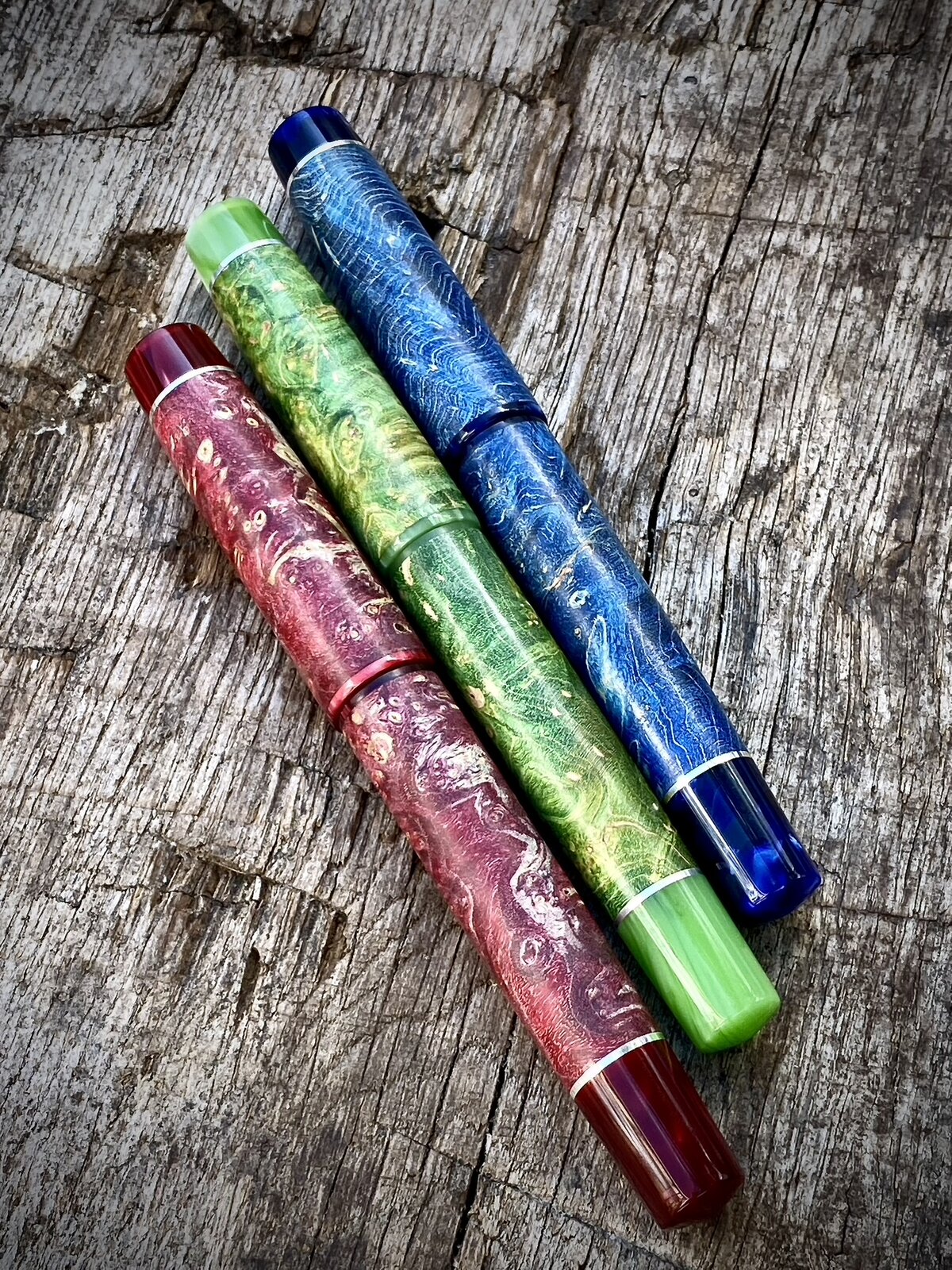

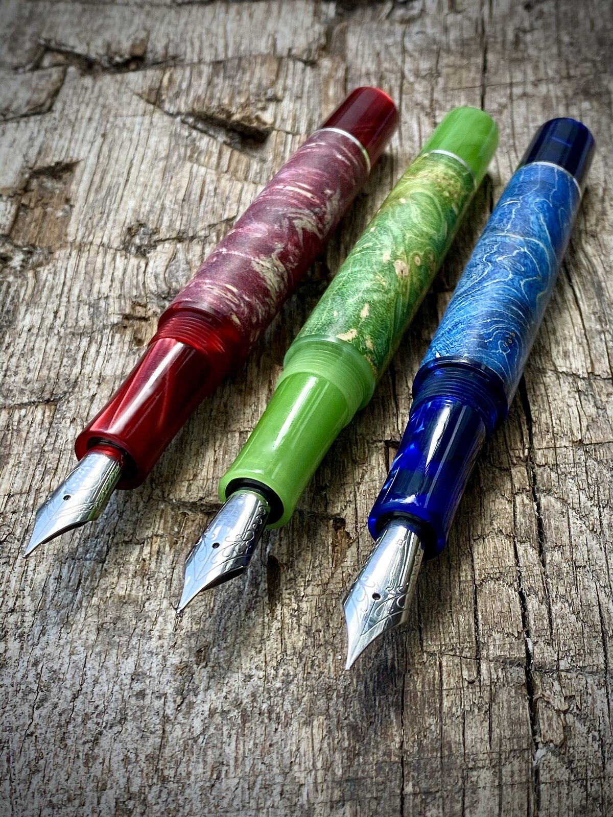

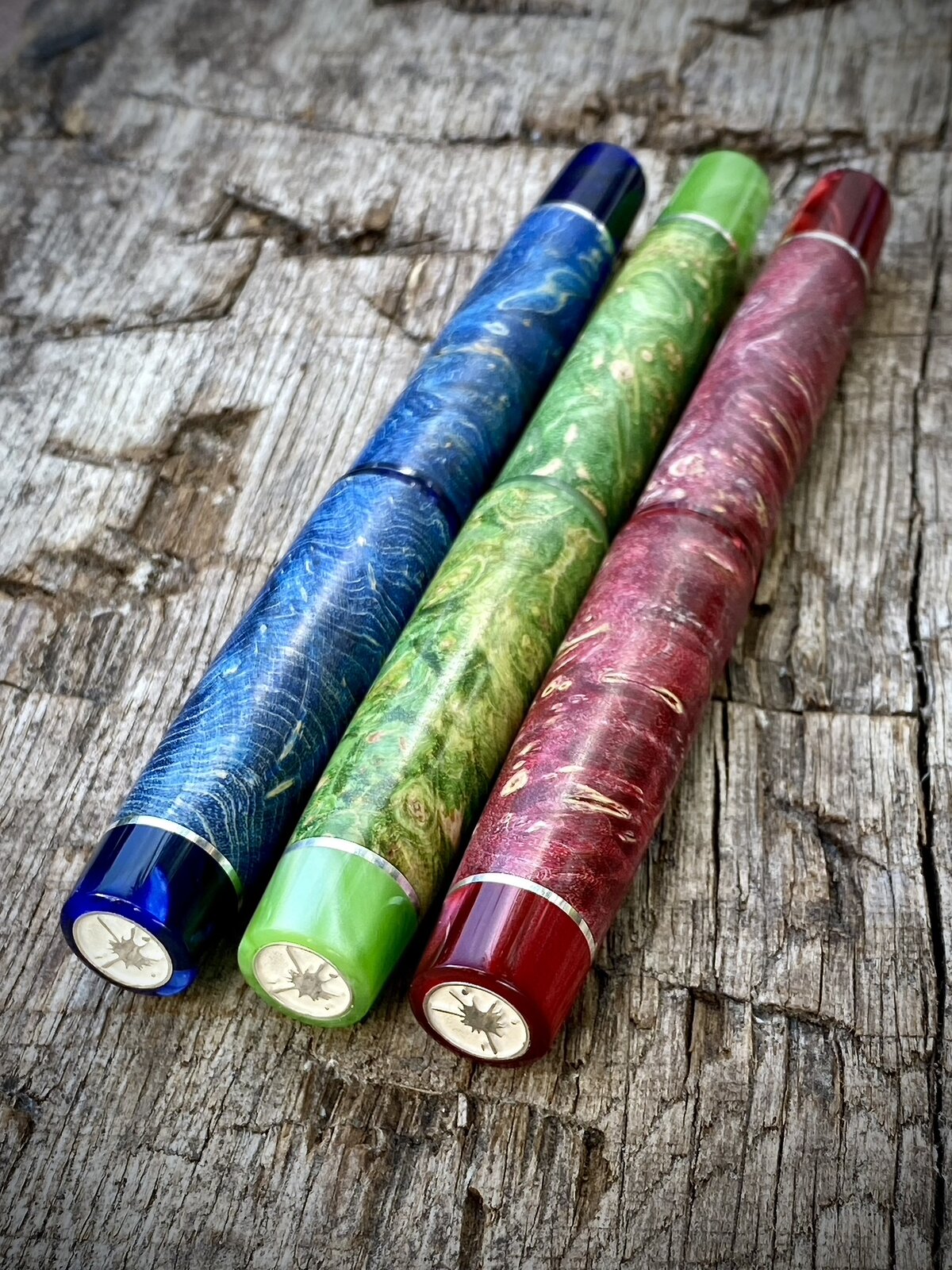

Isn't nature amazing? To think that this maple burr grew out of the ground in these amazing vivid colours. It's almost unbelievable.
I rarely have groups of pens in my possession at the same time so I took a family shot as I thought they looked pretty cool together.
I've paired them with matching acrylics (and cellulose acetate for the blue one), which is also used to fully line the caps and barrels. Sterling silver finishes the pens which are fitted with both Bock (red) and Jowo no6 nibs.
13mm triple lead cap threads are used for each.
(They are all dyed and stabilised).

Nice family photo of that group. I like the way the acrylic colors match the burls and the way the Sterling accents the difference in material.
Excellent color matching! Beautiful work!

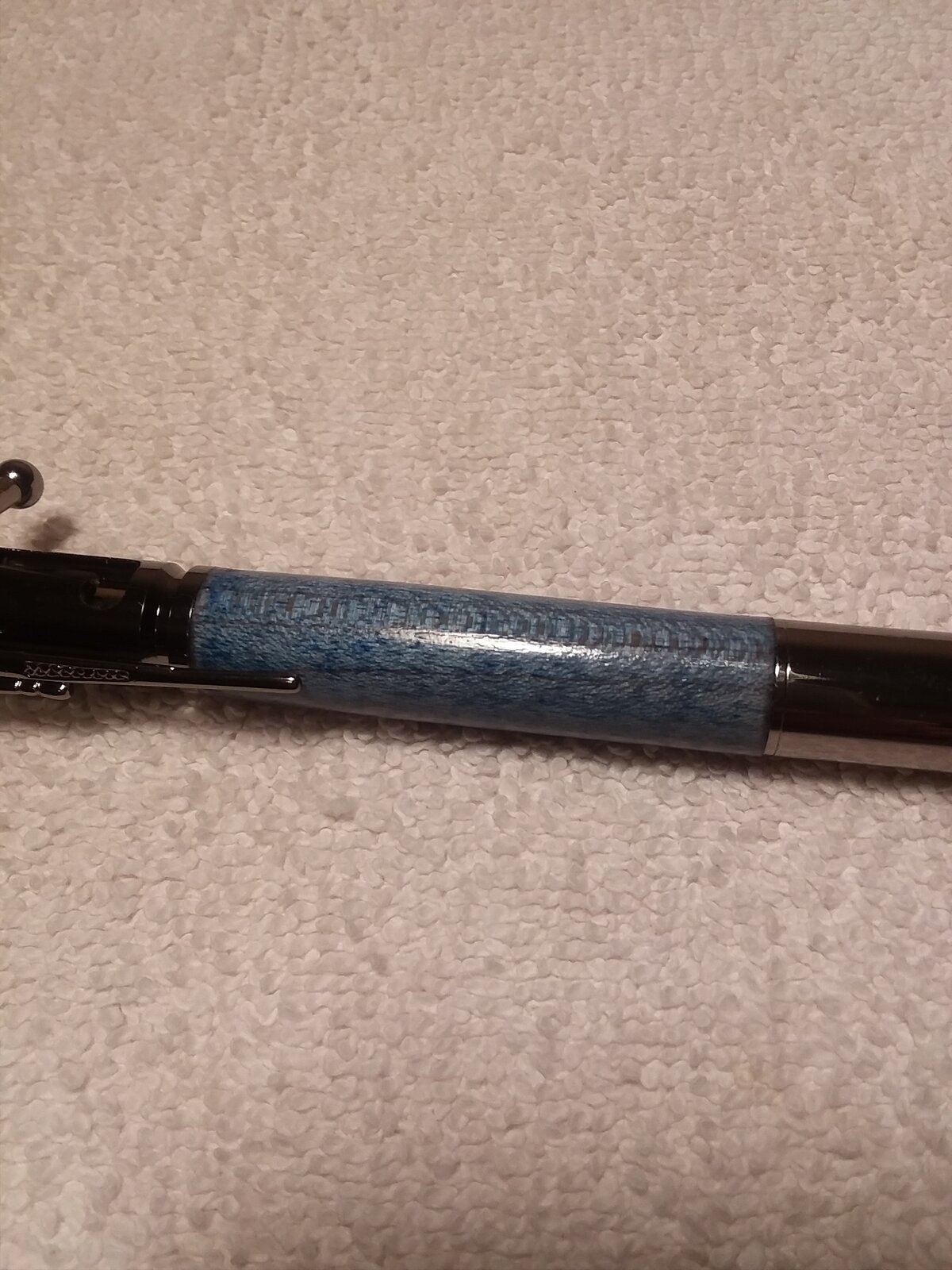

I turned a blank of light maple from an old cutting board. I colored it with a black Sharpie with several coats to fix the color. Found that only one was needed. Turned out decent. I'll see if I can find a photo. Found it and looks blue in the photo. Different colors of Sharpies could be worth trying.
