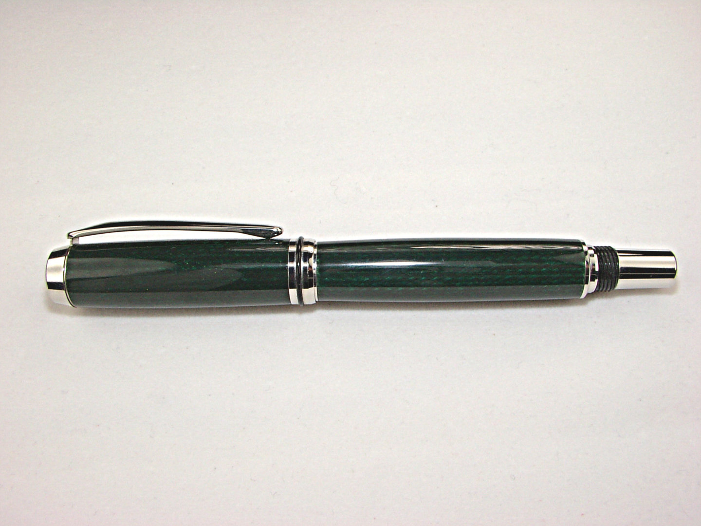

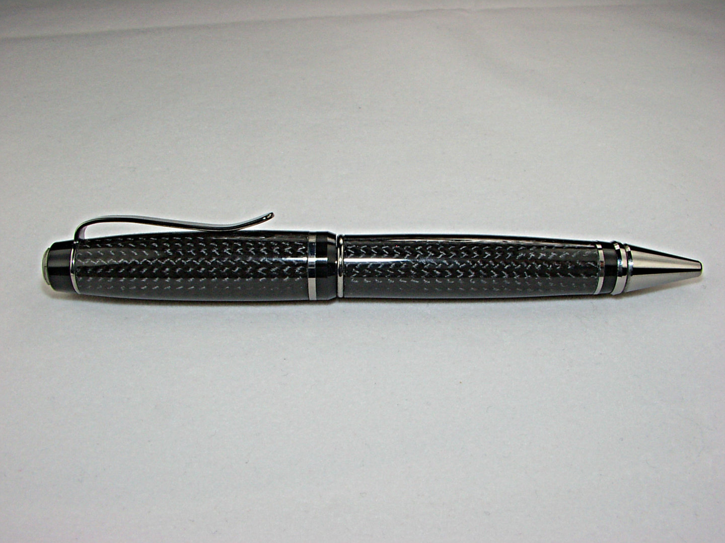

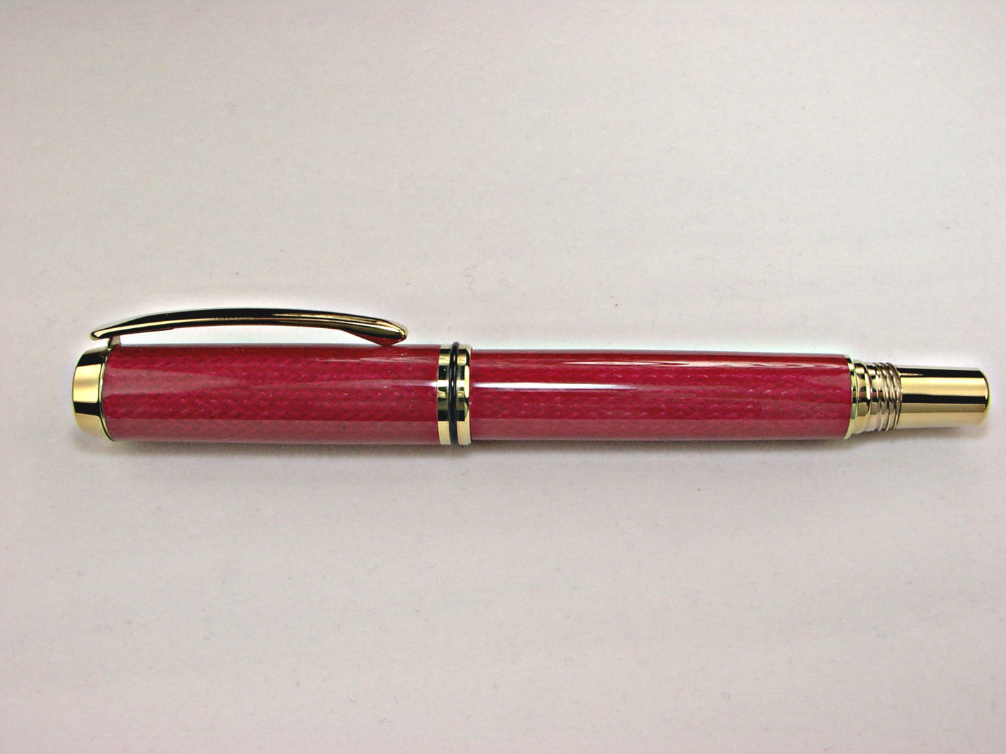

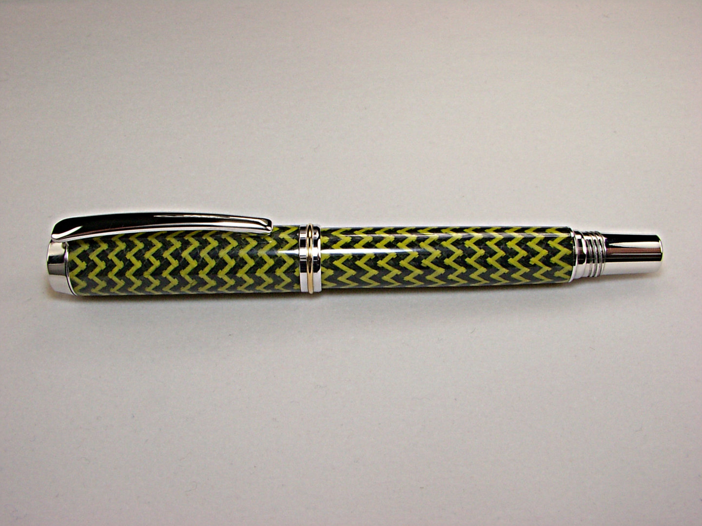

Carbon fiber sleeves are used alot with cast watch part pens. It comes in colors. here is red, green, black, and bumblebee
oh ok. I did a quick search but could only find it in black. Do you use it on it's own or place it over the tube? Where might I find it in colours?
