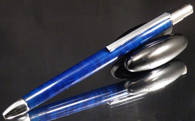

With food coloring you can just keep adding color until you get the shade you want . This is a piece of curly hickory with 2 coats of blue food coloring .

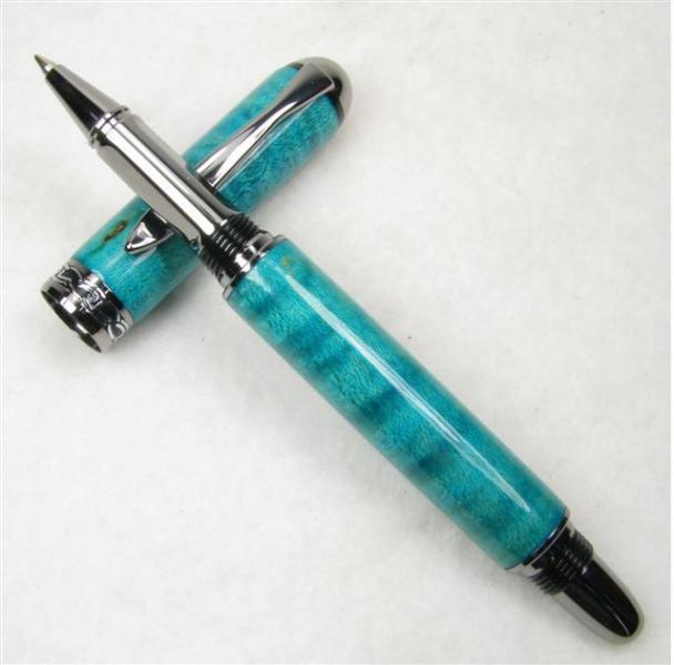

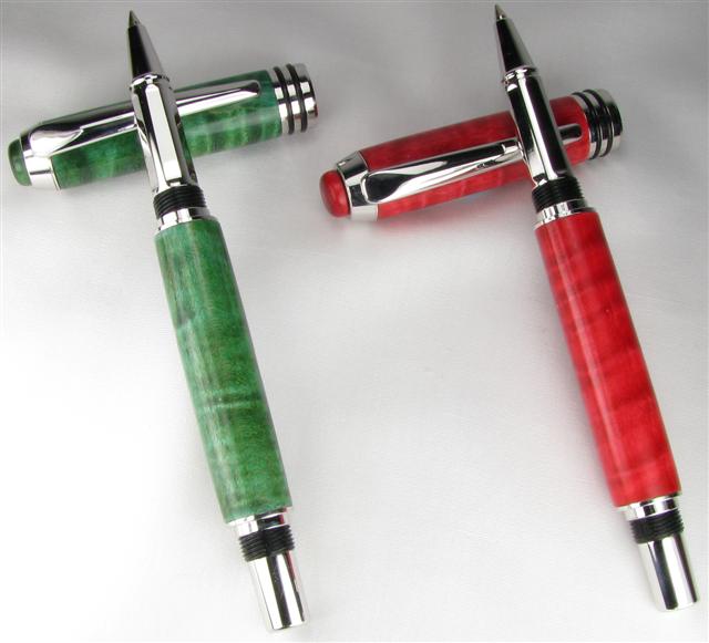

These pens were turned from curly hard maple. Then dyed, partially sanded off, then dyed again, and subsequently finished.
I utilize 2 types of dye, one from LV http://www.leevalley.com/wood/page.aspx?c=1&p=20082&cat=1,190,42942
and this from a Canadian Co. called Wood Essence https://www.woodessence.com/ColorFX-Dye-Concentrates-C12.aspx

Just drop a few drops on the blank (on the lathe , any speed) while spreading it with a paper towel . Usually 3 or 4 drops is enough per coat . Full color is reached with 3 coats (depending on the wood) letting it dry for an hour or so between coats . I find the liquid works better but some prefer the gel .

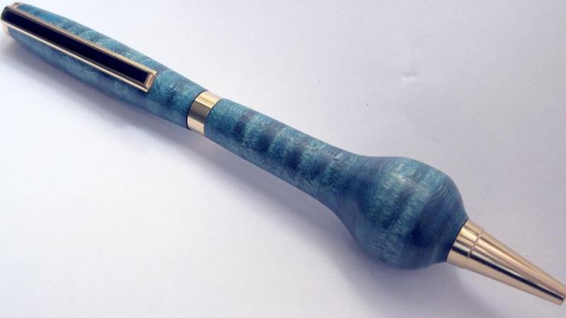

Here is a slim i did out of curly maple that i got from Oldfar.....I mean wagon (Todd)...
It has amazng curl, and I have never made an "Arthritis" pen, so i figured what the heck. It has two coats of blue liquid food coloring (Generic) I apply mine to the paper towel first and wipe on IMMEDIATELY. Two coats.

LOL... I forgot the photo

Very nice looking pens guys!

Further to my mixing and application process: the aniline dyes from LV can be dissolved in as little water as possible and then add the alcohol. (Isopropyl 99% pure) Stay away from that killer Methyl Hydrate!!
A mixture of less than 1 tsp. total will dye a lot of pens. I apply the dye with a small artists brush, painting it on till the colour doesn't change any further. I let it dry overnight, maybe sanding off lightly, and then I paint the blank again. The alcohol flashes off quite quickly, but I like to let the dyes set for a day or so.
The Wood Essence dyes are liquid. I mix them in Isopropyl as well and apply in the same fashion. A really good deal from WoodEssence is this one https://www.woodessence.com/ColorFX-Dye-Trial-12-Color-Kits-P51.aspx 12 colours for less than $50.00
