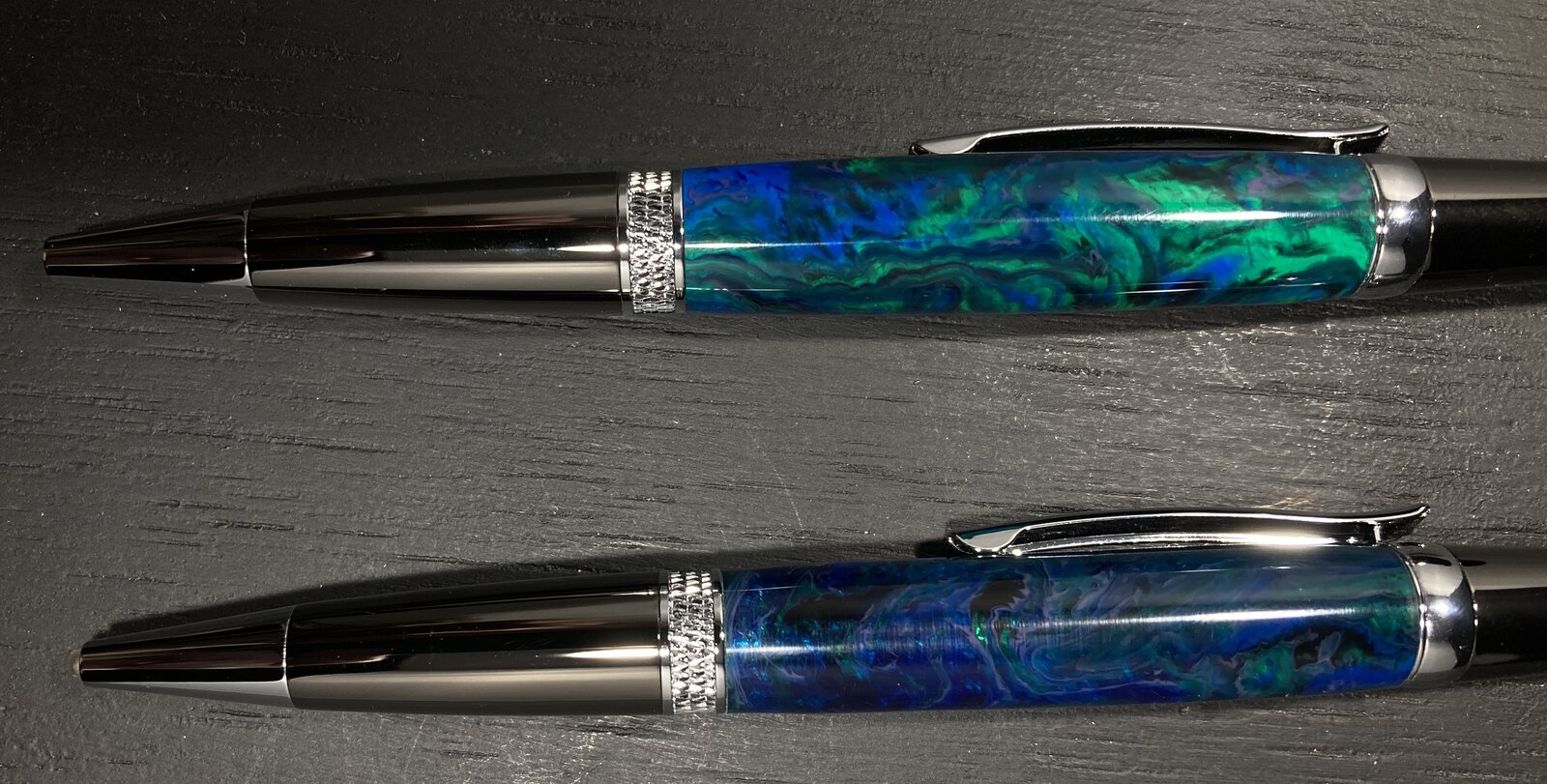

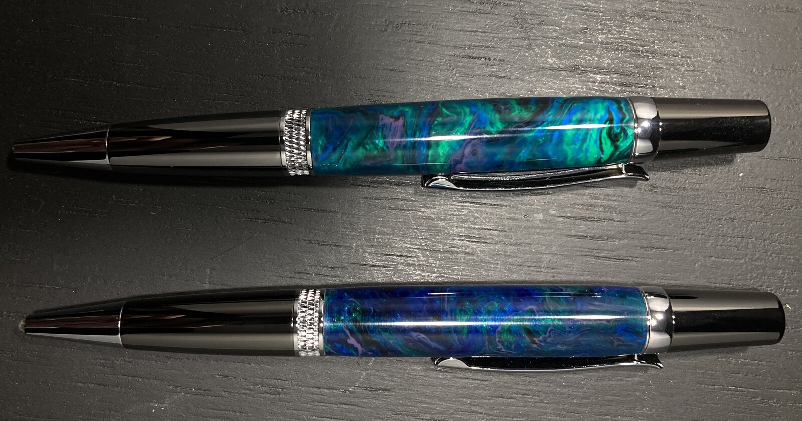

I have watched several videos on coloring tubes, to keep the tube from showing through. I wanted to do a quick experiment to see the difference in appearance between a pen with a black tube, and a pen with a white tube, using the same resin blank.
I cast some translucent resin blanks last weekend, then cut a blank in half, and made two Diamond Knurl pens - one that I colored the tube black with a sharpie, and the other that I colored the tube white with some acrylic craft paint.
I'll let you guess which pen has which tube.
I was amazed how much more vivid the white tube pen colors were. The black tube pen was still nice, but the colors are more subdued. The two photos are of the same pens, just looking at the opposite sides of the pens.

White reflects the full spectrum of light, black reflects almost none. So the vibrance of the upper blank makes sense. Even though the blank appears opaque, there is pretty much always some degree of translucency. Resins actually usually have quite a lot, so a white tube will bring out the full range of color.

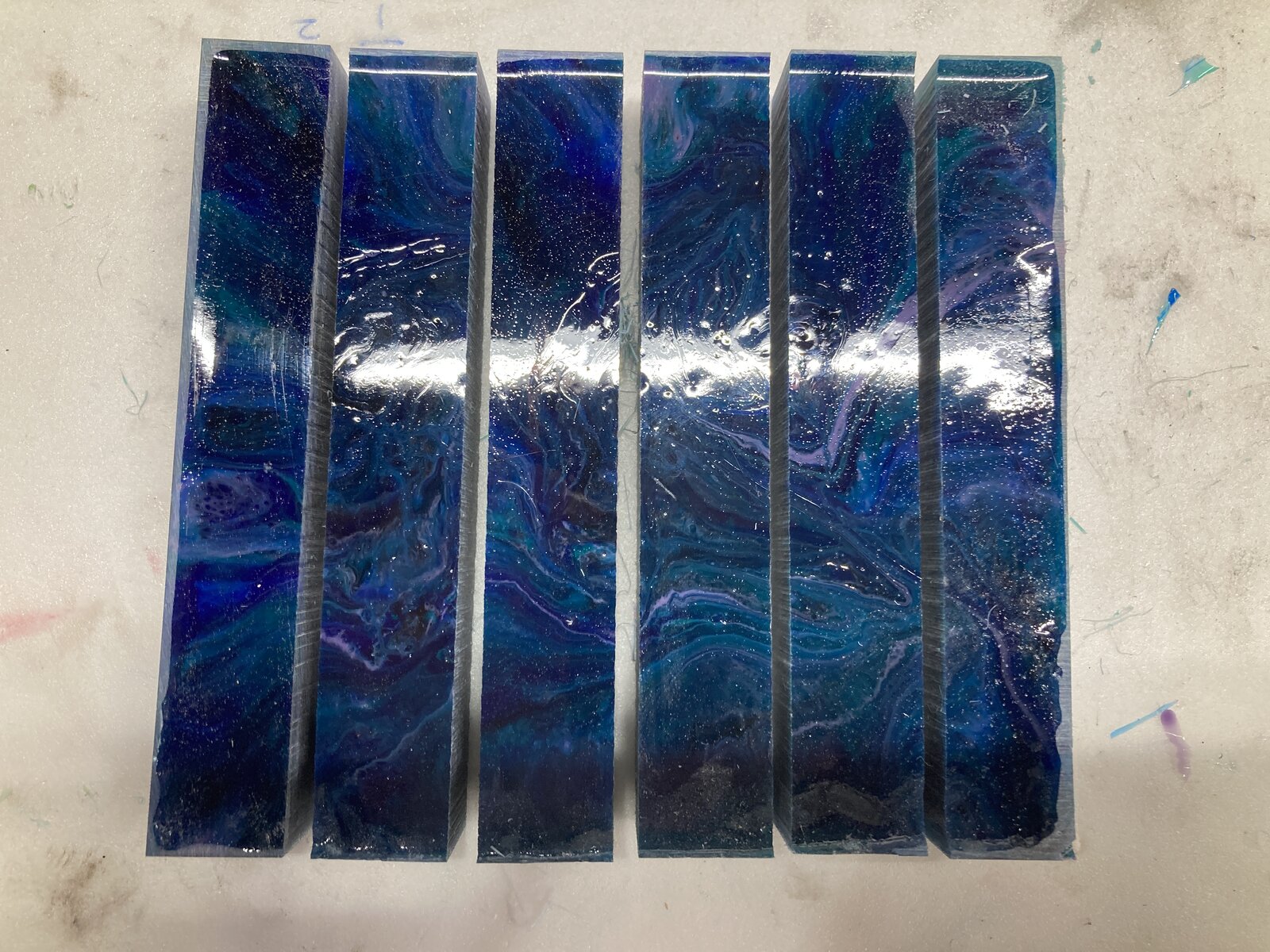

John, I did take a photo of the blanks I made from the pour. The photo is not the best, but you can see the 4 colors I used - deep blue, green, lavender, and black.
