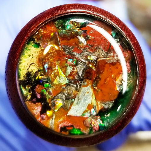

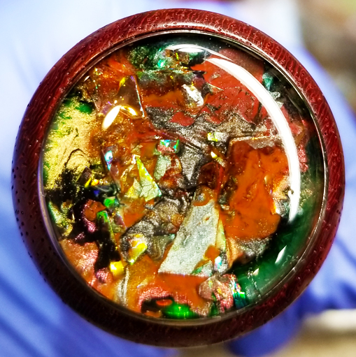

Ben - I like the ResinTints, and also use their ArtResin - nice control of transparency/opacity here:
https://www.artresin.com/products/resintint-originals-10-colors
Here's little bottle stopper top bezeled inlay:
ArtResin epoxy + ResinTints + mica powder + dichroic film, domed with clear epoxy:
attachment.php
A little bit of Mixol pigment also goes a long way.
I like your turmeric idea.
- Bob
