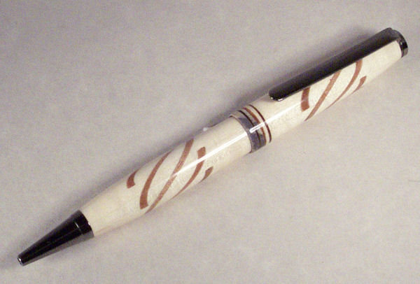

There are some maples that are very white also. Got some from my son's tree last year, I was surprised how white it was. Here's an example.
