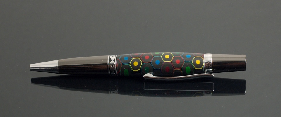

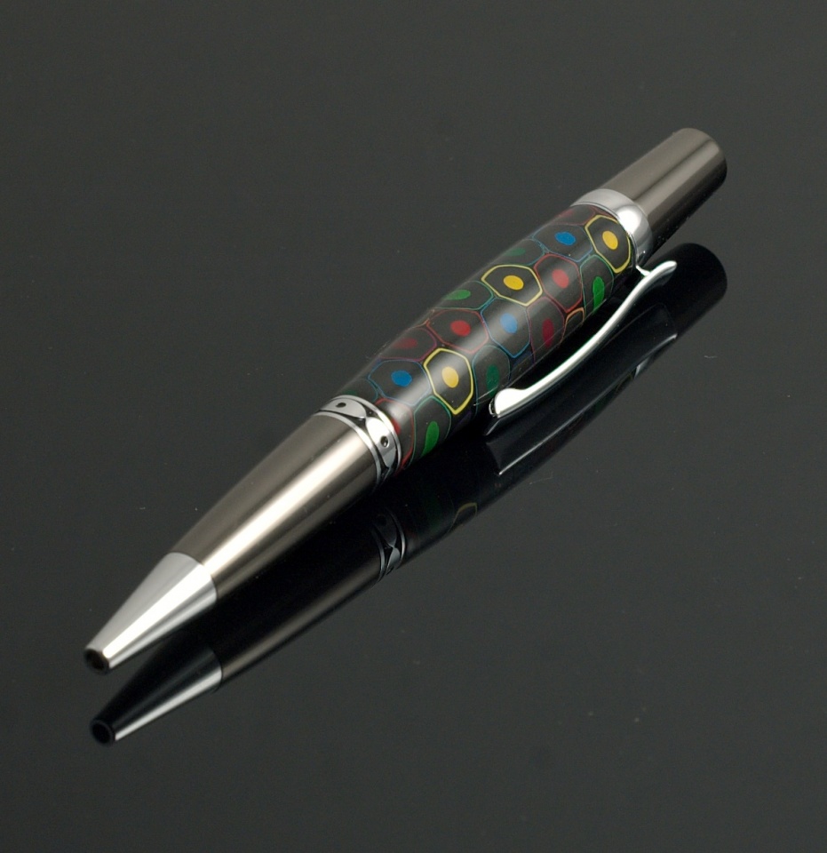

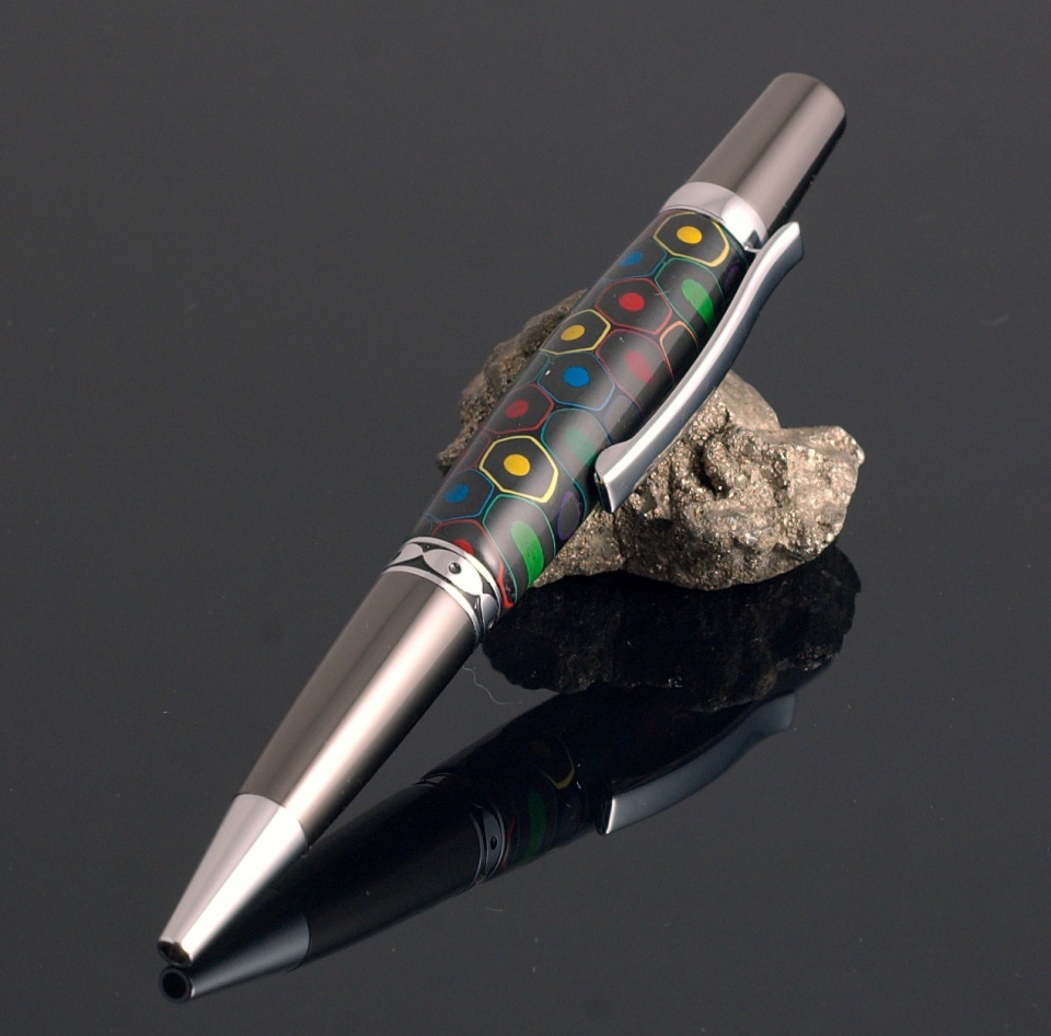

Okay, that looks easy. Everyone is doing colored pencils. Just glue some together, drill, glue, turn. Right?...
That was one of those "I had to do it once, but never again" projects. Heck, I still have second 2" Sierra blank, might never turn it.
Glueing... That was fun! (not)
Blowouts on drilling... Easy fix - just glue two pieces together, redrill. Repeat until succeed.
But turning, oh my. No matter what I did, what tools used, how sharp they were - pencils just flew off. The only thing that worked - grinding with a Dremel on a lathe. Half a year to finish that project:)

But, seriously, how did you get the black color both in the wood of the pencils and in the matrix of glue around them ????
Great pen. Really like the black. But I had the same question. How did you get the black in the pencil and glue?
Best colored pencil I have seen. Have several teacher friends that would really like one.
You get an A+ for both your pen and your perseverance !!!!!
Black pencils. They are made of some polymer shmoo (not wood, or may be some wood dust mixed in). When I saw them I was super happy - looks way more cool then regular colored pencils. And dark matrix of glue was epoxy with mixed in black dye. And gluing it was not fun:)
Main problem is epoxy is not holding pencils for some reason. May be it doesn't stick to paint, may be I've should wash them with acetone prior to gluing, and sandpaper would definitely help, so don't skip this step if you try it by yourself.
And yeah, leads also want to go away when they become exposed on a side. So really, it's almost unturnable with normal tools.
Actually, I've first seen idea of grinding pen away after reading post by George (robutacion) several years ago, where he shows how to "turn" a pen barrel from styrofoam. But I'm using small dremel with sanding barrel, much more controllable.
Here's that thread
