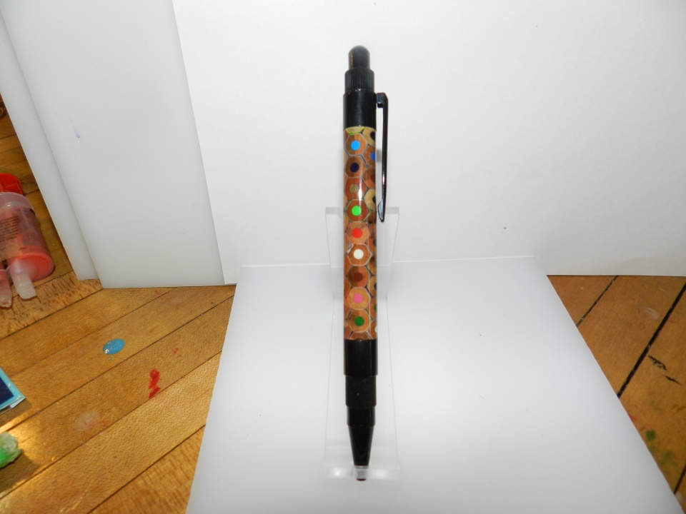

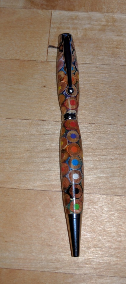

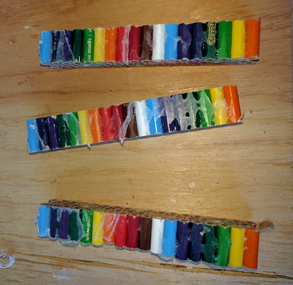

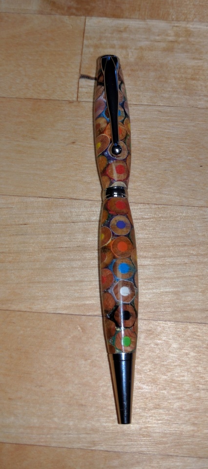

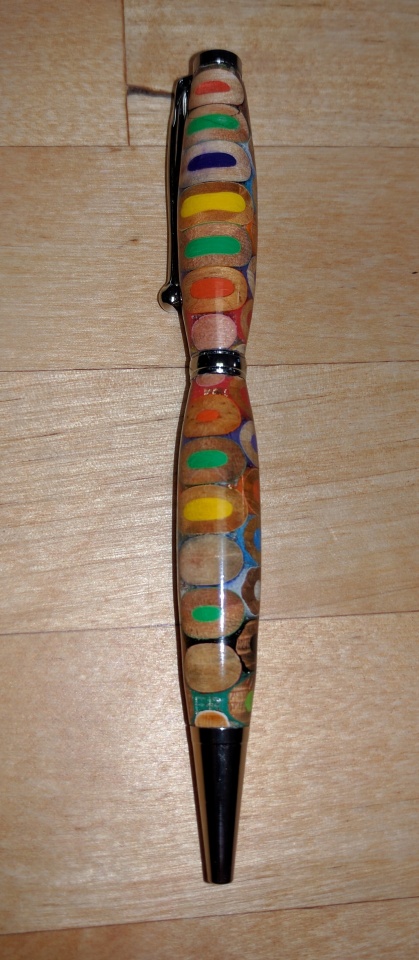

So, I have attempted two colored pencil pens, with varying levels of success on each. Has anyone made pens (or anything else) from colored pencils? I can turn them fine if I go slow and am careful, but sanding is where I run into trouble. The "lead" in them turns to a fine dust--like graphite, but I don't think they are graphite--and just grinds into the end grain, which is impossible to get out. These turned out "OK" but have some dark spots from the "lead".
I just got some cheap pencils from the dollar store, which I have heard may work. I hope to find out tomorrow.

The two pen pictures you show look pretty good to me !!!!
Other members have successfully done what you are trying to do, but you'll have to do a search because I don't remember the link to the pictures they posted.
You're right ... the colored "leads" are not graphite. . It would be best if you can avoid sanding by using a very sharp skew chisel for your final stage of turning. . But if you have to sand, perhaps you could do so in the presence of a strong "wind" of compressed air.

Joe, I have turned 50 plus items with colored pencils, the one thing i have found is you can not sand them. the color is not just graphite it contains wax also. I turn everything just under size with both HSS and Carbide cutter depending on the piece. Most of the time I will drill to size, coat the inside with thin ca, dry and re drill to help seal the lead, I was having blow outs near completion with poor glue adhesion(epoxy), This has removed this problem. I also will turn a piece to 80% complete and set aside to cool before finish turning, I feel the creates less chance the ca will dissolve the color and smear it. I make my own blanks by casting in Alumilite.
Thank you, Craig. That is a huge help. The tip about drilling, coating, redriling sounds like exactly what I need. I have had a few blowouts almost exactly as you have described and that solution makes perfect sense.
Also, not sanding will be a challenge, but should be well worth it if I can get a smooth enough finish with just the tools. Can't wait to try more with these tips.

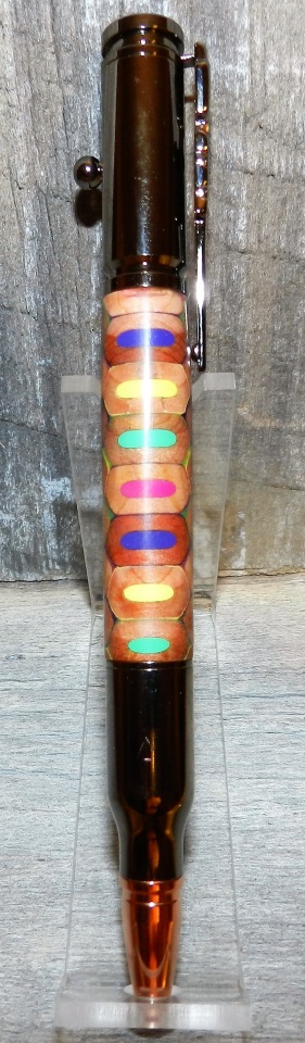

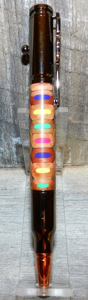

I've made several from the Crayola brand which are round and not sided. I also cast mine in alumilte at an angle and not "cross cut". It makes them a little easier to turn without blowing them up. I have broke a few but CA fixed that. I also use CA during the turning to help. I occasionally had to glue the lead back in the pencil. I put a white towel down on the lathe bed to catch them when they fell out. I sanded mine just fine and wiped them off with denatured alcohol before applying the CA finish. They cleaned up very easily.

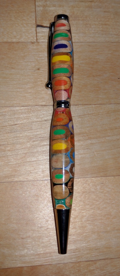

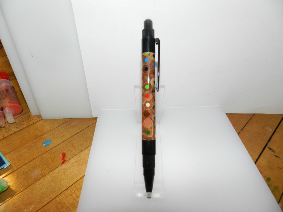

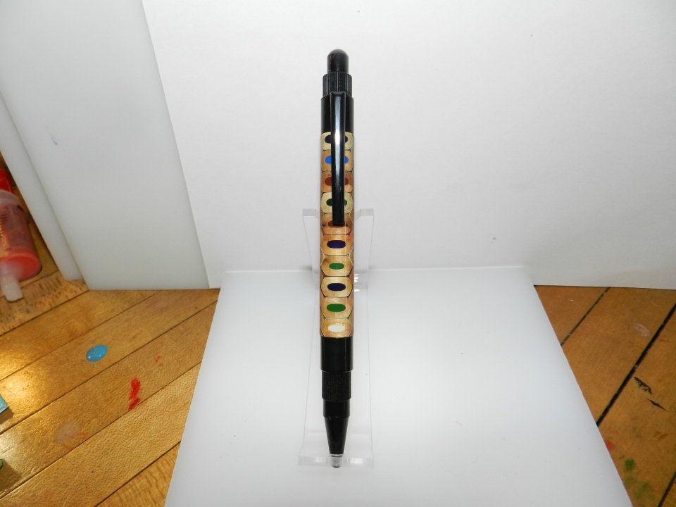

I also have made pencil pens/pencils. I glue them together with CA, lots of it! Then I turn a little off, then glue again, turn, glue until I get close to the bushings. Once I'm very close I glue again and sand. The pencils have to be saturated with CA the way I do it, so sanding doesn't ruin them.

John, that crosscut is awesome. I never thought of doing it that way.
