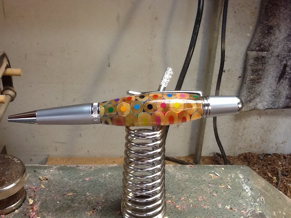

I glued a bunch of colored pencils together and this was the result.

I've thought about doing this since someone posted the pic of the ring they made a few weeks ago. We have 3 elementary school aged kids, so we have LOTS of half used colored pencils!

It is too pretty, and deserves to have a happier life. Can you turn a bit more off the Blank?

I tried to make one of the blanks from colored pencils and it is not as easy as it looks. I found that the lead slips out of the pencils very easily once you've cut them to size and the soft wood of the pencils tends to chips away very easily. All that's to say, nice job!
Jim Smith
I seen a member make a few of these a few years ago. They are very eye catching and not as easy to make as they look. I just finished, three days ago, making 7 of them for my son's teachers and like stated above, the colored lead likes to fly out while turning. I cast mine in alumilite but I'm wondering if they would work better if stabilized in cactus juice after being cast.
Here's the one from 2010...http://www.penturners.org/forum/f13/few-special-casts-61888/
