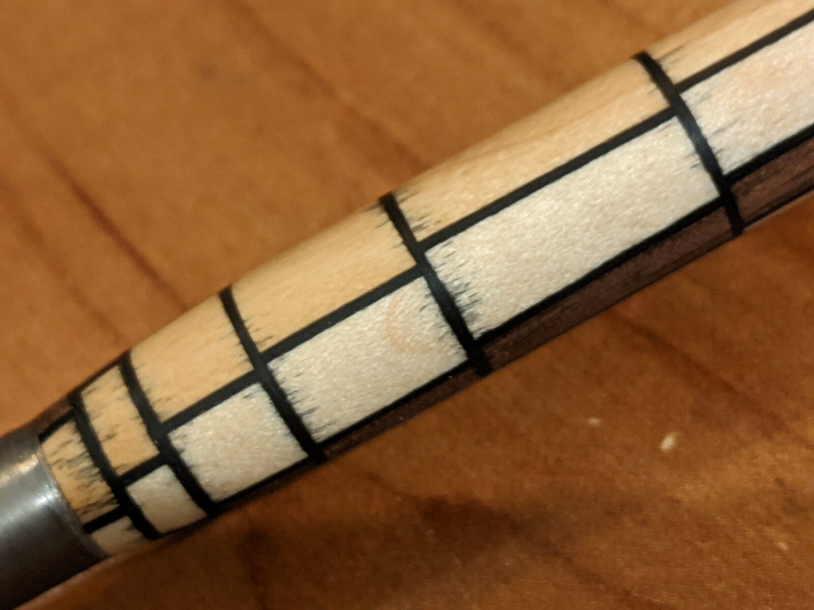

I'd like to be able to use pigmented epoxy in wood blanks - whether it's for assembling brick-y segments like this one:
(which in retrospect looks like it may not have needed it, but I wasn't confident that my cheap bandsaw was making the perfectly flush cuts required, and I didn't want to expose gaps full of clear epoxy around the black veneer)

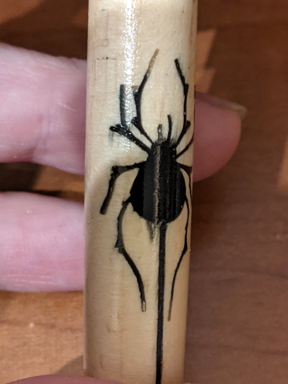

...or Jim Boyd-style spider pens like this, which relies on a pigmented epoxy "inlay":
The problem, as the pictures illustrate, is that the color tends to bleed into the grain of the wood in a most unsightly manner. I finally broke down and started stabilizing the holly/maple for the spider pens in advance (which works, although it's no fun to scroll saw), but stabilizing a handful of blanks is a little different from stabilizing a stack of sheet stock, so I was wondering if maybe there was some workaround I'd overlooked when segmenting. Well, aside from "throw it out if the cuts weren't perfect", which is my alternative go-to.

Yes sealing the woods with CA should work well. In the first segmented blank there should be no need to use colored epoxy. I would use a clear Light woods can become contaminated as you see.

I've had very uneven results with maple. Sometimes it doesn't bleed at all. Other times - like that segmented blank (which is maple, cherry, and walnut) - it bleeds like crazy. To be fair, though, the maple I used this time around was lousy - very loose-grained, fibrous, and, for lack of a better word, fuzzy. It didn't finish particularly well either. It was some leftover 1/4" stock that I'd picked up for CNC work, that turned out to be too cupped to be useful (apparently the entire batch was bad - they refunded the whole order, leaving me to figure out some way to make use of it).

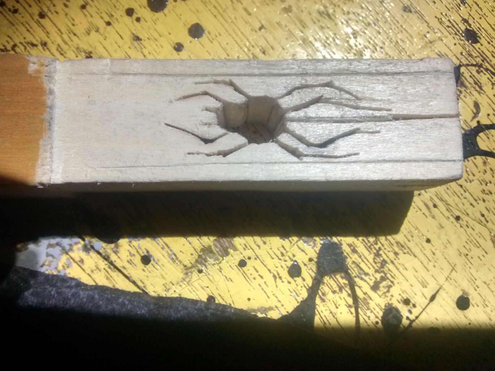

The spider's legs are cut with the finest scroll saw blade I could find - probably not much more than .025" thick, by the full thickness of a blank (the drawback to stabilized blanks here is they're tough to cut - and tougher still to cut without unsightly burning of the resin). Usually I have to use a fairly low viscosity epoxy with a vibrating table (read: clamp the sucker to the scroll saw & let 'er rip), and even then I end up with areas it didn't reach. Is there any way to thin poly clay way down? Or I wonder how it would react if I stuck it in a pressure pot and cranked it up to 120psi?

Now that I see how you cut the spider shape, poly definitely won't work. Oh well, was just a random thought. Once it's turned, thought you might be able to push it in using a rolling pin type action.

I will tell you I have used epoxy glues and tinted with epoxy tints which are rather thick. Never use tints like dyes such as transtint or wood dyes. I have tinted 5 min epoxy as well as system3 t88 24 hour epoxy and never had any bleed through because it is thick.

I think we (or, let's be honest, *I*) might be getting a little hung up on the specific use case, though. While I hope to make a few more come Halloween, the spider pens aren't something I'm currently working on (and I've managed work around the issue by stabilizing the wood first, even if that creates its own headaches) - they were just a good example (and one I had a plenty of pictures of) of one of the situations where I've regularly run into trouble with bleeding pigments. What I was really hoping to get at was whether this sort of bleeding (in various circumstances) was something other people had dealt with, and if generally applicable (or frequently applicable - the only thing that works in 100% of cases is an over-broad generalization) solutions had been found. Sealing flat pieces with CA is a great idea I'm looking forward to trying out, but of limited use for inlays. Stabilization works, but causes difficulties in cutting. Using only very dense-grained woods is probably another option, but also limiting (not that I'm likely to be trying inlays in poplar, pine, or balsa).
