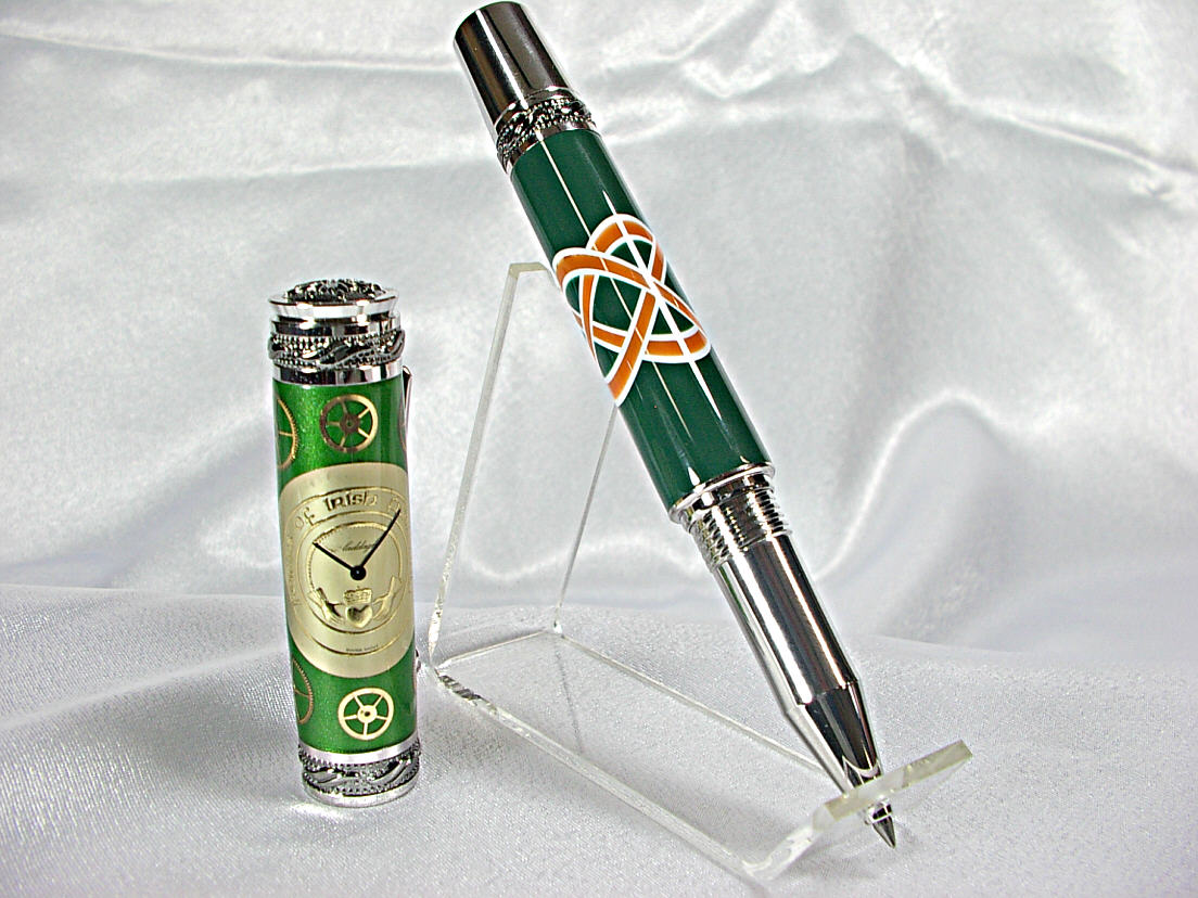

You will never duplicate those colors on wood. But if you want dyes it will have to be wood dyes such as Trans tint dyes which are pretty intense but the color orange will be a muddy color. The only way to get true colors like that is use plastics. I was looking to do the colors of the flag when I did this Irish Claddagh pen years ago. You would get closer to colors with opaque paints on wood. good luck. Another thought, I used Rit dyes years ago with DNA as the mix and not water to prevent wood grain raise. You can get some great coloring with that.

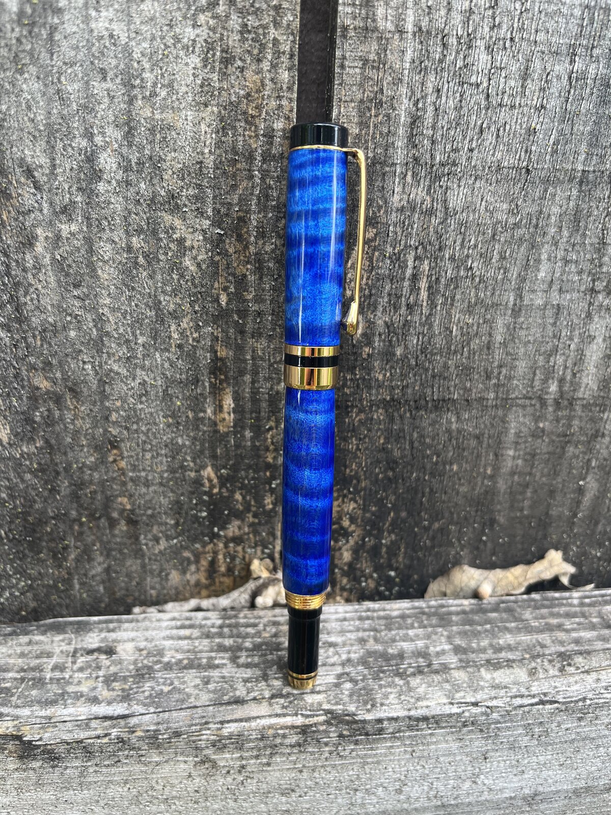

I use alcohol inks on occasion. I bought a cheap variety set off of Amazon.
I love how it makes the curly pop!
Do you turn down first, then color, then finish sand and add finish?
Would you mind sharing a link to the product?

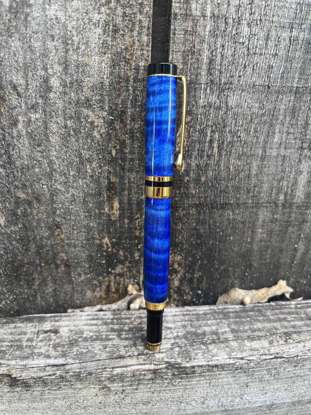

I turn and sand to final dimensions then wipe on the alcohol ink with the lathe off. It dries pretty quick but I usually hold off on applying my CA finish until the next day just to be safe.
