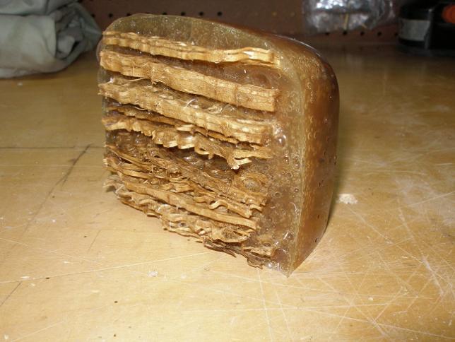

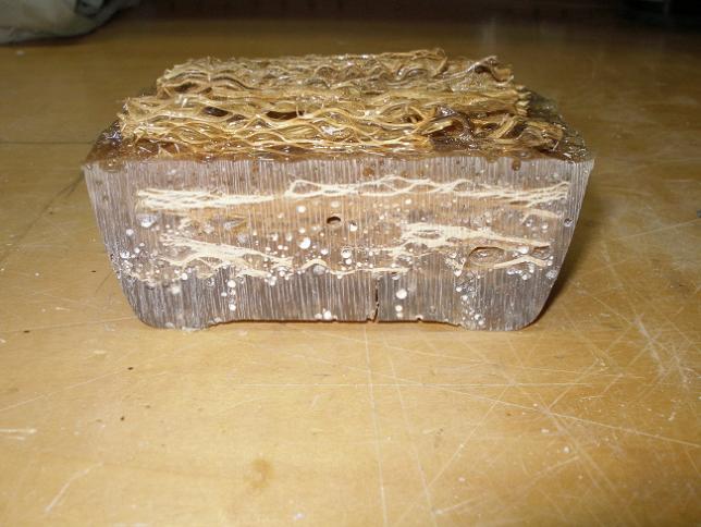

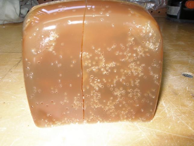

Boy did I screw this one up. I have to do some research, but all indicators point to this being the completely wrong type of resin.
**It was smokey when mixed,
**It dried within 2 hours,
**It is flexible like stiff rubber,
**It cracked across the bottom of the cast,
**with 30 minutes of vacuum and 2 hours of pressure it is still filled with air bubbles,
That was a good lesson learned on that one. "Buy the right s_ _t!"
I put in some photos bellow, I know some of you will want to see how bad this one went wrong,
this is the stuff I bought at Wallyworld,
<br />
these next three are the block I cast. I cut one end off to get a better look inside. That is cactus impregnated in it, luckily I have a lot more.
<br />
<br />
<br />
OK, now lets hear it folks, I deserve it for being in a hurry and worrying to much about a couple of bucks. Now it cost me a 10 and a half dollar can of resin.

And you thought this is easy? (it really is once you get a few right) All PR resin has styrene whether for fiberglass or pens. That's actually the part that stinks. You need the styrene to make it pourable. For fiberglass shops, they even sell styrene by itself to add as a thinner.
I would try at least one pour without cactus and make sure that is not causing the bubbles. Could be it isn't dry. As long as you have the resin, I would keep trying with it. 2 hours isn't much time to cure.

Bruce R. Actually I did cast a piece with some old dry wood in it. Had an ounce or so left in the measuring cup so I poured it in a little plastic container. Lot of bubbles, not as many, but way to many. Also the resin still hasn't fully hardened. It is still kinda soft. I can stick a screw driver right into it. Wrong smell too. I'll get the right resin and it'll all be ok.

One thing to keep in mind is that you want to switch from vacuum to pressure while the resin is still liquid. Vacuum will cause the air bubbles to increase in size, hopefully to the point that they float out and/or pop. But if not, you don't want them being held artificially big while the resin sets. Then the pressure does nothing for you.
I would vacuum it once or twice (vacuum/release/vacuum) in a five minute period (for normal casting resin) and then switch to pressure to reduce the size of the bubbles as much as possible before the resin starts jelling. If you use Alumilite you have to do all that in less than a minute because you only have 3 minutes until it jells and 10 until it is done. (Or something fast like that. I haven't used it yet due to fear of being too slow (plus there is no place close to get it.))

I believe that is exactly what happened. It set so quickly, it suspended the bubbles in the resin. It was setting up after less then 15 minutes and set firm in somewhere around 30 minutes. I pulled vac for 20, then went to pressure. I was way too late.
Like I said earlier, this is the "wrong" product. It is still spongy. Like a hard rubber ball. It apeares to be a resin used for repairs around the house or garage.
I'm not going to waist any more time with it. I'll pick up some "Castin'crafts", clear casting resin Monday and do it right.
