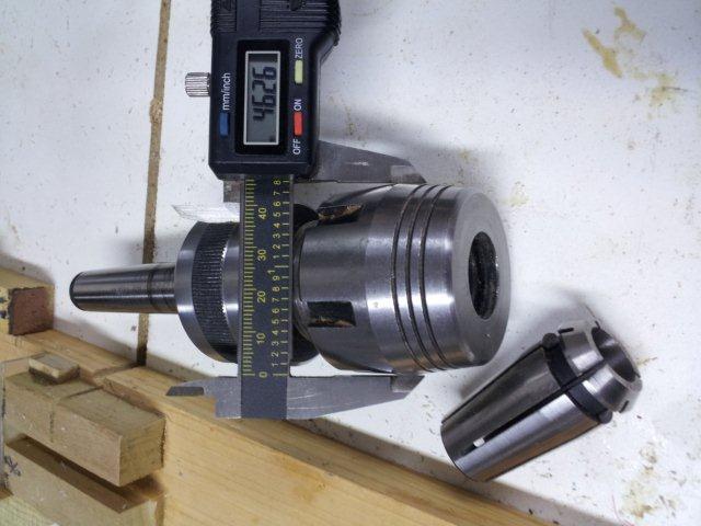

Ok here is my collet with the dimension of the nut. I measured the collet and it is 24 MM. When I look at the chart it does not seem to match up. Is that why this was so inexpensive is because it is an off size?

That looks like the set woodcraft sales , comes in a gray molded plastic box with a spanner wrench. if so, i think there captive to woodcraft and i dont know if they offer other sizes.
That doesn't look like an ER collet to me, I don't have any idea as to what it could be. One thing we do know, your holder won't go any bigger so if you want larger collets I believe you're going to need a new one. I recommend a Beall or a Beall "type", one that SCREWS onto your lathe so you can hold longer pieces.

Yup --looks like a non-ER collet, and the fixture is not likely (but possible) going to let you get much larger in diameter.
