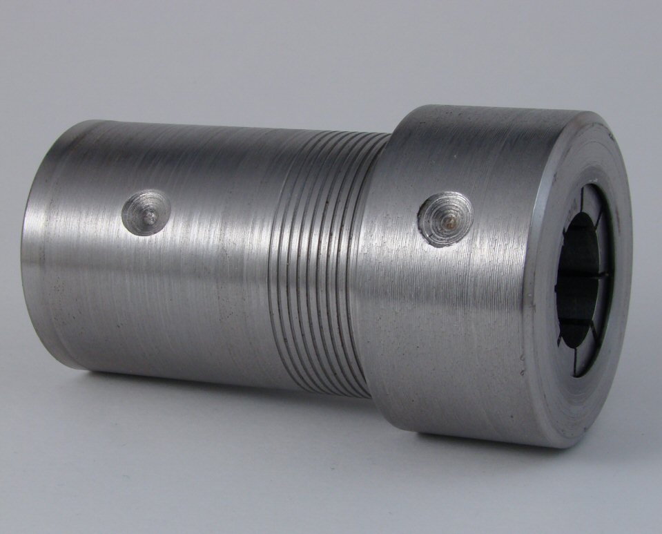

Someone posted here (a while back) showing that he had used his metal lathe to turn away the knurl on his PSI chuck.
You have a good memory Steve!
That was me, and here is the "After" picture of it. Still works great.
If I had to do over again, I would not have bought the large PSI one to begin with, but now I am quite happy with it and I don't grind my knuckles any more.
