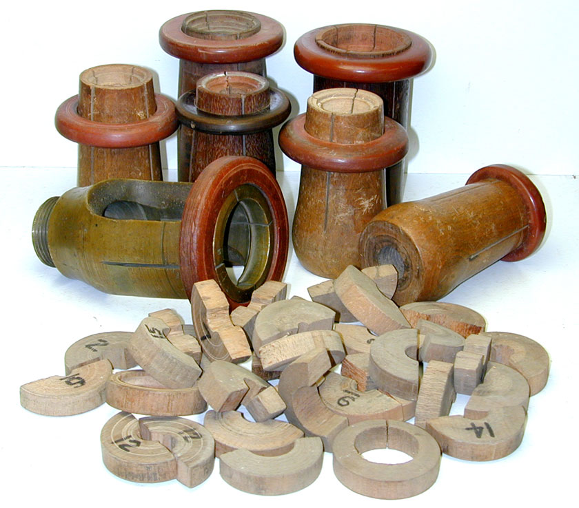

I am looking more and more at maybe going with a collet chuck but to date have not liked any of the commercial ones that I have seen. Now if they looked like this set then I would switch immediately.
attachment.php
