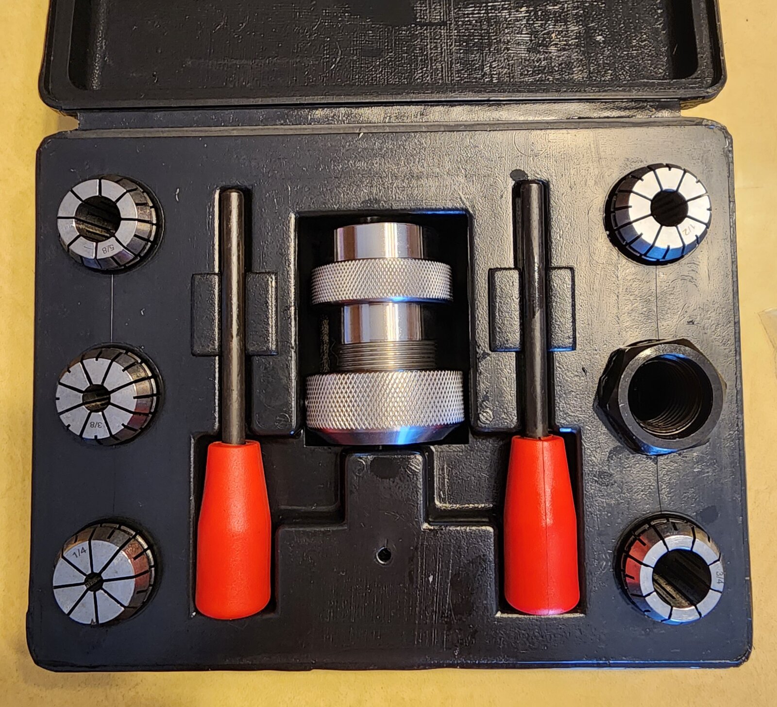

I went ahead and bought the craft supplies collet set. I mainly needed it for my duck call mandrel that has a 3/8" smooth shaft on it. My drill chuck wasn't able to hold it steady enough. The mandrel actually flew off once. Lol No damage done. All the beale sets I looked at were at least $170. Little too expensive for what I'm needing the set for. The CS set is supposed to be knurled for tightening but pretty sure it comes with a tool also for tightening. It should be coming in tomorrow.
Well it looks like a pretty decent set. Each part was in it's own lubricated wrapping. Will hopefully try it out next week.
