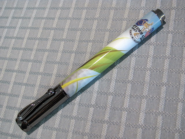

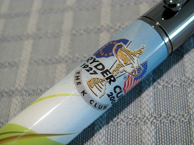

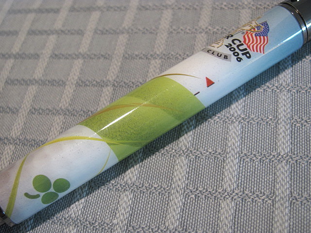

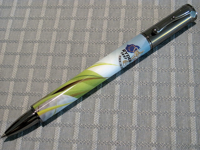

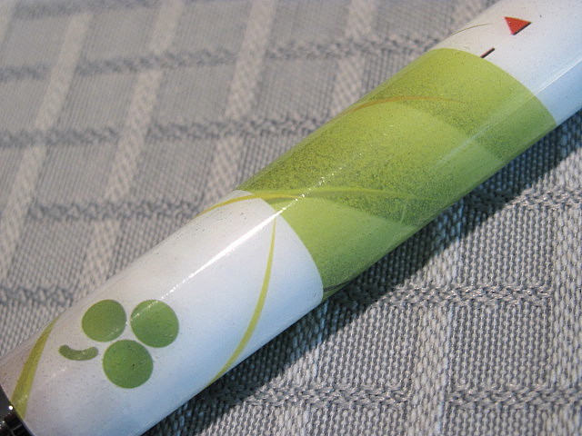

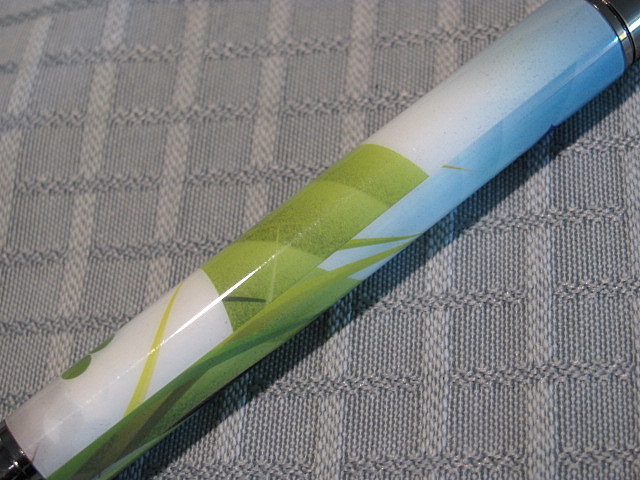

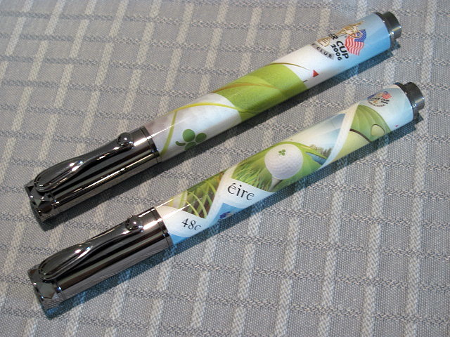

When you get the 4-stamp set of Irish stamps that celebrate the Ryder Cup,they come on this collector sheet,that is like 1 giant stamp.It's almost an exact fit for a Zen pen,so I thought it would be fun to try to make a neat pen out of it.( I hate to waste anything! )
So here's some close up pics,plus the last one shows it along side the one I did earlier using the Ryder Cup stamps.
It's another one done decoupage-style with ca.
I'm hoping these will appeal to the golf fans out there someday.
Thanks for lookin'!

Got a couple of questions. Do you undercut a wooden blank below the bushings so you have room to build it back up? Or paint and glue directly to the tube and have to build it up alot?
I'm playing with stamps and on the learning curve. I've been simply cutting up a broomstick (blanks = .30/each!), and undercutting them; still building it up too far though.

Hi Mark,
On the straight profile blanks like this Zen,I've been turning the blank down to about .470,then a quick ca finish,then spray painting it satin white.I use the Mod Podge to both glue them on,then 2 coats to seal.With the overlap,it ends up about .489''.Then I do the ca coats til it's around .520 '' or so,then skew it down to .513'',then sand and polish to the .511'' spec.
With doing it to those measurements,I have not had any accidents where a border gets snagged,and you can't feel any seam with your eyes closed.
Your broomstick blanks sound like a great way to learn.I hope that if you find a better way,you can post the tips.

Great discription of your process. Thanks for all the detail. Those are two nice pens.:smile::smile:
