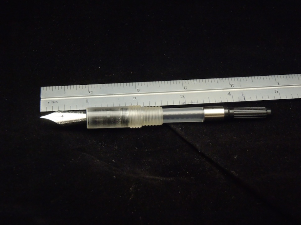

If the threads are forward on the section instead of the barrel then you can get away with a 12mm thread for the cap, otherwise the 13 or 14 is the one to chose. I'll attach a picture of a plexi "work out the details" section. It was for the first Collaboration Swap and was for a #6 Bock nib.

BSea
Dec 28, 2009
4,628
Little Rock, Arkansas
attachment.php
OOOPS, I had the threads reversed in how I was looking at it in my head. :hypnotized: Easy to do (at least for me) when working on a kitless pen.
Your way would work just fine. . . . . . . . . . Sorry Mike.
