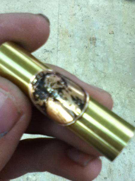

After a bit of trial and error, I finially found a way to thin and bend coins that will be useful after a bit of practice. My only roadblock is the burnt black stuff left on the coin after being thinned. I tried a crude method of buffing (I'm a total amateur at buffing and don't have a decent buffing system yet) and it got some of it off, but began to wear down the details of the coin. Any ideas on how to deal with this? The coin pictured is a copper 1981 penny from my pocket, I didn't pay attention to how it was oriented, I just bent it.
How about a pickle solution to remove the CuO like used when annealing copper when making jewelry? Either a home made saturated solution of salt and vinegar that is warmed or a purchased pickle from a jewelry making supply company. If the black is from annealing the coin then a pickle should remove it.
I'm curious to how you thined the coin. I use a dremel tool and do it all by hand therefore I can go a slow speed and stop when it gets too hot. I have only done quarters and one dime so cleaning them up was easy with the dremel. I also collect coins and a friend of mine had some acid and we dipped a penny and it cleaned it up but also turned it pink. Didn't like that at all so try that on a coin before doing any other work to it. Good luck.
I used a belt sander, a penny will fit snugly into a 3/4" indent in scrap wood made by a fornster bit. Still looking into doing the same thing with nickels. How does the Dremel work? I tried it with one of the grinding stones and it seemed like it would take days to do.
I use a spray bottle of water to keep the coin cool. Go slow, keep the coin cool and there will be no black stuff to remove (other than the normal grime).

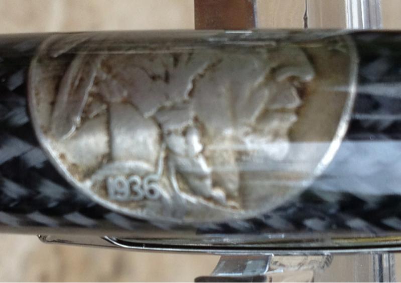

Here is a buffalo that I did last weekend. I left the patina on it, very little cleaning was done on it.
I use the abrasive disc with the dremel tool not the grinding stones. When you get to the copper layer it will clog the stone. Like I said earlier I've only done quarters, clad coins not silver. That way I know to stop when I get to the outer layer of silver. When I first see the silver I take two sided tape and tape the coin to my finger a slowly sand until I get a smooth even finish. Don't sand too fast because it still gets hot and imagine that taped to your finger. It will leave a mark. I can do the Texas map and star start to finish in about 30 min. If I do the whole quarter it takes 3 hours including the scroll saw work.

Is there even a way to do it from the front? The grime appears after thinning the coin from the back.
Coke sounds like an easy way to loosen up the grime, I'll give it a shot!

The acid in the coke removes the tarnish really well, would be interesting to see how well it works for the baked on crude you've got. Maybe and initial cleaning before sanding down would help too.
You need to be aware that the composition of coins have changed over the years. For instance, since 1982, the penny is copper-plated zinc (97.5 percent zinc and 2.5 percent copper). So the technique that worked on a penny in your pocket, probably will not work on your granddad's penny.

Got out to the shop a tried it on a nickel, the Dremel worked out great for thinning, and I used a horsehair-like brush attachment to clean off the grime. Turned out good and I might get one castable on the next few try's!
Vinegar and salt will clean coins w/o any damage. Just do not mix any dollar coins, half dollar, quarters, dimes or nickels with post 82 pennies as they will take on a pinkish tint, then again some folks may too, like that look!..................Jan
