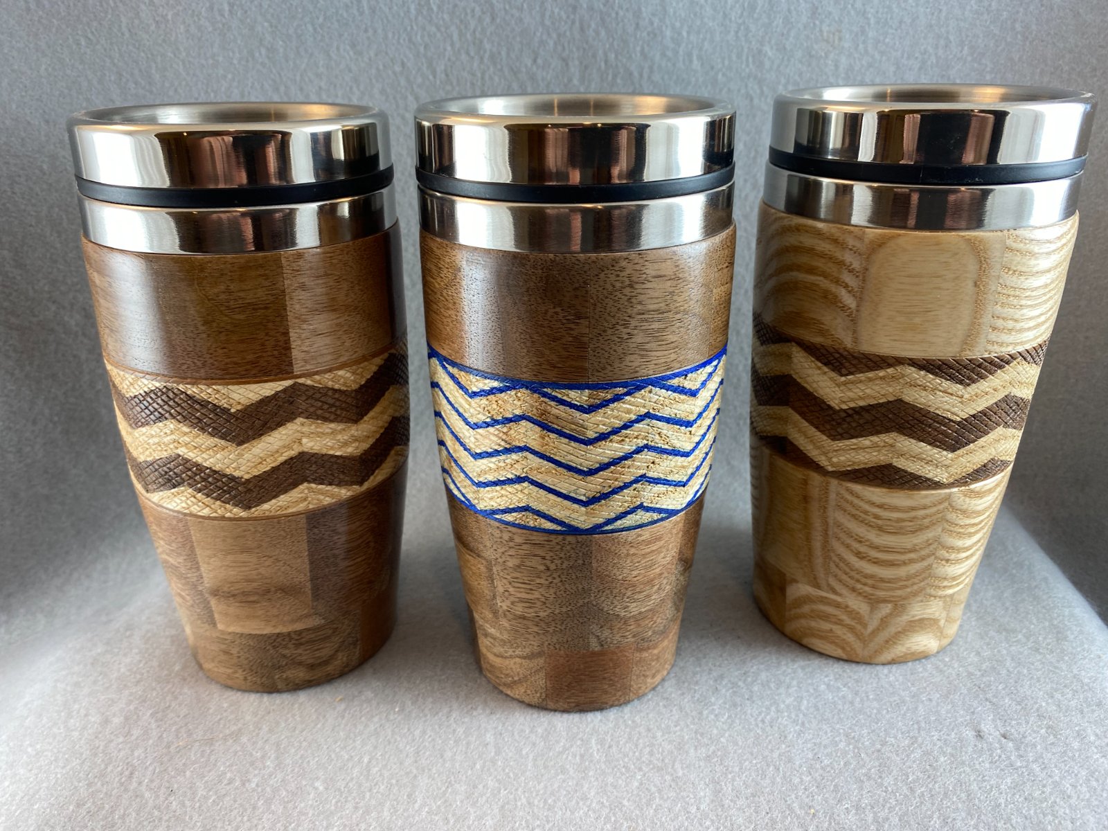

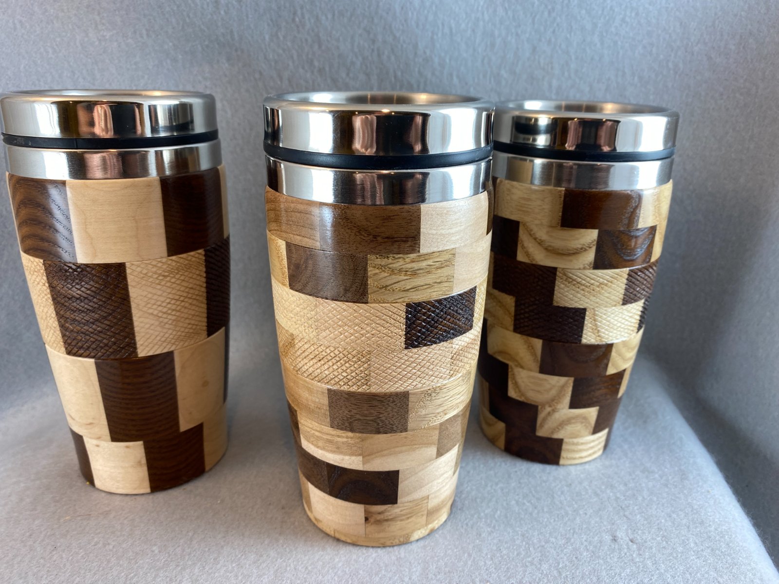

I've turned a lot of travel mugs over the years and found this design has worked out well.
I've never tried all wood but like others have said I think it would be a lot of maintenance.

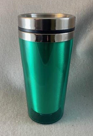

I've used some Woodcraft but I was buying stainless mugs with an outer plastic and removing the plastic.
They don't stock these anymore so I'm looking for a new source
Mike
You could always head to TJMaxx or HomeGoods and find something you like for cheap and then remove the plastic as @Mike8850 notes above...
