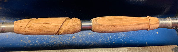

Using my router table, a 1/8"bit and a new spiral jig , I cut a "trench" and packed it with coffee and thin CA glue.
The new set of spiral jigs (blue) has a tighter spiral than the last version (gray).
Router bit positioned under the blank.
I'm using slimline kit center bands as spacers.
Moved onto the lathe.
I read several posts about some of you using coffee grounds as a space filler.
After assuring myself you weren't joking (I'm still on 98% sure) I decided to try it.
I never would have thought of this on my own... thanks to everyone who suggested it!!
The base is Bolivian Rosewood. I thought a wenge center band would work with the coffee.
Thanks for looking!

I would suggest trying a down-cut carbide spiral bit next time and it should eliminate the fuzzies and produce a very sharp edge.
The down cut bits are the second group. Down cut spiral bits - cut by forcing the dust downward away from the router, and most importantly cut the edges on a downward leaning edge, thereby making the edge smoother.
I love your ingenuity! Absolutely GREAT!
Hank- Thanks for the suggestion and link! I'm notoriously cheap but your recommendation carries weight and the bit has been ordered.
